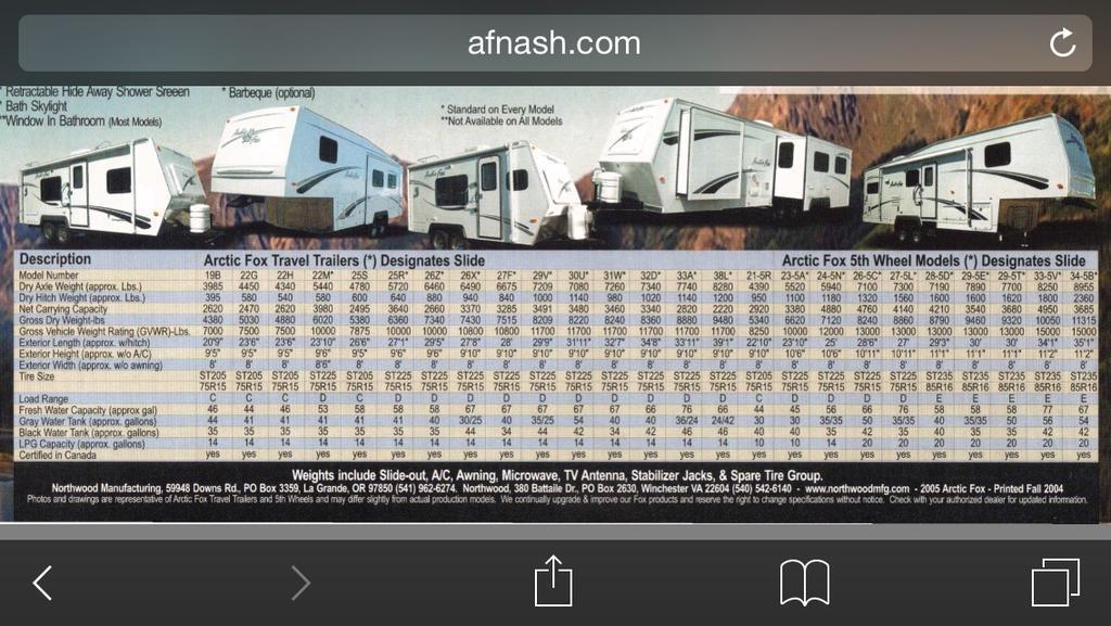

This is all I have at the moment and will have to contact Northwoods mfg. for that info. Mine, as in signature, is the 33.5v. It shows 235/85R16E load range. Sorry for the poor picture.
The math works out to 11,250 lbs after 25% pin weight is calculated, and is under the 12K axle weight at 3K per tire, if at 15K max GVWR.
Look at the placard on the left front corner of the trailer. It will list the GAWR. If that number is above 6,000 then LRE LT tires are out! You size tires to GAWR not the actual lower loaded weight! By law they have to meet or exceed the GAWR.
With a 15K GVWR and a 20 % average pin weight, that leaves 12,000 on the two axles. So given the year, my guess is that it has 6K axles, and these two steel ply carcass tires are the only two I would consider installing. Also if it does have 6K axles, it would be my bet that the rims are not rated for LRG (110 lbs inflation) tires, also based on the vintage of 2005.
