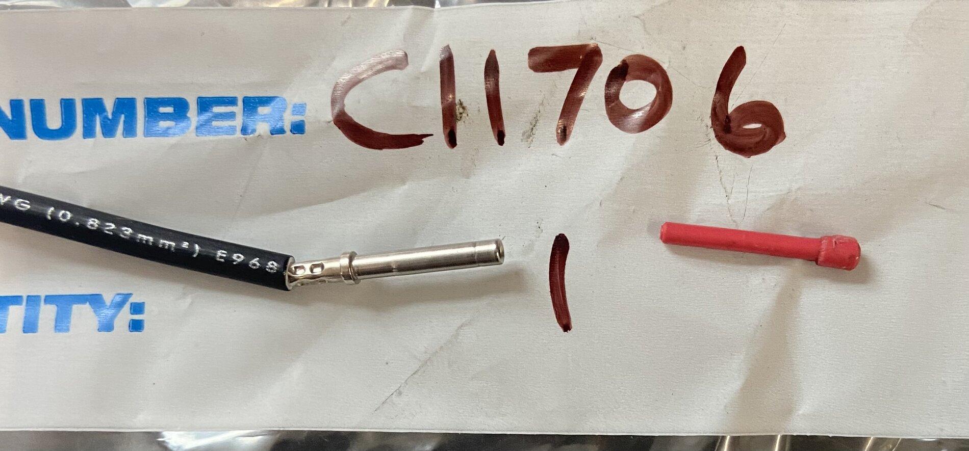

I am installing a PAC exhaust brake on a 2006 5.9 Dodge Ram can’t find the ECM pins they aren’t on the wires that
plug into the ECM plug can you buy them anywhere
I am in Australia so that could make it harder do Cummins sell them
I have a spare one at my shop. I’ll walk over there in a bit and get a picture of it. It’s not really a plug, but just a connector on the end of the wire that slides into the ECM.
This is for my 2000. If it’s different from a 3rd gen., someone will chime in. That is a PacBrake part number for a short length of wire and the connector. The red pin came out of the ECM.
If they didn't came with the wiring harness from PAC I'd high recommend to contact PAC and tell them. I'm pretty sure they'll send them out to you asap in an envelope.
