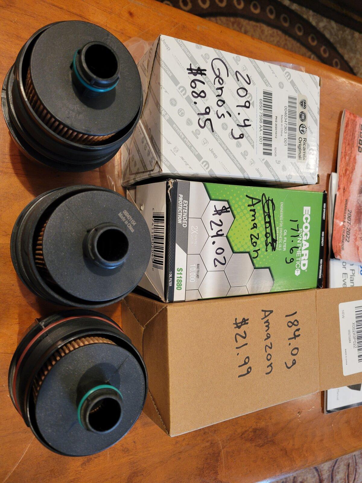

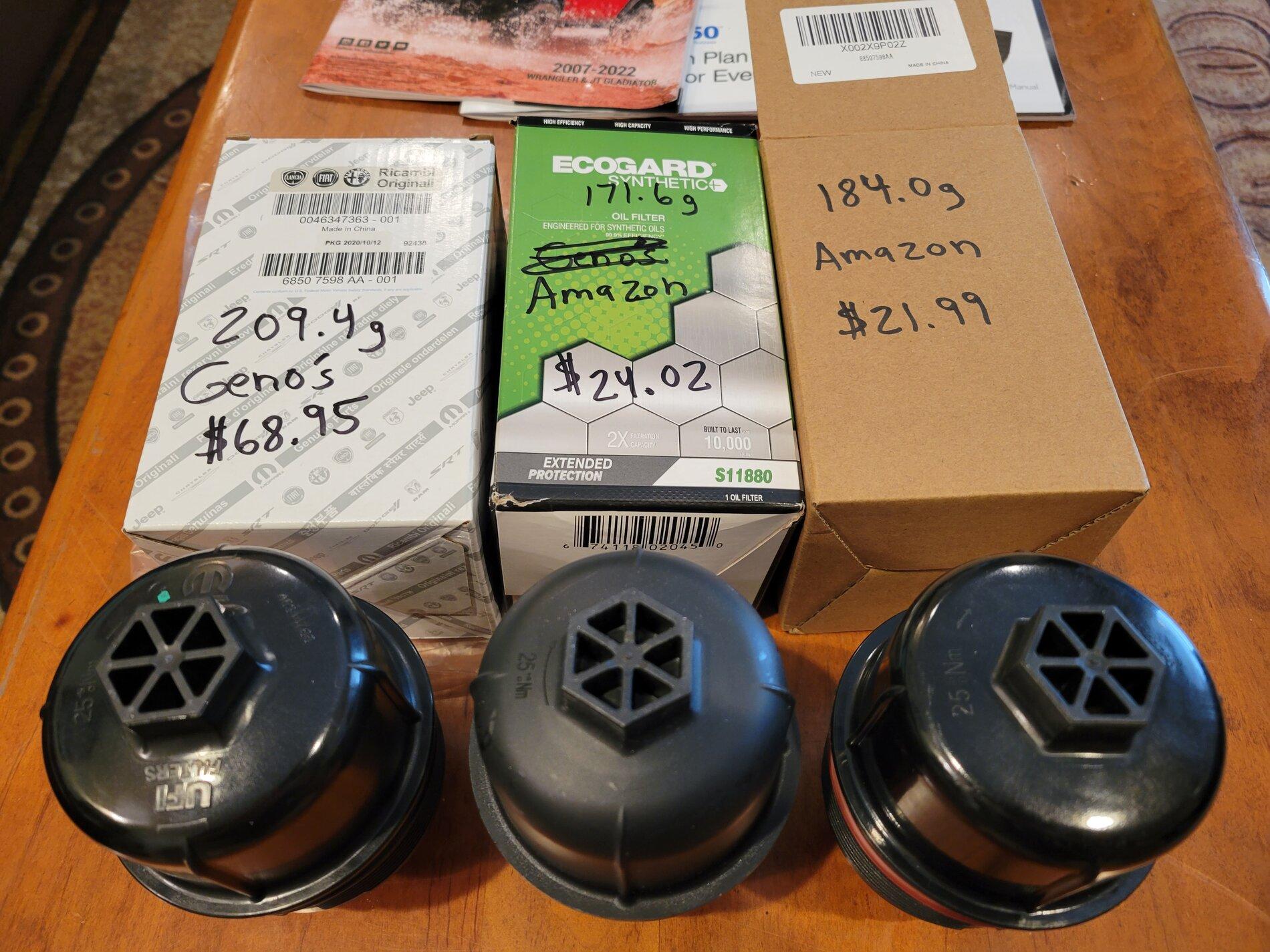

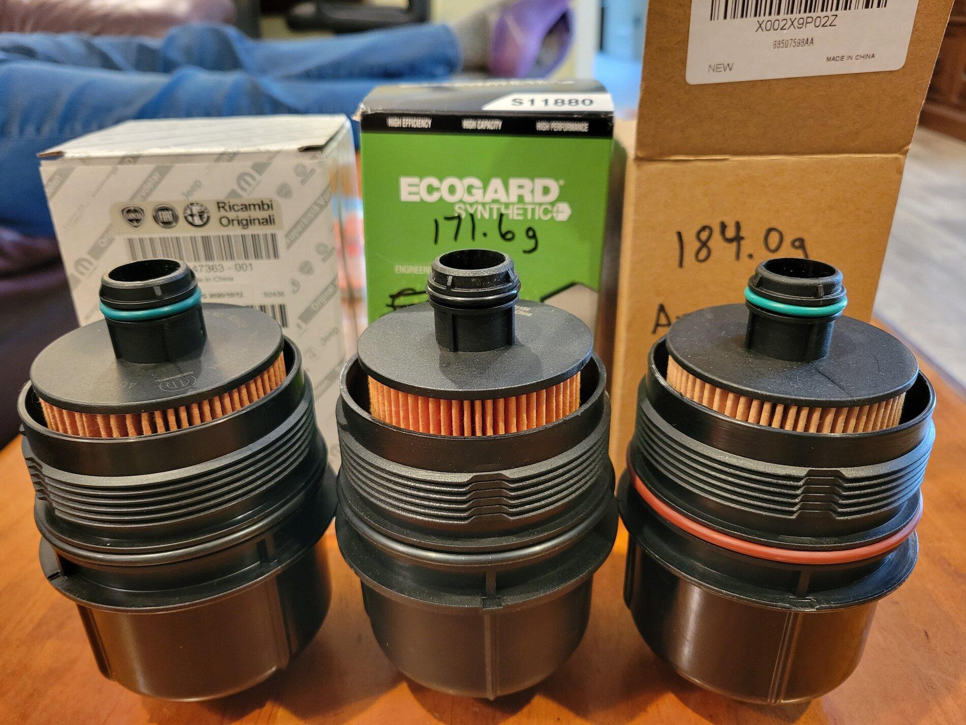

See images for comparison.
  1. I purchased probably the last Mopar? OEM filters from Geno's Garage.
    1. LH side, 209.4 grams, came in a plastic bag in the box, packaged nicely in heavy box and packaged even better by Geno's.
    2. $68.95 and they are on back order now.
    3. I did find Mopar on Dieselfiltersonline site for $46.75 and national backorder, waiting for email from them on availability, July 2022 at best.....
  2. Ecogard filter in the middle from Amazon, purchased with filter on RH side on same day.
    1. Lightest of the three at 171.6 grams and delivered separately with no plastic bag inside box, lighter box with damage to it and filter barely in it inside Amazon box.
    2. As a Plastics Molding engineer, this filter has different surface appearance and design is different.
    3. It has less filter in it
    4. Larger radii on dome of cap, so different CAD design, but either resin is not ever close, or molding with tooling too cold.
    5. I suspected less glass fiber in this Nylon 66 part based on weight of part, but based on the appearance alone I would have assumed more glass fiber which increases density of plastic.
    6. The reality check of part weight says less glass as I don't think they thinned up the part wall stock by the >18% weight decrease. I hope not.
  3. Third filter, no name from Amazon in brown box and also same issues with box lid being torn, and filter almost out of it with no bag inside the Amazon package, I think it came in just an Amazon envelope too.
    1. Heavier than Ecogard, still >12% lighter. Coming in at 184 grams.
    2. Visibly this is a very good copy of OEM. Same CAD design and surface finish on CAP, but filter molding looks a little less quality with more parting line mismatch on element molding.
    3. Amazon listing is from KASSEN and brand listed as Goopool. That's a name that build confidence!!!!!
I will stick with only the Mopar OEM filter for now. Use the Goopool filter in emergency trail fix if we still cannot get OEM filters, and maybe I can find someone to give away the Ecoguard filter to. Or maybe I can use all three for the same mileage, and compare dry weight on them after oil has drained out for a week or so?
