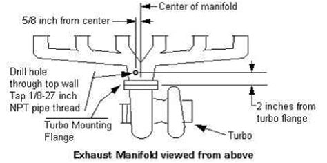

You could also drill through a shop vac nozzle to pull chips away and into the vac. I've got some pretty worn nozzles and have done this when drill block. Just another way to think about. Here's a diagram for location. Hope it helps.
Thank you Hoot for the thread, Topzide thank you for the picture and drill location as well as for the tap size needed.

Just make sure you don't tap too deep. Go in about 1/4" and check if the fitting will start. If not, tap a few more turns. Repeat until the fitting gets tight at about the same time it is in the thickness of the manifold wall. I don't like the threads protruding into the manifold cavity.
Also remember, it's a taper thread. So you don't need to go that deep as @Yo Hoot states for it to be good to go. Center punch lightly to keep drill bit where you want it. Have a sharp drill bit to help with the cast, which turns to powder at times when drilling. Oil or light grease on the tap to help with the cutting action as @Ozymandias states. Just take your time and all will go well with the install.
