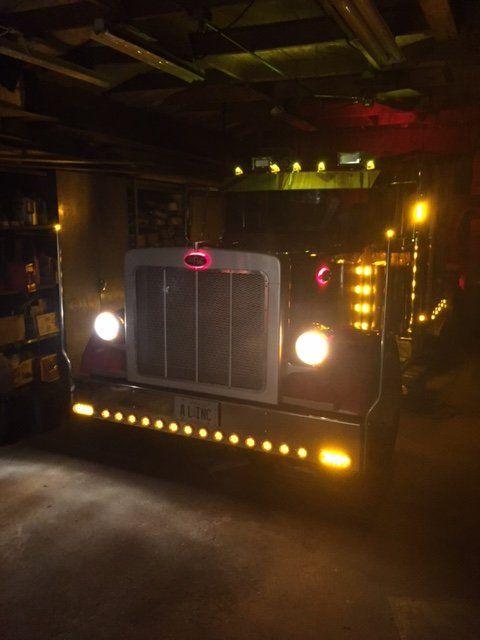

My electric woes------on my Lil Pete conversion
1) grn/blk to air heater relay dead
2) grn/blk to dash relay dead
3) grn/blk to "hold" of fuel solenoid dead
4) red/tan to dash relay dead
5) message center dead
6) fuses 13-14-15-16 dead
what I've tried
1) jump grn/blk fuel "hold" & message center works
2) jump both grn/blk & red/tan at relay while grounding any of the air heater small posts ----- air heater works
3) replaced both air heater relays
4) replaced both relays on firewall
5) eliminated fusible links to make sure I've got power
Any ideas ??
WAYNES WORLD
Sounds like a main relay is not coming on. Trace those power wires from those relays to the source.
EDankievitch
It seems that during my conversion the grn/blk that triggers the relay on the firewall, has a break somewhere. I replaced it with a switched hot wire & everything is now working. I'll look into that switch thought. That's why conversions are challenging.
