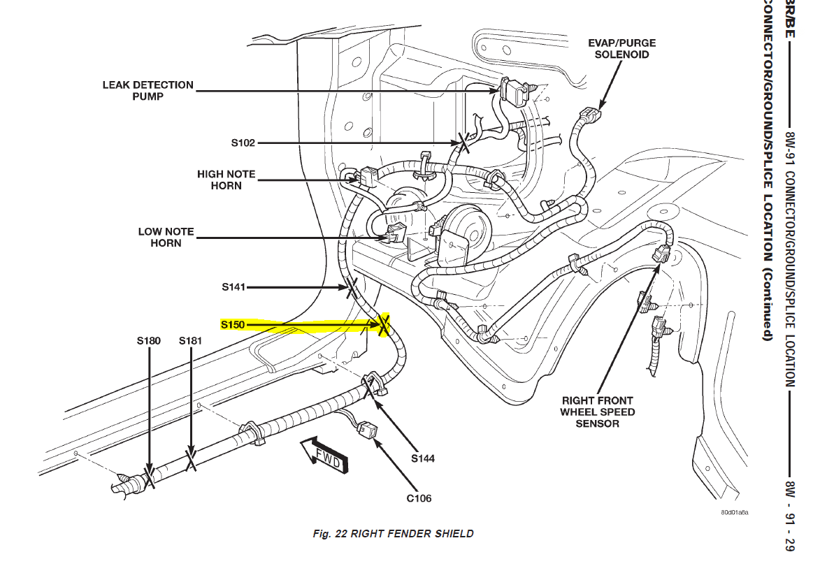

The indications you describe point somewhere around ground point G100 and splice S150. Most likely is G100 which is under the hood, on the left side, just left and aft of the washer bottle location. It is on a horizontal panel (frame?) with a nut securing the ground connectors to a protruding threaded stud.

Common/ground paths for the low/high note horns and the right front park/turn signal lamp, are each thru a Z1 18 BK wire, to splice S150, then out from S150 thru wire Z1 20 BK to ground G100. G100 has numerous ground circuits attached. The issue should be somewhere from ground G100 to splice S150.
If a wire has corroded under the insulation, or has sufficient broken conductors (strands), or some other mechanical defect it will not carry the designed load as previously mentioned by crabman and DavidC. A voltmeter or ohmmeter will indicate a potential or continuity, but will not allow sufficient electrons to flow through the compromised conductor(s). If you can place a jumper at a known good ground point and each one of the three loads' ground connector, you would provide a ground path bypassing the suspected defect.

Thanks again for all of you that responded. I am grateful for all the support I get from TDR. Tomorrow I am going to look at splice S150 to see if that is the culprit. Given the location of the splice leads me to believe the weather could have damaged it. I will keep you posted.
Before digging into the wiring harness too deeply try the ground jumper troubleshooting task first. No sense ripping apart something that could be perfectly good and potentially inject more problems. ;):)
