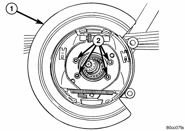

Crawl under the truck driver side along the frame you will see your emergency brake cable follow it down to where it Y's off there you can take the slack out of the cable
Do not adjust the cable till after you have adjusted the park brake shoes! The park brake warning light is another issue
ADJUSTMENT
NOTE: Tensioner adjustment is only necessary when the tensioner, or a cable has been replaced or disconnected for service. When adjustment is necessary, perform adjustment only as described in the following procedure. This is necessary to avoid faulty park brake operation.
Raise the vehicle.
Back off the cable tensioner adjusting nut to create slack in the cables.
Remove the rear wheel/tire assemblies. Then remove the brake rotors (Refer to 5 - BRAKES/HYDRAULIC/MECHANICAL/ROTORS - REMOVAL).
Verify the brakes are in good condition and operating properly.
Verify the park brake cables operate freely and are not binding, or seized.
Check the rear brake shoe adjustment with standard brake gauge (Refer to 5 - BRAKES/PARKING BRAKE/SHOES - ADJUSTMENTS).
Install the rotors (Refer to 5 - BRAKES/HYDRAULIC/MECHANICAL/ROTORS - INSTALLATION) and verify that the rotors rotate freely without drag.
Install the wheel/tire assemblies, (Refer to 22 - TIRES/WHEELS/WHEELS - STANDARD PROCEDURE).
Lower the vehicle enough for access to the park brake foot pedal. Then fully apply the park brakes.
NOTE: Leave park brakes applied until adjustment is complete.
Raise the vehicle again.
Mark the tensioner rod 6.35 mm (1/4 in.) from edge of the tensioner (Adjustment Mark).
Tighten the adjusting nut on the tensioner rod until the mark is no longer visible.
CAUTION: Do not loosen, or tighten the tensioner adjusting nut for any reason after completing adjustment.
Lower the vehicle until the rear wheels are 15-20 cm (6-8 in.) off the shop floor.
Release the park brake foot pedal and verify that rear wheels rotate freely without drag. Then lower the vehicle.
