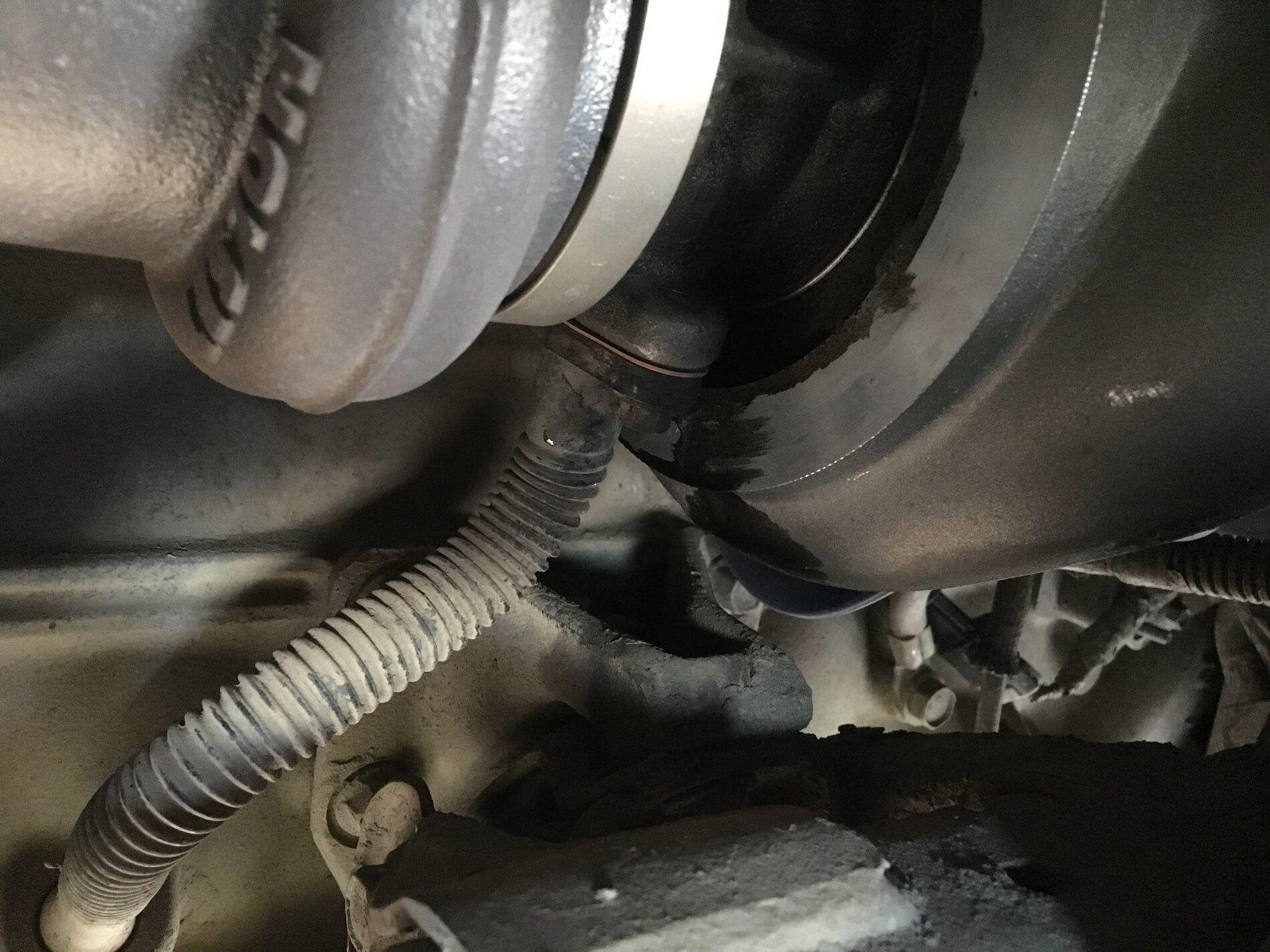

About 10'000 miles ago, we had our original turbo replaced. Now, not even 5'000 miles later, the new turbo (I just learned it was not a OEM part but from High tech Turbo, even if i wanted an original one) shows the same symptons with leaking some oil.
The mechanic (a known shop in the Portland area) now tells me that it is due to the Pacbrake that the problem is happening, and they don't want to do any warranty. But it was them that installed the pacbrake.

We got the Turbo replaced. After just 2 days of traveling the leaking of the brand new turbo started again. Contacted the shop again, but no help there. So since we had to cross the States (due to shipping date for our camper) we decided to continue our journey.
So: after replacing the original turbo - which held out more than 130'000 miles with travels in dusty deserts I think this is an ok value - and now two brand new ones which have an issue with leaking oil, I look for possible root causes. The people in Portland have no idea, and searching the internet brought a lot and nothing.
This is also why i'd like to ask you guys and all your swarm intelligence and experience:
How would you proceed to find the root cause?
I don't mind spending some money in a new catalyic converter (its still the first one) or replace the crank case ventilation, but it makes no sense to do all of these things without a basic plan and some experience what would be sensible to do.

Looking at their site it appears they sell genuine Holset and their own modified turbos. So what did they install, a direct stock new turbo or one of their modified turbos with stock Holset housings? It is hard to tell where the oil is coming from in the photo, but if it is from the compressor seal there should be oil in the intake also.
I was told the turbo was stock.
Regarding oil: I cannot see any other oil leak, and since we are still
Regrding plugged oil drain: I did not check myself, will do that once we are home. But the shop told me they checked drain as well as crank case breather (I hope I wrote that correctly), and both are supposed to be fine.

I would check, in no particular order:
-engine oil pressure with a manual gauge
-oil flow in the pressure line and free of blockage in the return line
-take the turbo apart and see where the leak is occurring exactly
-check to make sure the air filter is not blocked
-determine if the turbo is in fact new OEM or a DIY rebuild or a cheap chinese knock off
-test the back pressure after the turbo to check proper operation of the exhaust brake and for any restrictions with the EB fully open.
Your answer should be somewhere in there.
