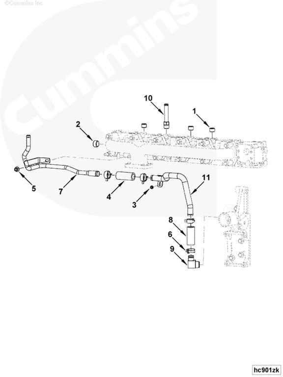

Here you are, is it #7 in the illustration??

I think that the exhaust manifold heat is the concern. You might be able to route it away. But that #4 chunk of hose is special stuff because of the heat.
You may want to try it after you see the price.....
Part # 3979048
Right around $150.00 from Cummins......
Check Mopar but it is probably even more money.......

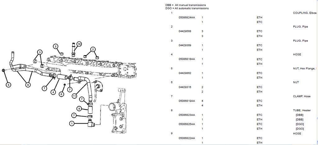

Mopar Part Number is 05086823AB. A lot cheaper from Mopar if what I am seeing on the net is for a current part....$36.00 to $50.00.
Check with your dealer if you have time to do so.
I think we batted this one around a couple of months ago and the Mopar one was cheaper which is not the usual case.

Thanks for your help and numbers. Had I seen the picture you posted, the job would already be done with a re-route. But in looking at the piece of pipe coming out from the block, I led myself to believe that the pipe entered the block at that point, thus the need to replace the pipe.
All my classic trucks are tucked away in the heated shop for the winter. I am stuck outside working on the Ram. I have roughly 16 hours per the weather report to work at temps in the mid 30's. Then the temps drop to zero and then 17 below on Wednesday. First thing in the morning, I am going under the truck measure the hose I need and a 90 degree fitting to turn the hose towards the fender, away from the manifold. If I hurry, I wont be to bad a job. No choice ha ha ha
Thanks for all your help........you saved me with the picture
