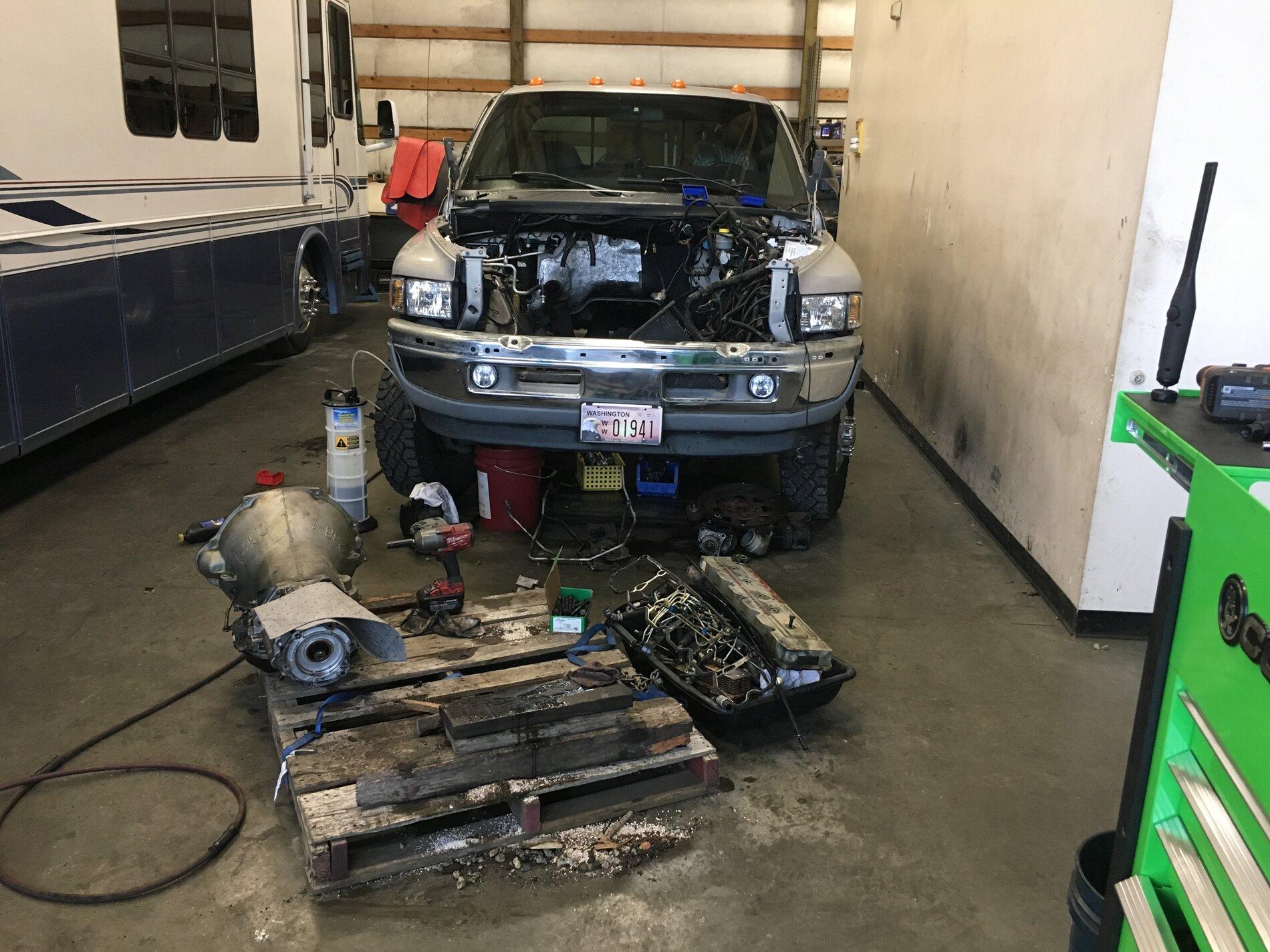

Your on the right track. Raise the truck , have the front wheels off the ground, uncouple trans (I was replacing trans) , remove exhaust manifold and all accessories. Remove hood, radiator, intercooler. Move trans and air coolers out of way. When removing engine rotate it to get it around frame. Or you can remove the oil pan. Lots of extra hands help a lot. IMG_3184.JPG
