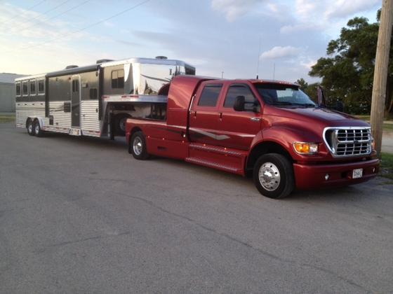

No, it is not a semi, but I do call it a baby Freightliner. I don't know how to post pictures. For what I do it is just the thing.
