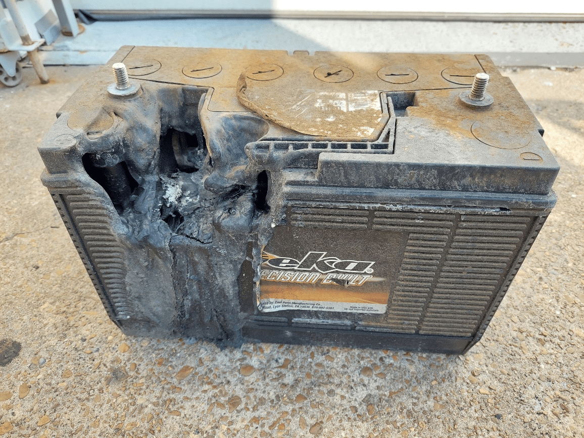

Ever wonder what happens when a battery shorts out to the mount bracket?

I don't know specifics, I'm sure something wasn't done properly when the batteries were installed, but this is what happens when the battery shifts and the hold down bracket contacts the positive post.
I imagine you're right, but I wouldn't know. One of our Service Truck drivers was called out for a no-start.
I am surprise there was not a fire under the hood of said vehicle!

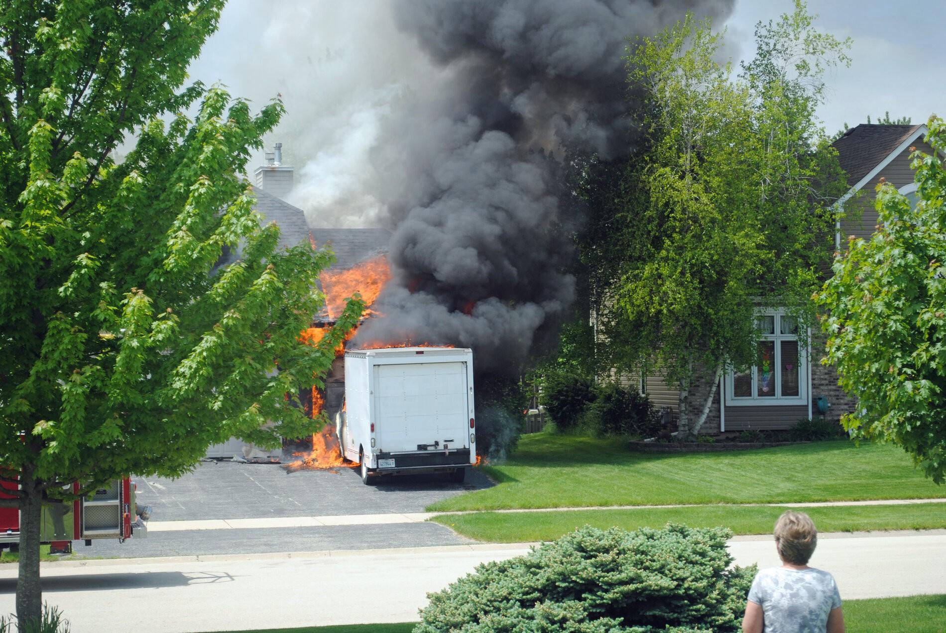

My neighbor had a electrical fire on one of his work trucks and almost burnt the house down. It would have if my wife did not see the fire and called the fire department.
I agree, it could have been a lot worse. It was a school bus. The batteries are in a metal box with a slide out tray mounted under the bus.
