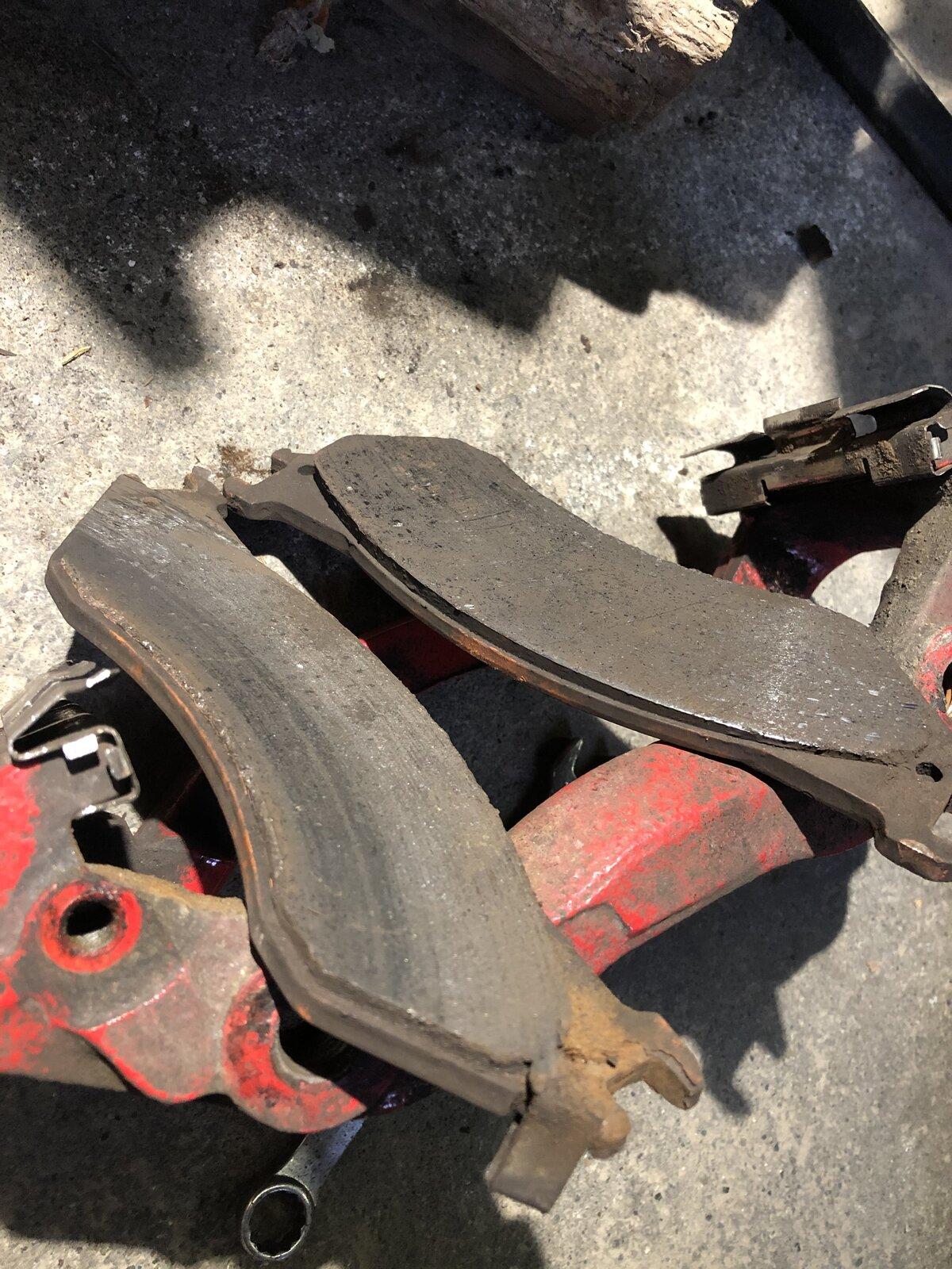

My 01 Sport that i replaced the calipers (power stop) and rotors plus pads (EBC) and flushed lines has worn out one of the rear sets of pads. The wear is fairly equal as seen but the other side has 1/4" pad left on both pads. Fronts look great also. I may have 20k on the complete job.
My friend has been using the truck and has done the work on it as I am not in the area. To get by I told him to buy a set of $30 pads and throw them on. While things were apart he said the pistons pushed in easily. Truck has about 140k with I am sure the original brake lines. You can see the lower pads left end just started to touch the rotor. I just noticed that pad links to have 1/8" material left so it's wearing unevenly. That does not explain both sides wearing so fast.
What the heck could have caused this???
I would guess the problem is on the other side, and this side is overcompensating for a lack of braking on the other side.
Just because the calipers move in easily doesn't mean they are working properly.
When was the last time the brake fluid was flushed?
I've seen numerous calipers stuck due to corrosion internally, likely due to water, rust, etc and poor brake fluid condition.. worst is when they stick "engaged" like happened to my camping buddy on his 05 going down black mtn. Ive had some push in "easy" then get stuck shortly after that, IMO due to the above mentioned factors,.. generally I think diff oil and brake fluid are the two most under services / ignored maintenance items out there.

To be clear ALL parts were new including a complete brake fluid (AMZ/OIL) change. These are US Made PowerStop powder coated calipers (Top Quality) along with EBC US Made Rotors and Orange Towing pads.
So how can the opposite side cause the dramatic pad wear?
Any chance a brake line got kinked or twisted when the brake job was done?
In any event.....I’d highly consider new rear brake hoses. Sometimes.....brake hoses can collapse inside. Apply the brakes....and the pressure flows well in that direction. Release the brakes....and the fluid doesn’t flow so well.
Picture a flimsy straw being used to quickly consume your favorite chocolate milk shake...
Were the caliper brackets replaced too? I see one looks painted but Sometimes not enough attention is given to cleaning up the areas of the pad slides causing the pads to stay engaged after the caliper releases.
I see this alot around here.
I set parking brake EVERY time I park, even in my shop. Is it possible the parking brake mechanism is sticking? How many miles since rework? The rears typically wear considerably LESS than fronts, so with new calipers and pads, fluid, it's got to be something else.

Parking brake shoes are inside the rotors ;)
Never knew that, I guess that dispells that theory...
- Master calendar propationing valve applying more pressure to rears than fronts? Seems it would be felt, but maybe not.
- Brake load propotioning valve issue on the rear axle? My '00 2500 had one that reduced rear brake pressure unloaded and increased it loaded.
Just throwing stuff on the wall to see if it sticks.
I was very careful and hung the old calipers then did the new and then removed from old and mounted to new.
My first thought was brake hose but then my friend said the piston retracted easily. But when the fluid is moving back and forth may act differently.
The calipers are new and of top quality but i guess anything can fail, My thoughts are a bad hose but as mentioned the other side may effect the bad side???
YES, all new! I sued the Permatex Synthetic caliper lube on the slides and all mating surfaces. The brakes work GREAT as I upgraded to 3rd gen fronts.
