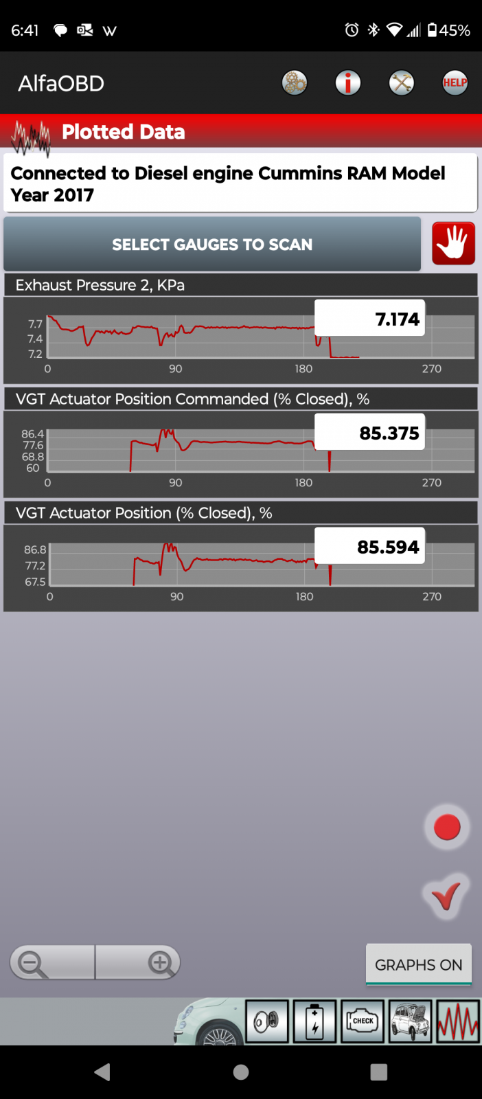

I have been watching the turbo actuator command and position, and it always follows the command, which I assume is the PCM command. So, I assume it's not the actuator as it does follow the command unless it's not reporting correctly. I was thinking it needs the turbo actuator replaced but no codes and the position follows the command. I don't want to drop almost a grand on an actuator if that's not the actual issue.

Yes yesterday started using my alfaobd monitoring some PIDs. I attached what I'm monitoring. I'm seeing the turbo match the command. Runs from 10% to 100% from what little I've been monitoring and playing with the throttle. What confuses me is exhaust brake comes on about 93% but yet it idles at 93% closed. So why isn't it on at idle too. I don't understand how it can brake at 93% but idle at 93% without braking.
First screenshot is engine off, key on. Second is idle in park. Just some examples. My exhaust pressure sensor doesn't go to zero. I assume that's its lowest range reading.
The exhaust brake during driving seems spot on except I've had a couple times where it came on with a 5 seconds or so delay. Enough to be like wth and you start to panic. That's happened 3 or 4 times. Last time was coming down a 6% grade with the 13k 5th wheel. Exh braked for a turn,came out of turn with foot on throttle and the next turn when I lifted my foot, it didn't come on and then finally did. I also had in the winter where it stayed on after I throttled up and stay on down to stopping instead of the usual 18ish mph. Once stopped it finally went off and the. Came back on for cold engine warmup.

Airflow at idle and 93% is vastly different than 2500 rpms. The closer to idle you get slowing down the closer to 100% the VGT should be in EB mode.
If commanded and actual EB position match its likely not your actuator.

But the exhaust brake at warmup is at idle. That's why I say it's confusing that 93% closed can and can not be braking, including at idle. But I will try to catch it working at warmup to see what it goes to at idle. Maybe 100% vs 93%.

93% is plenty for braking at high rpms and plenty for increased backpressure at idle. You only want a few psi of back pressure at idle to get the benefits of warmup without the negatives of too much back pressure.

The exhaust pressure sensor? That's on my list to clean. The sensor, the ports and the connecting tube. It varies in readings. Doesn't go to zero with engine off and key on as I mentioned. But I do know that sensor readout is use by the PCM to control exhaust brake function. I've read they can plug up with soot but they would get a code. I'm not getting any codes. Even the time the brake stayed on during acceleration I didn't get a code. I assume the PCM doesn't monitor those things or there has to be a huge difference.
