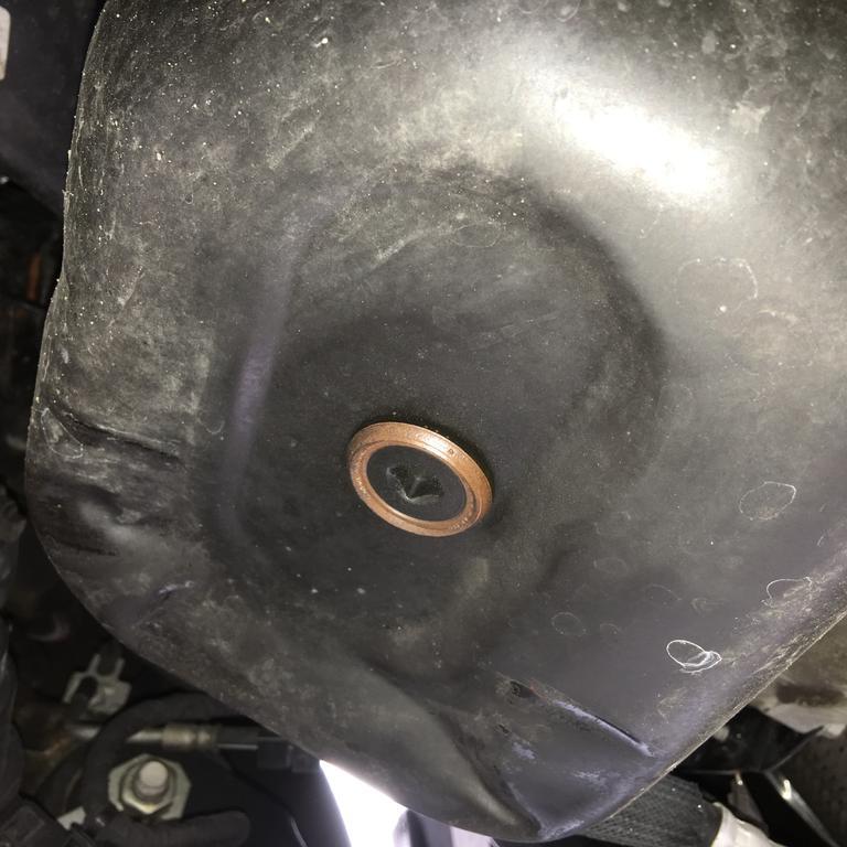

Great went under my truck today to do some undercoat and saw that they crushed my oil pan when they replaced my turbo great now To go to war with the dealer.
Oil pan crushed by dealer
I am ******
They are going to say it was that way when you came in! I would be looking for other damage. SNOKING
