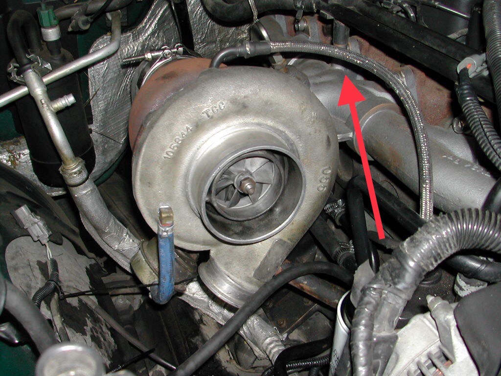

I put the ATS on my ‘95. I don’t recall not being able to bolt the tubes up. This is the only pic I have showing it.

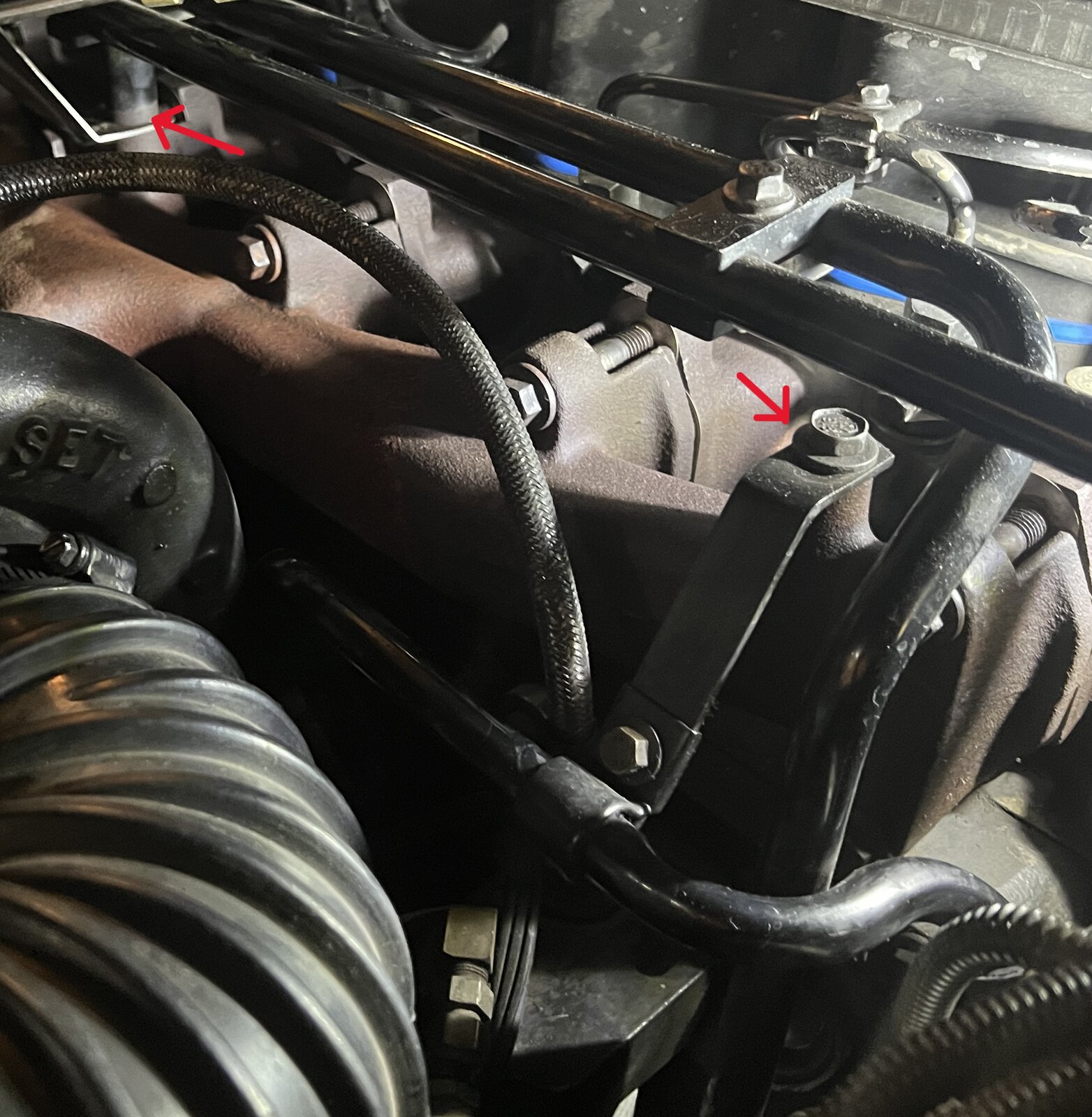

I have an ATS 3 piece and it has the mounting point for the heater hose mount. I suggest you call them to see if they have the wrong picture or changed the design.
The oem manifold on our truck has two heater line mounting points. One next to the # 1 and another next to #4. I anticipate a conversation with ATS in the morning. Thanks
I was hoping for a aftermarket manifold that accommodates the forward transmission cooler bracket as well. If there are no negative issues for the cooler without it great.
ATS Tech line says their 1-PC T3 manifold does not have any mounting bolt holes for the coolant lines. They said it was for the high performance applications, like racing etc..
