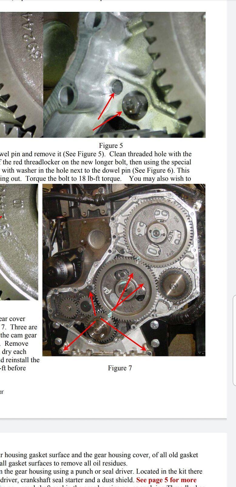

Well that's disappointing...according to the TST instructions there were only two bolts under the timing gear?
I ended up completing it tonight...four case bolts under the cover (including the KDP), two at the oil pan flange, and the two cam retainer bolts.
This is the TST instructions from the Geno's Garage KDP kit...
"2" are under the physical gear where those arrows are pointing, there are additional as you found holding the cover to the block. I skipped those 2 on mine. Or one of them that was not able to get too. Nothing was loose on mine.

So which is it, two or three under the cam gear; I did two? Curious minds want know....
