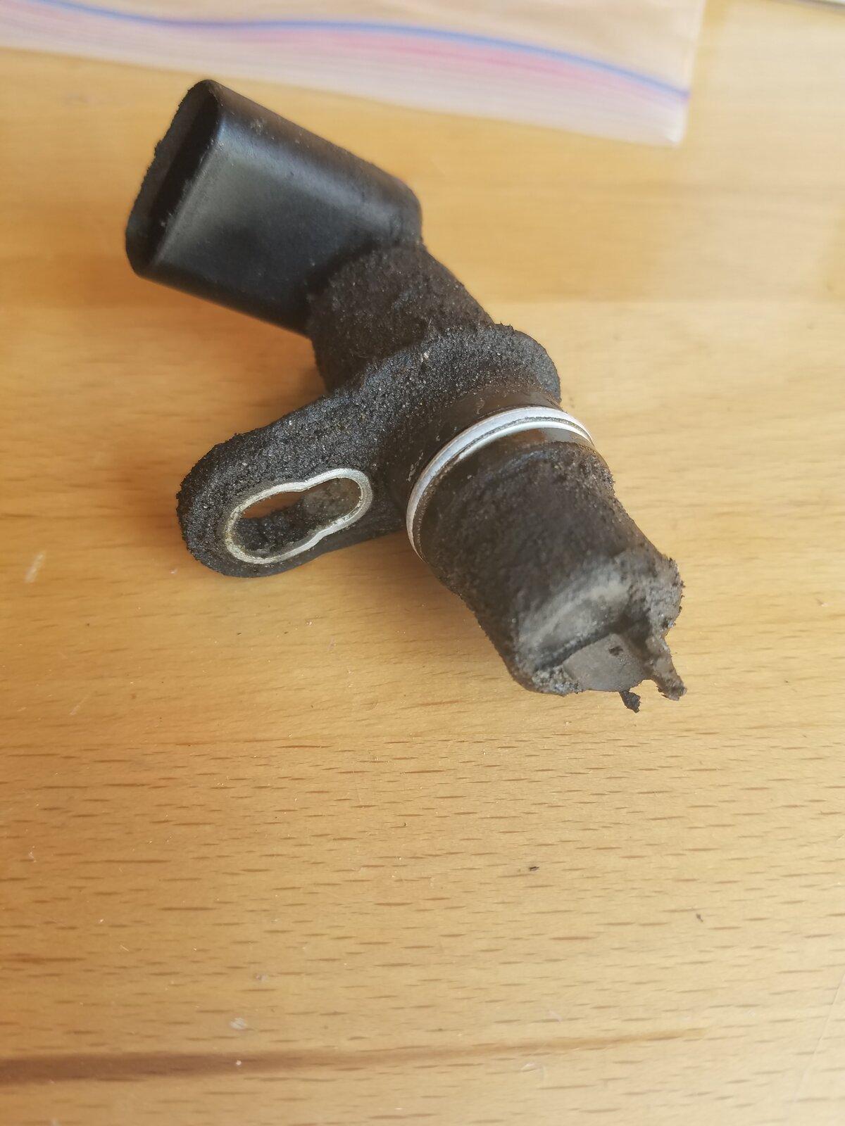

HAVE YOU CHECKED YOUR CRANK/CAM SENSOR LATELY ?View attachment 130974
