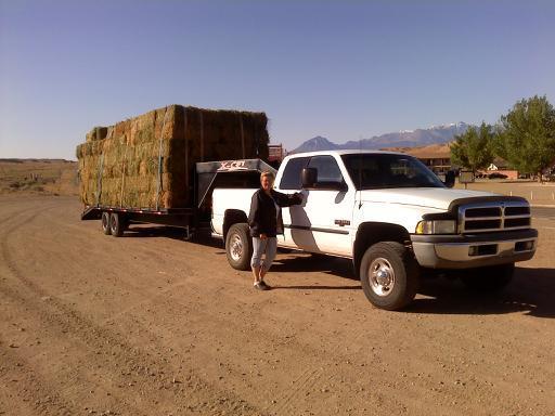

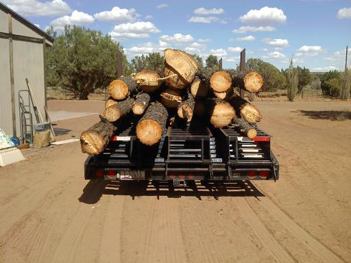

I have found that about half of DOT enforcement is about perception, if the load looks heavy they will check you. Case in point, the logs weigh 26k the hay weighs 23,500. Which one will you look at? Same truck and trailer in both pic's.
