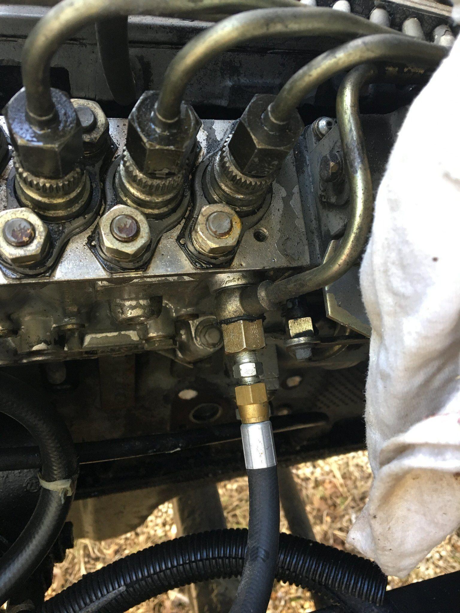

So, now, 4 months later I am finally getting back to it..... I have had the tanks boiled out, changed the filters, primmed it with the FP button and It will not start.....I have about 15 psi of pressure when cranking, my FP gauge is attached here...

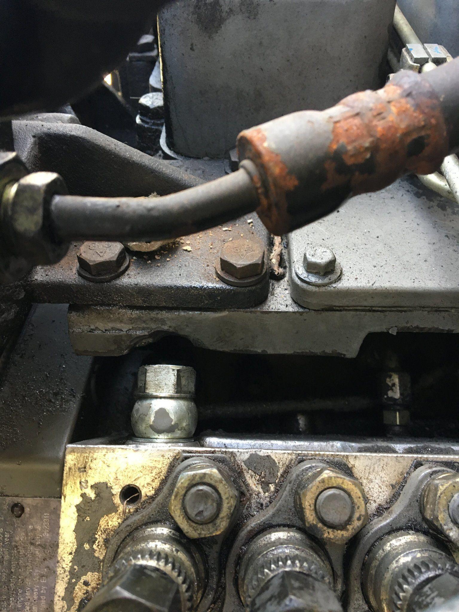

I can loosen the nut on top of the water separator/filter and I push on the FP primer button, fuel will flow out.
If I loosen each injector line on the P7100 pump I get a hiss and a few drops of fuel every time I press the FP primer button.
If I loosen the Overflow valve I get a spurt of fuel with each push of the FP primer button.
