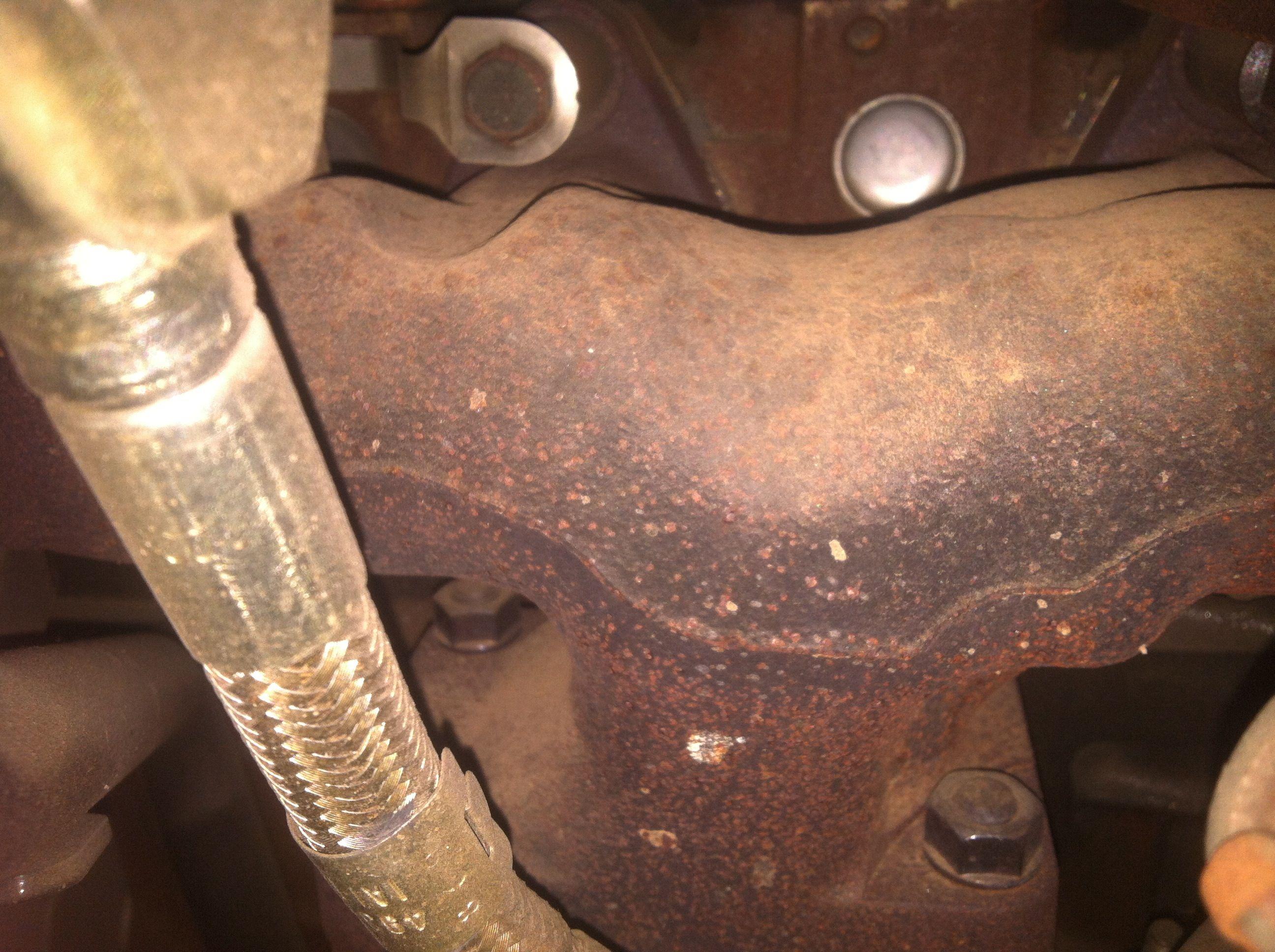

The picture I'm posting was just prior to install, and you'll see a white dot in the middle of the "Y". You need to remove the fender liner, and remove the nuts that attach the HVAC refrigerant accumulator, then move it to the side. I used a right angle drill and drilled it dry slowly. When the bit sarted to penetrate the inner wall, I took a shop Vac and drilled slow while removing the bit several times. untill it was complete. I did the same when tapping for the threads. I had my SIL hold the vacuum during the process.
I would check for the type of threads of the EGT sensor you buy, there supposed to be 1/8" NPT, but the one I bought from PLX happened to be 1/8" BSPT (British Standard Pipe Thread). I did a test drill on a block of aluminum with 1/8" NPT, and even though it worked, it went deep into the treads and just barely tightened. So I researched and PLX sent me a new one, but it had the same threads and taper. I ordered a 1/8" BSPT tap and it fit like a glove. You will know it because the taper is barely noticable. So I drilled only once with the proper tap.
Everyone has their own way on how to tap for it, and I got a lot of different opinions when I asked the question, so I chose the dry method.
