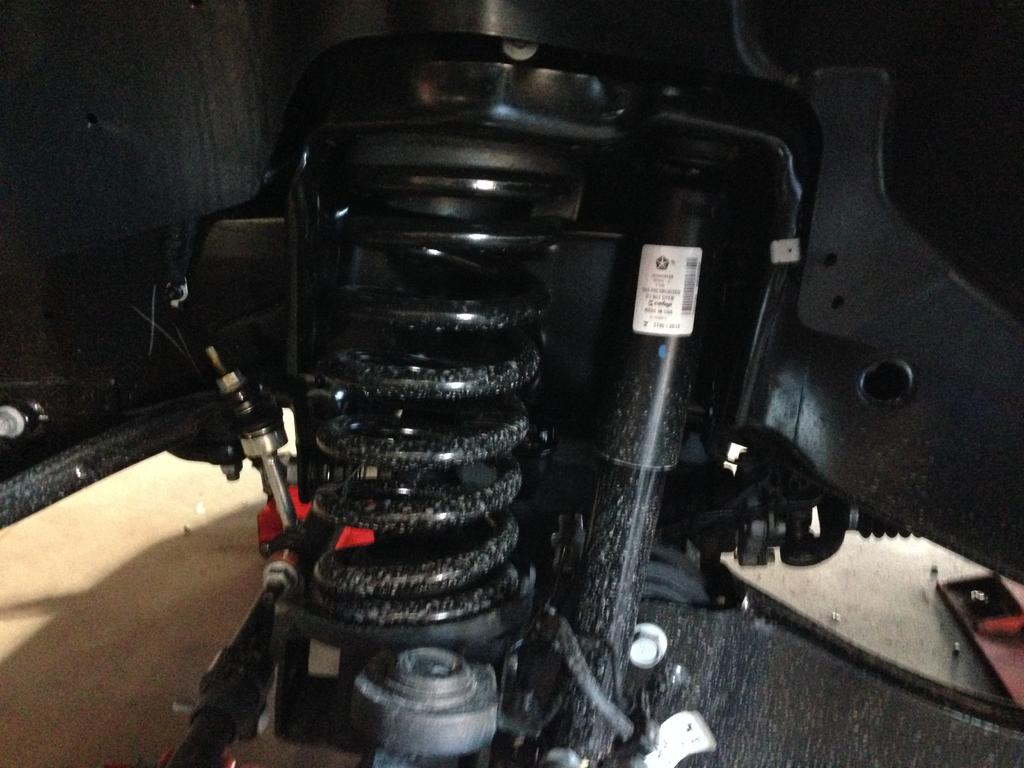

They are Black! And I would know more how? SNOKING
Look on the boot it will say as seen in pic below. My shocks on my 11 Dually were POS and Made in Brazil.
