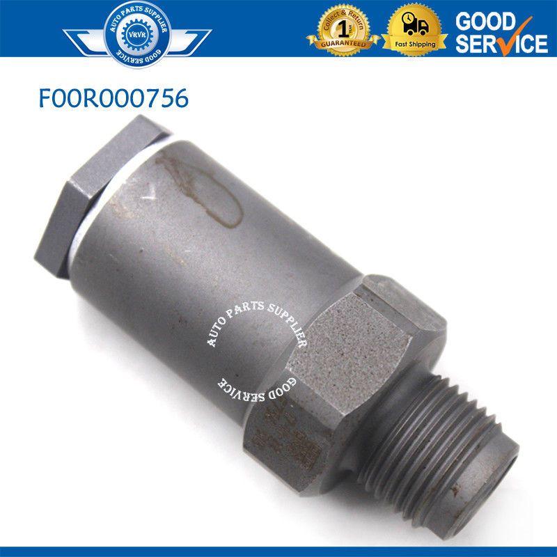

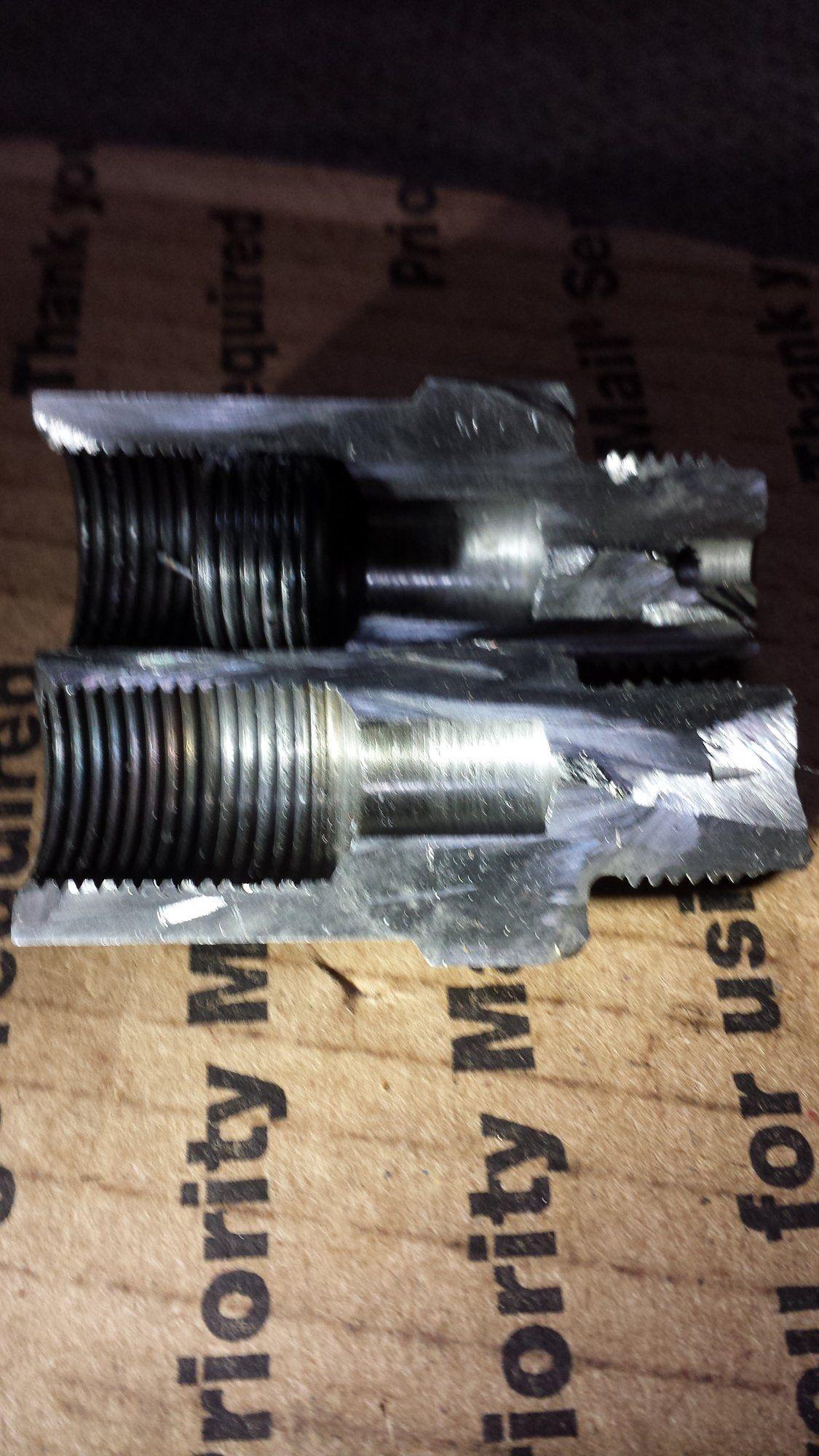

This is NOT a Valve it is a plug, We cut it in half and found it was completely solid, This seller is using Bosch Part # and it is fake, it is NOT a valve it is a plug, its a fake impostor (China)

and will never work as a limiting valve "Never"

Were there any other guts to it? Did it miss a manufacturing step and they have no quality control or was it never intended to work?
It was never intended to work.
The last year or so, China impostors , Cross tubes, FCAs, Injector parts, pump parts, Pressure sensors etc. We have found China junk tubes in Bosch boxes ,its that bad.
