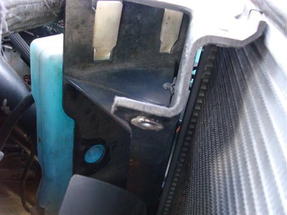

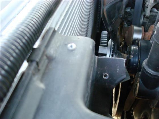

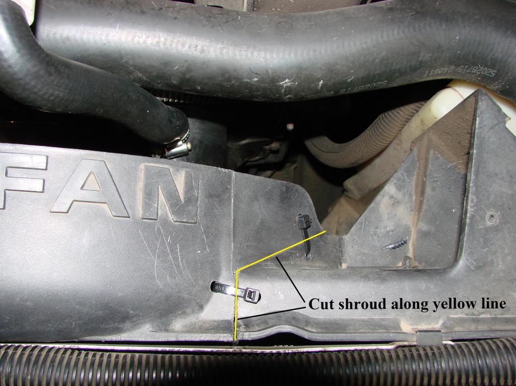

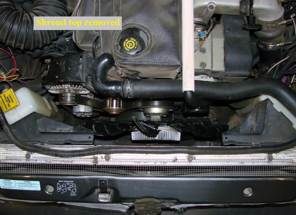

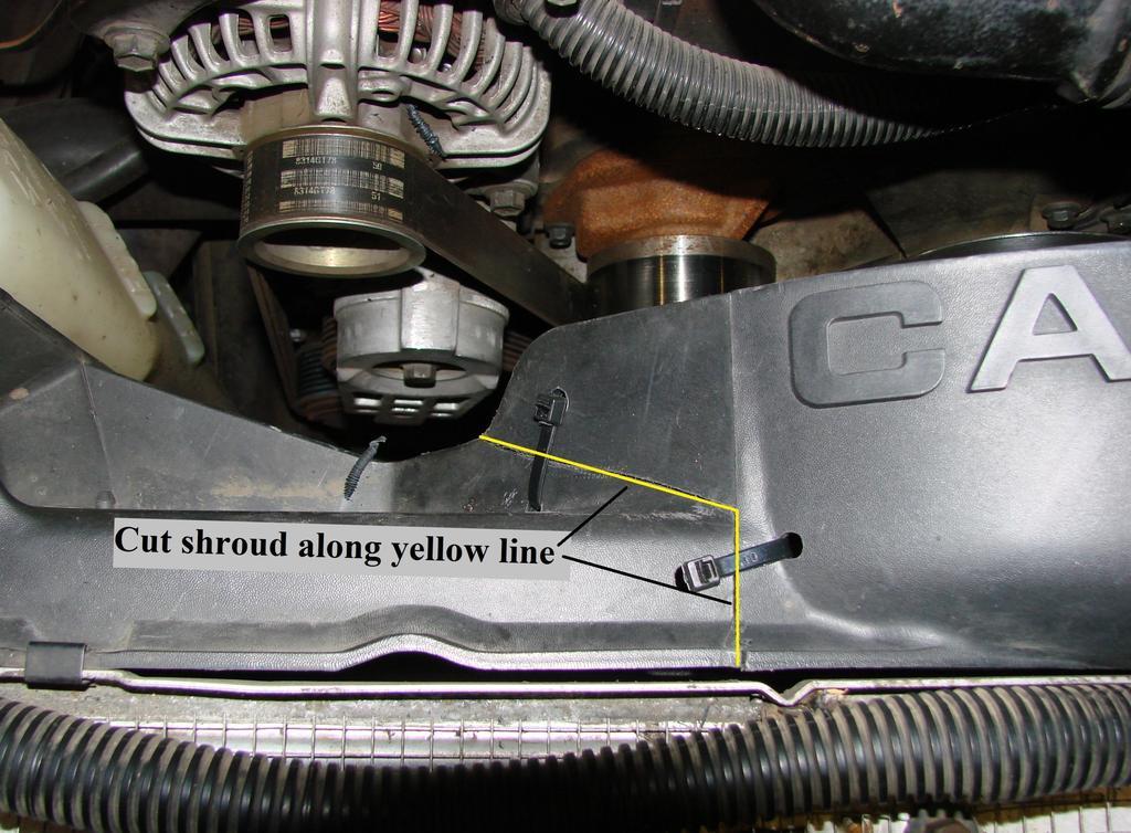

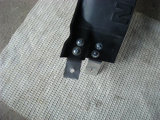

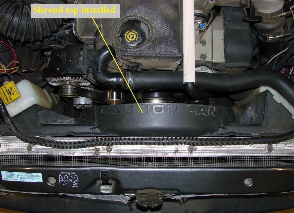

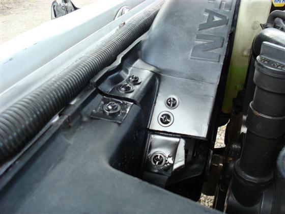

The letter from "A TDR subsciber" in issue 58 really caught my interest since I have had to replace three fan clutches, two water pumps and a belt tensioner while on the road. It will also make replacing the serp belt a lot easier. I finally got around to it this weekend. I did make a few changes. First, I used a miter saw instead of a hacksaw which resulted in nice straight cuts. I opted for six bolts per side instead of four, which I believe makes the installation more stable. I used T-nuts for the outboard bolts and used J-B weld to hold them in place, home made nut plates. I word of warning. The T-nuts each have three points that are intended to be hammered into a board. Do not try to hammer them into the plastic of the shroud !!!(J-B weld repair not shown:-laf), instead, bend them flat.
