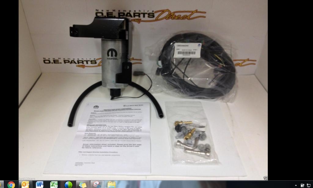

From your description you already have the mopar sever duty filtration system (http://ww2.justanswer.com/uploads/ndarimont/2012-05-07_225433_fuel_filter.pdf).
So to explain my earlier post about removing the cab filter. You should be able to sell the severe duty filter as long as you reverse the install procedure and include every thing. There are a lot of people that prefer to add additional filters rather than put on a less reliable fuel system even if it does flow more. Also the Severduty filter's filtering is not really specified, I have heard that it is only a 10um (or may be 25um as that is what they had on the 5.9 version) filter so unless you put junk filters in the FASS it will not catch anything.

Based on your experience and that I want to build this truck to be strong and powerful yet reliable what kits do you recommend? I have attached pictures of the factory mopar water seperator system that I have. Dodge cant even get the filters for this anymore and every time i need a new filter i go to ebay and buy THE ENTIRE SYSTEM for 66$ so now i have about 5 systems laying around my garage all brand new with no filters because its the cheapest way to get them. on eBay this cost $66.50Part# 68083826AA
