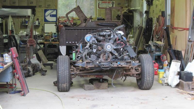

Hey VF,
Thank you for your reply. I went ahead and ordered the pump. Right now I intend to hang it up by the engine. I'm going to see if I can't come up with a way to protect it somewhat if I place it back by the tank. I also try to wash underneath in the winter too. I'm deep in the middle of a cab swap/ rebuild of my truck so now is a good time to do this kind of stuff.
Looking at it tonight, I think I have dug myself a very deep hole.....
Actually it has gone very well so far without any issues. I ordered the pump and a new fluidamper from XDP tonight.
whoa, that's a project. Another thing to look into while you have everything apart is the fuel feed and return lines on top of the fuel tank control module if you have not already. They are metal and rust. They did this on my 99 so I replaced it with a Vulcan draw straw eliminating them.

I ordered the relocation kit and was thinking about the fuel lines last night. I'm going to do that as well.
Yup, it is quite the project AND I need to drive it this winter. In the last hour, I just sold my 13 Boston Whaler for 2500 and the short bed from the donor truck for 900. I now have what I need to comfortably finish this. I so happy I going to pour myself a beer or two or... crap, at this rate I'll never get anything done tonight... .
