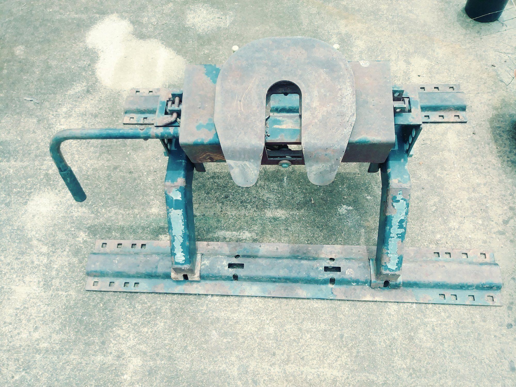

Hi All,
I have a problem that I hope someone can help me with. I had a 1996 2500 CTD long bed that i removed a "Lil Rocker" fifth wheel hitch from several years ago. I now have a 02 2500 CTD long bed that previously had a fifth wheel hitch installed in it. I thought that the "Lil Rocker" rails would fit in this truck, but they are not wide enough to hit the existing holes. The "Lil Rocker" hitch fits the standard rail at 22" from the front legs to the back legs. But the holes in the 02 CTD are different. I was trying to figure out what brand of hitch was installed in the 02 so I could replace it. From the center of the front hole to the center of the rear hole is 28". The width center across the bolt center is 42". I was under the understanding that they all were standard, but this one is not. I have attached pictures of hitch and bed showing bolt holes. If anyone knows what brand of rails I need, please let me know.
Thanks
Doyle
