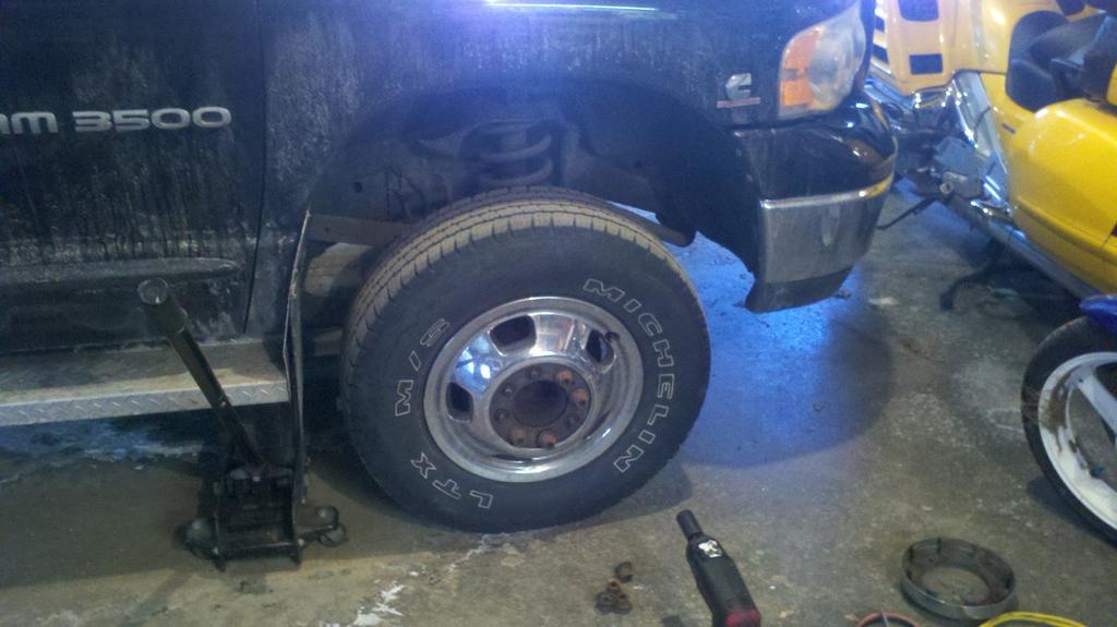

No good pic's yet. Have a before and during for the right front. Will try to post.
I think this one is the before.
Trying to fit it in there. I think it will go. It will be close to rubbing with no lift.

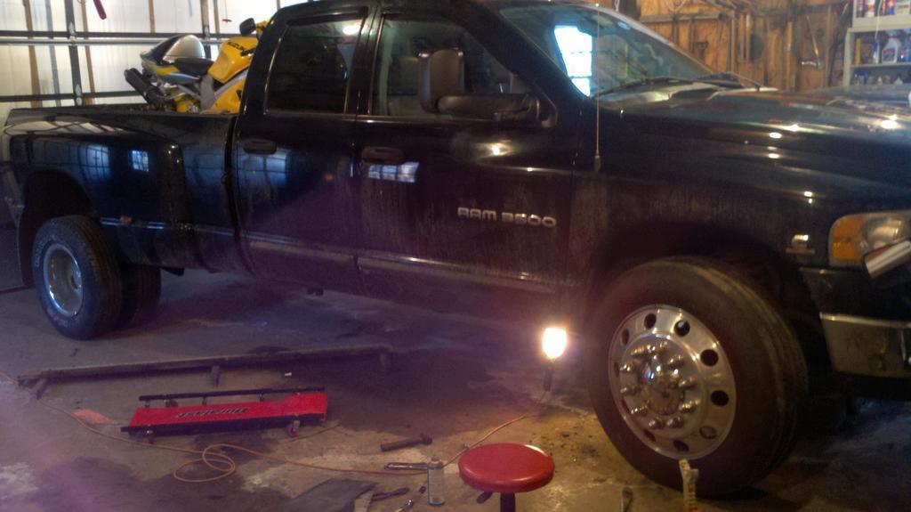

Worked on it some more last night. Hard to find time with wife and kids for non repair items:)
First pic is front tire installed, running board and mudflap removed. I used a soft rubber mallet to massage the inside fender lip in a little just in case. You can see I still have the stock rear tires on at this point. Still sitting very level.

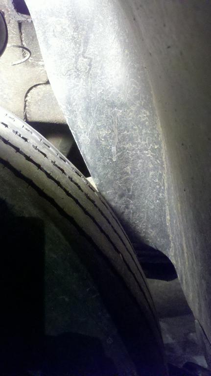

Second pic is the rear inner fender well that you need to trim. I used a pair of tin shears.

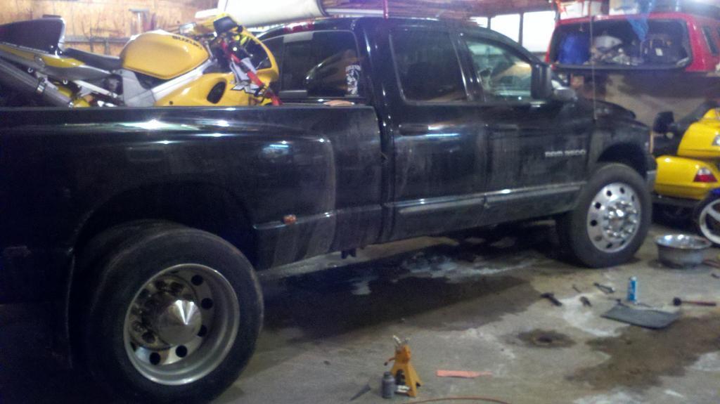

And last but not least the pass side is complete with all the road salt/grime included. I will have to remove and polish. I want 4 polished inside and out so I can do rotations once in a while. Right now this is the only configuration possible until I do.

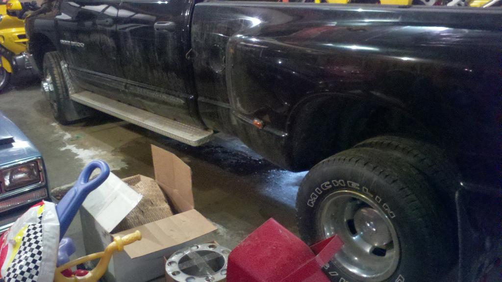

And just to compare here is the drivers side awaiting install.
As you can see these do fit with no lift at all. Lifts might look nice, but they take away from the functionality of the truck.
So weird that this upgrade only picks the truck up 2", but it looks like so much more.
