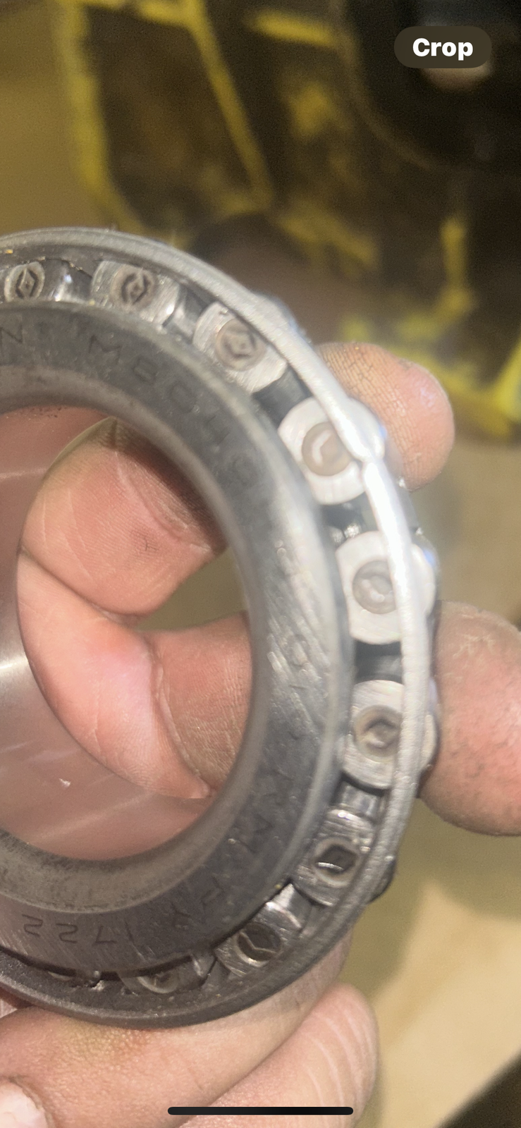

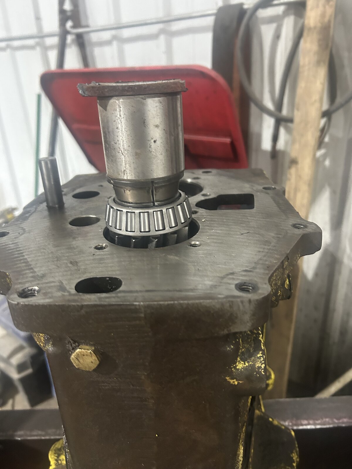

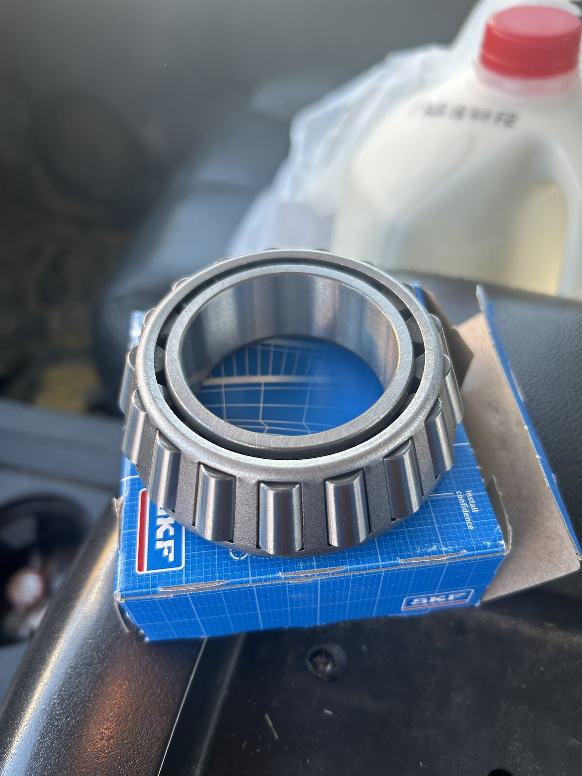

Got the counter shaft in and end setup . Debating ordering a new bearing or use the old one . Torque queen managed to ruin one in shipping
No way I would reinstall a used bearing. They are the cheapest part of a rebuild, and a failed bearing is going to cause mucho $$$$ damage. Not hard to find them from a bearing supplier.

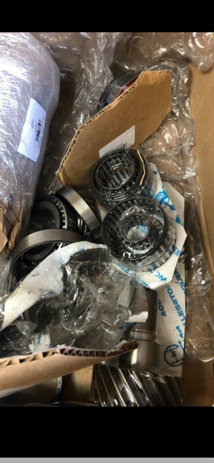

well they managed to ruin this bearing and shafts came with teeth that looked like they got dropped on the concrete from Montana to my house . Do what you want but I wouldn’t buy anything from them . I find it funny right on their website in several places they state rough handling of bearings causes failure . Then they send me this and won’t do anything about it

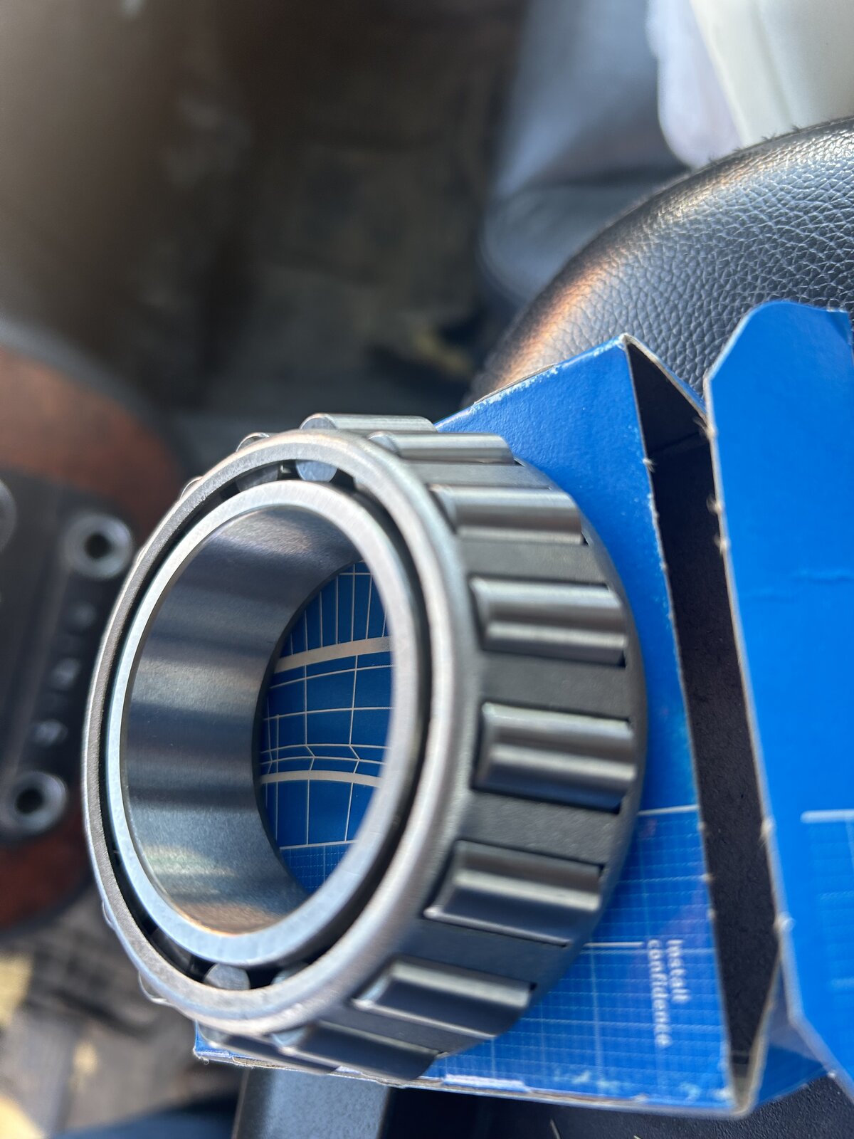

Just ordered the bearing from Napa for cheaper than online stores and no shipping .
Who do you think was responsible for the damage? Shipper? Or do you think they were damaged already going out the door of Torque King? Who was the shipper? Thanks!
Packing it properly- everything must be packed in a way that it can be abused as a football without taking damage.
As a shipper you have always to expect the worst possible.

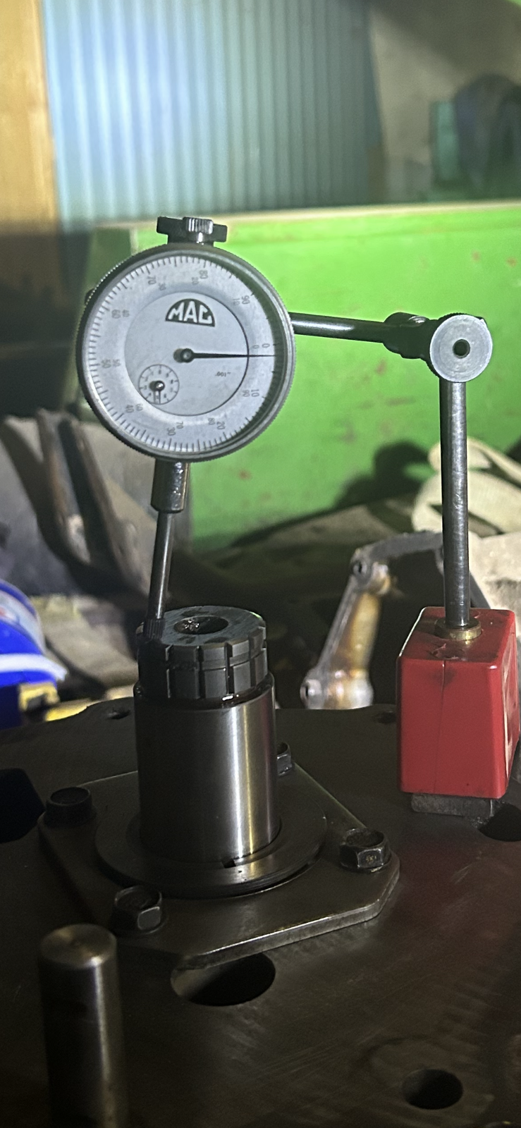

I’ve had good luck with all states parts I think that torque king I’d probably higher quality in the end biggest reason I went to torque king was because they are close and shopping is faster . I would recommend whatever you do to get the fifth gear nut from all states gear it’s called the super nut and it works I would also suggest you get the manual from torque king snd also there fifth gear tightening set you can see in my Kade photo
