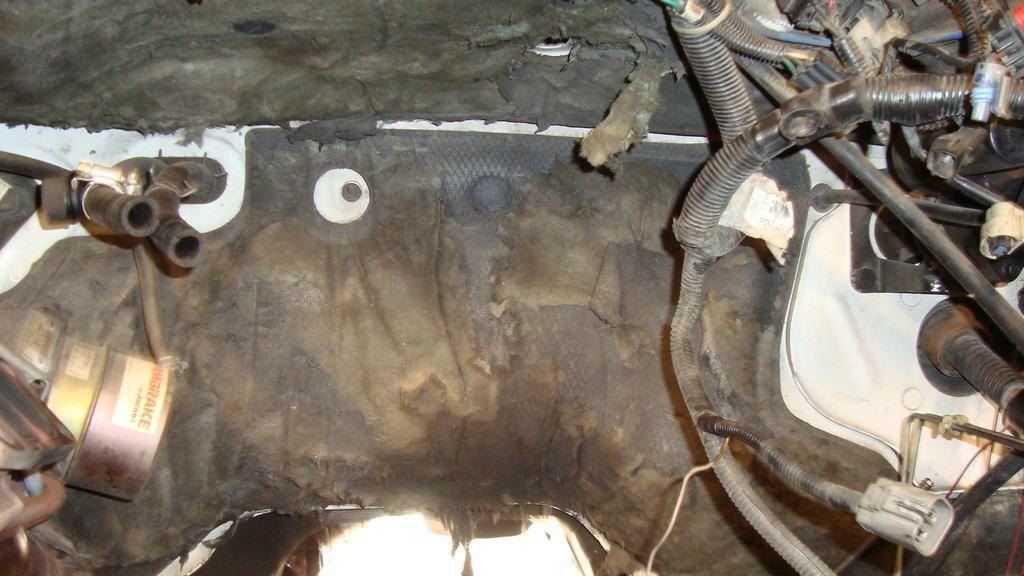

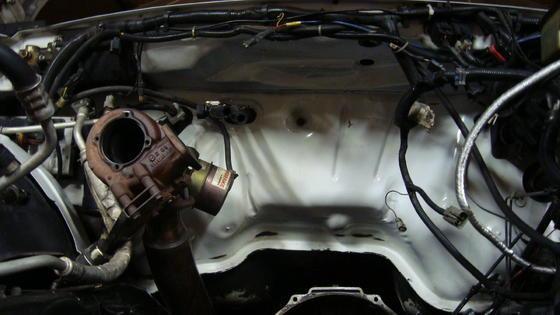

With my engine out now is the time to remove the shredded and ugly insulation. Is it there primarily for noise or heat? There are several threads about it, but most concern mouse nests and ways to combat them. Has anyone just removed it and called it a day, or is there something that can be installed in it's place? The down pipe comes really close to it, so definitely need something fireproof.

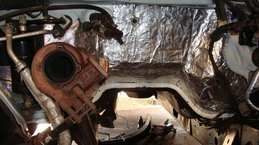

How about the modern aluminum foil and bubble wrap product used in vintage car upgrades? I think it is called "dynamat" or something similar. Reportedly very efficient at blocking heat and sound.
I have it installed from firewall to trunk under the carpet of my '56 Chevy sedan.
I looked at the dynamat but it doesn't appear to be made for external applications, and I'm not sure it will withstand the heat. I have found a product from thermo tec that is supposed to be good to 2000 degrees. It looks promising, but I'm wondering if I can just do away with insulation completely.

I pulled all of mine off because it was looking ratty like yours. I can say that my truck is louder than most I ride in, and I would like to replace it with something in the future.

I'm sure you are right Harvey. I think I'll go with a strip of the high temp stuff above the downpipe, and second skin the rest. But first I'm going to see if the preformed OEM blankets are still available. I do like the clean look though.

No complaints. There is a definite reduction of noise in the cab, according to my wife. I might extend the reflective heat barrior farther back when I pull the engine the next time. All in all, worth the time and expense. After 50k miles it is still looking good.

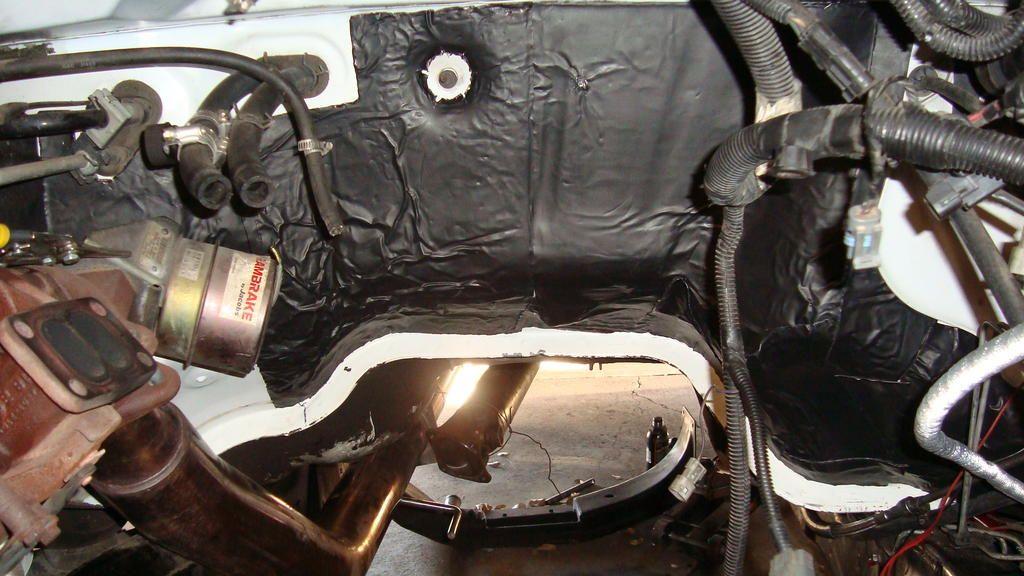

Floor tunnel heat shield withstands 1750 degrees F. direct continuous heat, stops 50% road noise, works in harsh environment, self-adhesive backing. I purchased 48”x42” sheets (bought 2) I think I did mine with the engine in place and sealed pieces together with aluminum tape from Lowe’s. Has been installed 2 years in 110-120 degrees Arizona Heat. No problems. Made a big improvement in sound and heat. See picture

Thank you. Really cleans up the firewall.
