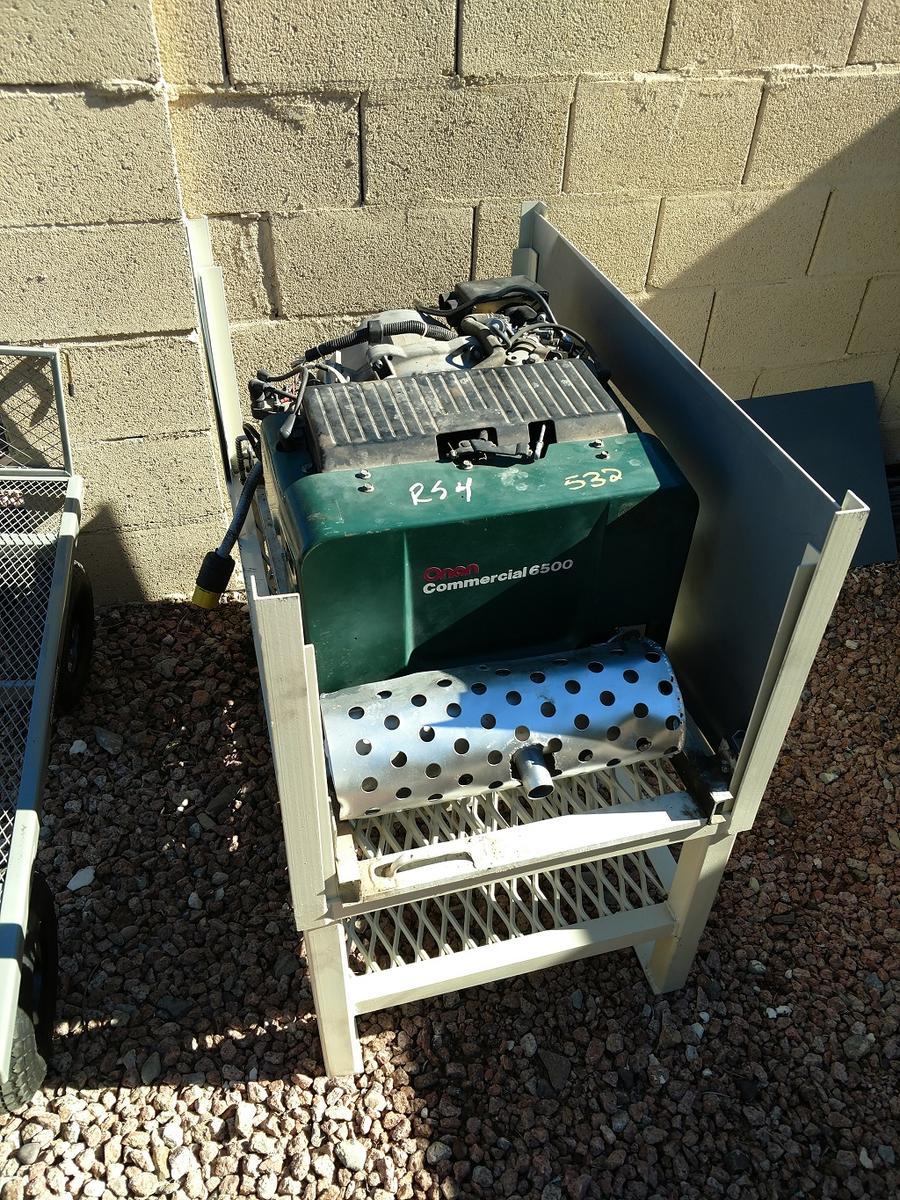

Go on the ads, like CL, and get an old quiet Onan 1800 RPM RV pull out generator 4K - 6500W that sell for $400 or $1000 all day long. Nearly 4 quarts of oil with an oil filter back when The USA made things to last. Add a shelter and gas tank and call it a day. The old Onan likely will outlast you. These old Onans will deliver at and slightly over the wattage rating without problems. (Make sure it runs and makes power before you buy used.)
Add a propane kit if you want dual fuel. May de-rate it some.
The Pacific Rim junk engines/gensets have earned their bad reputation of popping a rod when you need them the most. Some may last then the cheap gen end blows something and quits. The watt rating is a work of FICTION as some can't deliver even 80% of their rating with the surge rating a running joke from marketing.
If you must have new and shiny get a Honda Generator. Not just a "powered by Honda". Again be Frugal not cheap here.

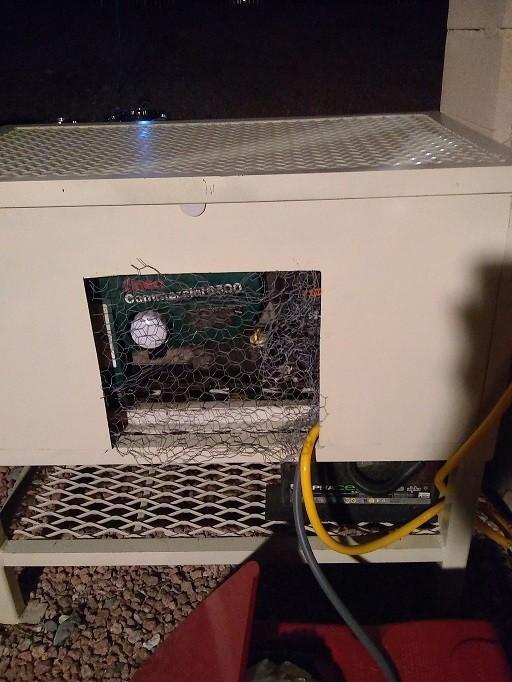

The Onan in the picture is 21 years old with 2582 hours before the hour meter locked up. It's quality is better than any new stuff on the market today. As a backup it's flat head fuel economy doesn't matter so much vs. OHV. I also have a backup for it just because. And with the Onans as "Insurance" the usual 4 hour 4 times a year power outages are now a single 15 min only in the past year. Monsoon season didn't have any big storms for us this past year.
You can't get a warranty longer than 2000 hours on a new home backup unit including large liquid cooled 1800 RPM units. Due to CA's unreliable power grid and storms elsewhere Generac (Junk) stock is doing very well but there is a back order on home standby generators. Long outages 24 hours a day adds up quick on oil life, fuel supply, and that 2000 hours.
