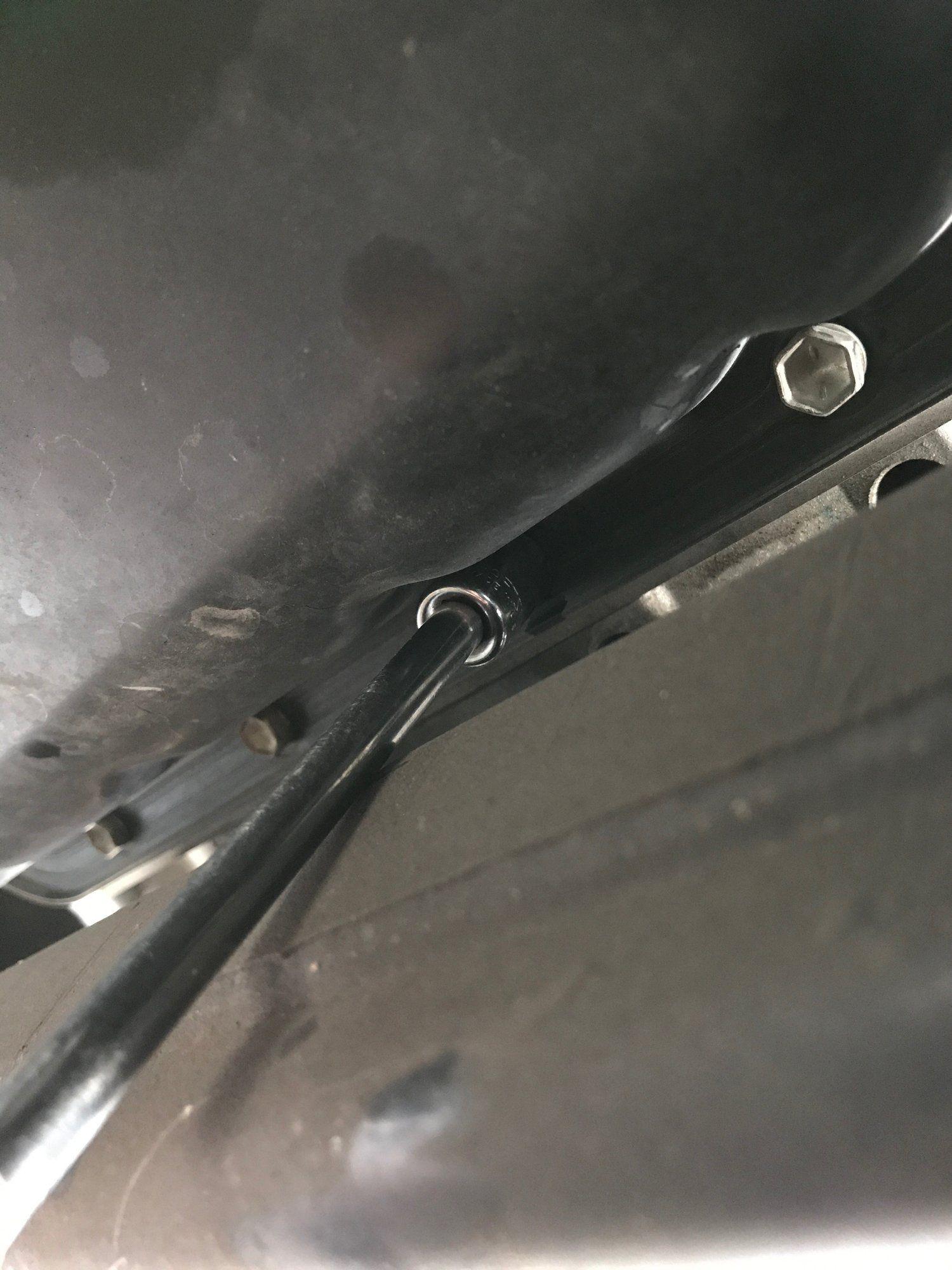

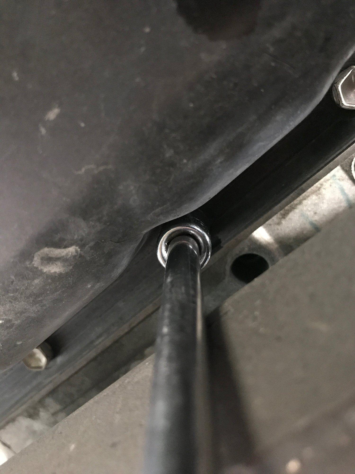

Not sure if the crossmember has been changed or if it’s a 4500 thang, but I was able to get a direct shot at those 4 pesky transmission pan bolts closest to the crossmember without even using a universal or swivel. Not lowering the crossmember was a huge timesaver over the same servicing of my previous 2014 RAM 3500 pickup w/AS69RC.

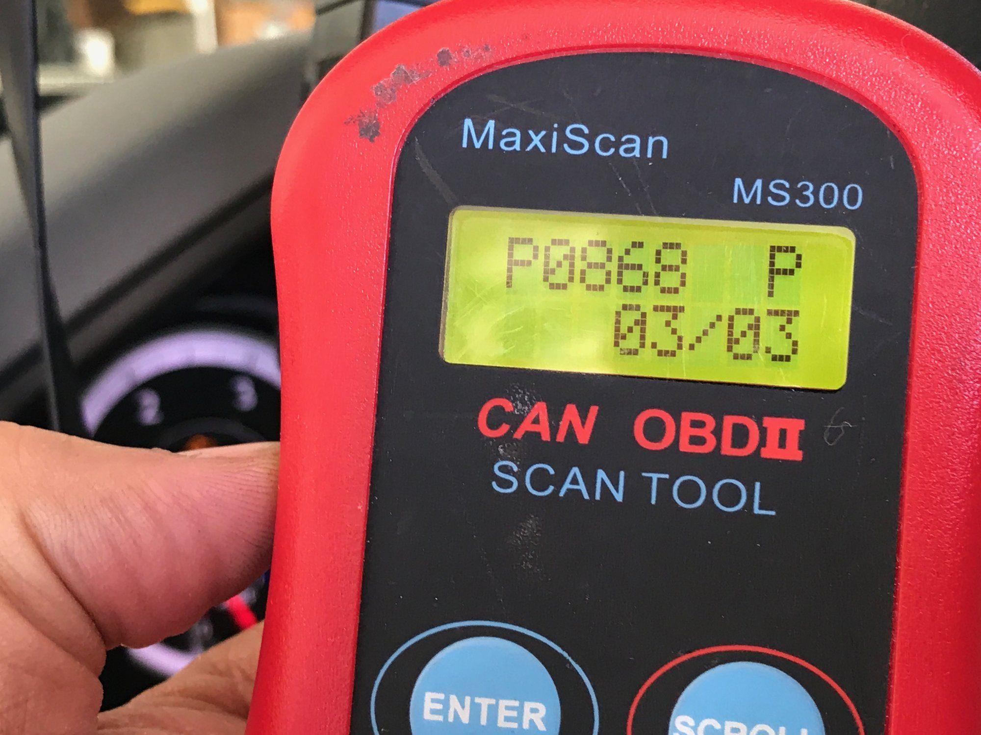

As with all of my previous sump filter changes on the AS69RC, I received a P0868 code (Transmission Fluid Pressure Low). I cleared it with my cheapie code clearer and all is well.
