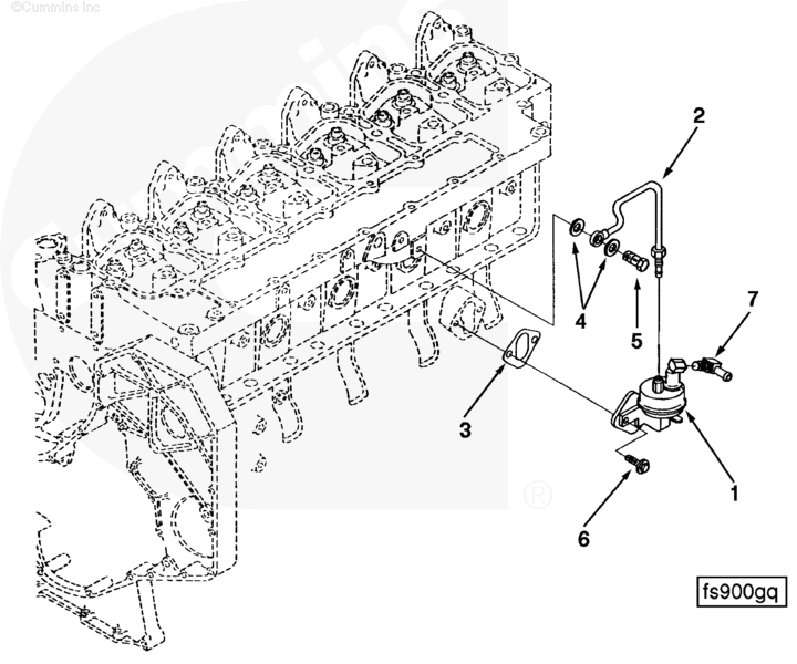

Yes, that bulletin looks like what we need. I just wonder if "low output" means low pressure, not volume? Surely, that's what they mean. Yes, we'll need all the parts listed in the bulletin, spacer, line, hardware, and gasket.
My '92 takes a Cummins 4983584 Diaphragm-style pump. According to the bulletin, I would need these parts to go to the "low output piston pump":
  • (1) 5269315 Transfer Pump (Piston style), still available, $91.06 from my dealer
  • (1) 5271291 Fuel Supply Tube, still available, $104.78 from my dealer
  • (2) 3939258 Gasket, available, $4.49/each
  • (1) 3924725 Banjo Bolt, available, $12.74
  • (2) 3963984 Sealing Washer, available, $3.49/each
  • (1) 3914284 Spacer, 5mm, still available, $10.00 from my dealer
Total is $234.54

I got the pump from interstate mcbee 25. 97, fueltube cummin s 12.00 gaskets n spacer 9.00 banjo bolt gauge ready 14.00 bag of seals 10.00 but dont laugh< i wasnt happy with results with justin fonder spring. went to bad ass hardware store has evwerythin g local picked out a spring. ten ponds at idol, 12 full thjrottle! Now, tomorow i drive I hope the power is back, or im throwing my free chineese injectors in the trash and ill b uy some boschs!
