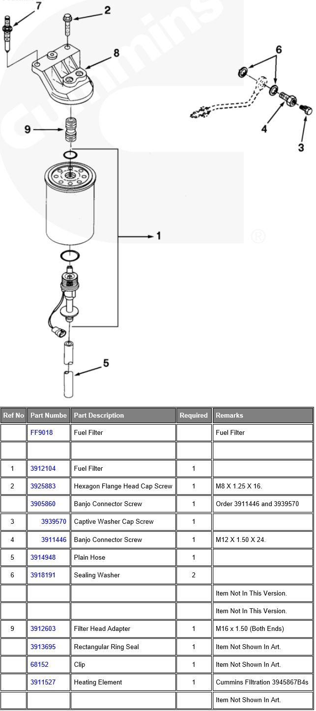

Working on a 1992, 2wd and it looks like the fuel filter is leaking at the fuel heater. Is there O rings that can be replaced between the fuel heater and the fuel filter mount? Is the fuel heater available or can it be removed? The truck is a coastal California truck so it is never needed.
Lastly, Is the little water sensor/fuel drain still available and if so, where. Thanks for any information. Chris
This is the Parts Breakdown from QuickServe for a '92 D250. I don't know what, if any, of this is still available.
Thanks Guys!! I washed off the area around the fuel filter and fuel pump. I left it to cool off and started the engine. Sure enough, the FUEL PUMP is leaking. Cheap Chinese fuel pumps! Apparently that's all you can buy unless you convert to the modified later second gen mechanical pump.
