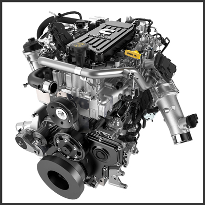

It’s been 36 years since the marriage between Cummins and Ram (Dodge) was consummated with the 5.9-liter, 12-valve, 6BT Turbo Diesel being offered in the ¾- and one-ton pickups. Since that time the partnership has evolved as technology and buyer demands have pushed the growth in size, performance and reliability of both trucks and engines to historically new levels. This is exemplified in the 2025 Ram Turbo Diesel 2500, 3500 and Chassis Cab models sporting the High-Output 6.7-liter Cummins, 24-valve engine.
While the original 359 cubic-inch Turbo-Diesel in the 1989 truck delivered 160hp and 400 torque, the new engine sets an industry benchmark making 430hp and class-leading 1,075 torque.
I was able to piece together a little “inside look” at what makes the newest iteration of the 6.7-liter Cummins tick during our short time driving several different models of the new trucks during a Laughlin, Nevada media event.
During that time I interviewed numerous engineers on both the Ram and Cummins teams, about the changes that make this new engine “stronger and more reliable than ever before.” Potential buyers of the heavy-duty 2025 Ram pickups should find the candid answers very informative…

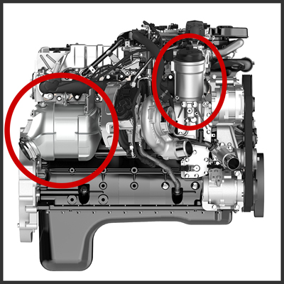

Above: Passenger side of the 6.7-liter Cummins. The DOC is now very
close to the turbocharger’s exhaust flange. Also circled, the easy-to-service
oil filter has a removable cap (28mm hex head) and a drop-in filter.

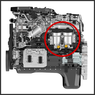

Above: Driver side of the new 6.7-liter Cummins. The fuel filters
are next to each other in the engine compartment. You’ll use the same
28mm hex head socket to remove the fuel filter caps as well as the oil filter cap.

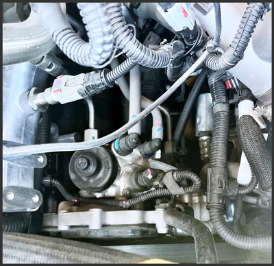

Above: The “isolated loop” fuel lubrication lines (blue “tick-marks”)
are easily identified in the picture of the CP8.

TDR: Now to the question that most diesel owners want to know: What is a Bosch “CP8” fuel injection pump that’s used on the new engine?
Ram/Cummins: We needed much higher fuel pressures for this new fuel system. We moved from 32,000 PSI (2,000 Bar) to 39,000 PSI (2,200 Bar). So, some significant improvements and increases were needed in the fuel injection pump. That’s what made us consider a new fuel pump design.
TDR: The CP8 looks identical to the CP4.2. But it’s different inside?
Ram/Cummins: Correct. While the CP8 may look the same, the internals are different with improved pumping and roller elements along with isolated-loop fuel lubrication. In partnership with Bosch and with Stellantis, this pump has gone through significant testing and vast improvements. We’ve developed new tests that not only helped revalidate the older CP3 that has been used since 2003, but also helped validate the new CP8. The tests are run with out-of-specification conditions to ensure we are validating beyond what coud be seen in application.
TDR: I understand one of the validation tests of the CP8 was called the “Killer Test” where the pump was fed worst-case fuel (with contaminants) under the worst conditions, testing the pump until it failed. Can you elaborate?
Ram/Cummins: The test is run with out-of-specification fuels, out-of-specification fuel temperatures, as well as pump speeds and pressures that are not possible in application. The equivalent of operating for thousands of miles under the most severe temperatures with the poorest of fuel. It was created to ensure that the fuel pump in a Ram would have the robustness and durability that Cummins is known for.
TDR: What re-engineering resulted from this broader, much more intensive validation testing of the CP8?
Ram/Cummins: The Bosch CP8 is a new fuel pump. The roller and shoe design that was in the old pump has been redesigned to a pinned roller-tappet architecture. Another major difference is the lubrication circuit of the CP8. It’s an independent circuit from the one that feeds the injectors. The fuel used for lubrication goes through a filter, then to the pump, lubricates the rotating pump internals, exits the pump and goes back to the tank. The fuel that comes into the pumping elements, feeding the rail and the injectors, is a separate circuit. So, fuel going into the pump no longer runs in series, it runs in parallel.

TDR: Explain the engine-mounted DOC and how the downpipe has changed in 2025.
Ram/Cummins: The exhaust system on the ’25 engine is far different from those used on previous Cummins diesels. We moved the diesel oxidation catalyst (DOC) right up to the turbo, so it lights-off fast and heats up quicker than it would if it were farther downstream (like in the previous engines). That’s better for emissions. Additionally, we went to the close-coupled DOC for better thermal management of the overall after-treatment system. So, to your point, having that catalyst there does give us a better and faster control over the exhaust temperature, which is of course is what’s needed for the diesel particulate filter (DPF) that is a little bit further downstream.
TDR: Explain the changes to the diesel particulate filter (DPF).
Ram/Cummins: I’d say the biggest thing that’s changed on the DPF is that we are now using an external hydrocarbon doser to do the regeneration of the DPF and we’re not as dependent on the upstream components as we once were. So, in that respect, we have the ability to better to improve the soot loading and the soot accumulation on the DPF with this architecture.
TDR: What is the external hydrocarbon doser?
Ram/Cummins: So, during the regeneration cycle we are using a separate nozzle, a seventh injector if you will, that’s spraying diesel fuel in the exhaust stream directly upstream of the DPF to provide the extra fuel for its regeneration. Collectively, putting the DOC closer in the exhaust stream and implementing the doser at the DPF has definitely reduced any DPF clogging concerns.
