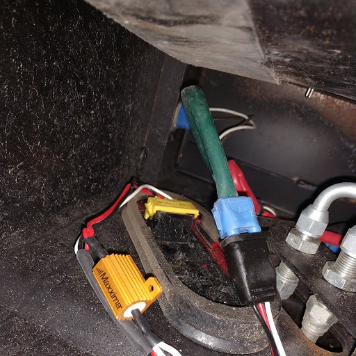

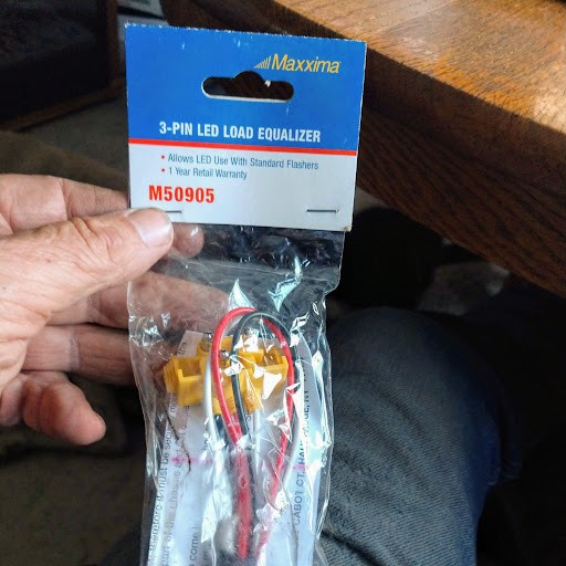

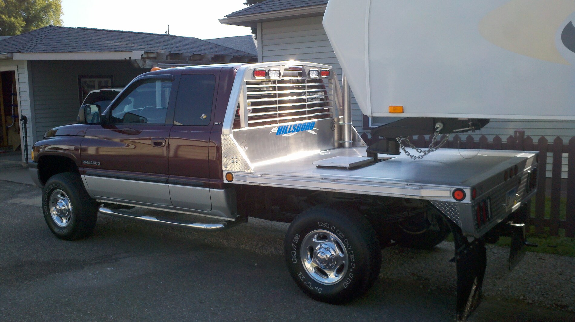

I put a aluminum one on my 02 2500 years ago. When I picked it I bought two resistors from the dealer and put one on each side of the upper front lights. Plug and play. Purpose since the bed had LED's it let's the truck know there are lights back there. No fast blinker lights etc. Hope this will help..
