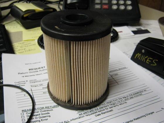

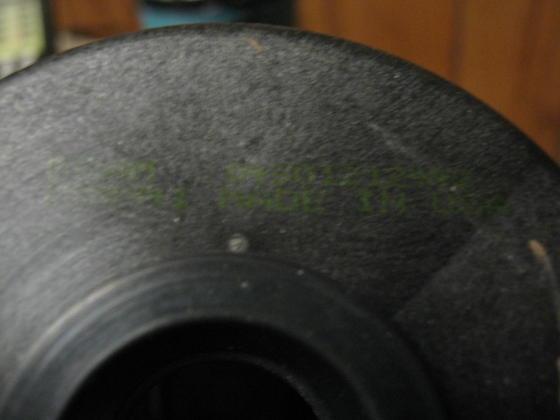

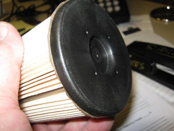

Is this the filter that you seek???
This should bring all of the Fram Filter Haters out but remember..... they bought out LuberFiner filters so those filters have migrated in the Fram line. The last photo does not do a good job of showing what I wanted it to.
It says... Made In USA!!!
Mike. :)
