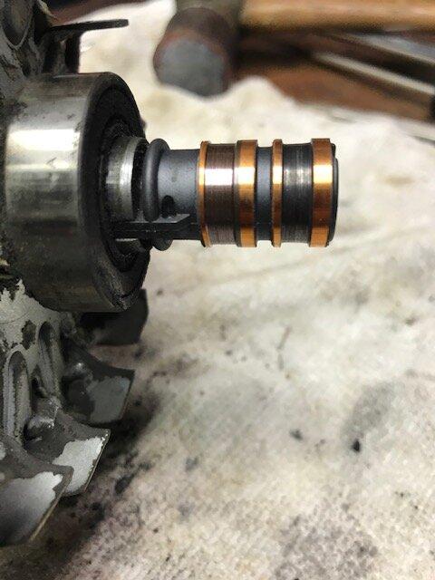

If you can pull alternator and remove brush assy. Look at brushes, worn? Now look at slip ring. is one of them black vs brass looking? Black might be worn down past slip ring conductor and into the nylon/plastic. It's a "unique" slip ring repair procedure if i'm anywhere near close on couch diagnostics.
Again, big SWAG but that's what heppened to my 2005 at about 210K or so. It even tested good but not when it was in truck. ORL reman still cranking it out for me.
