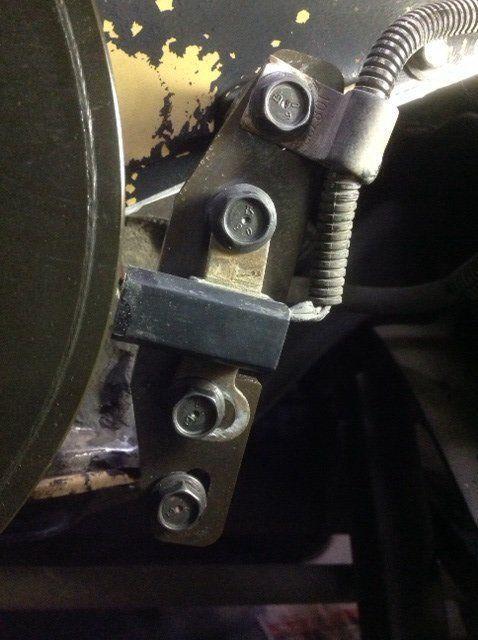

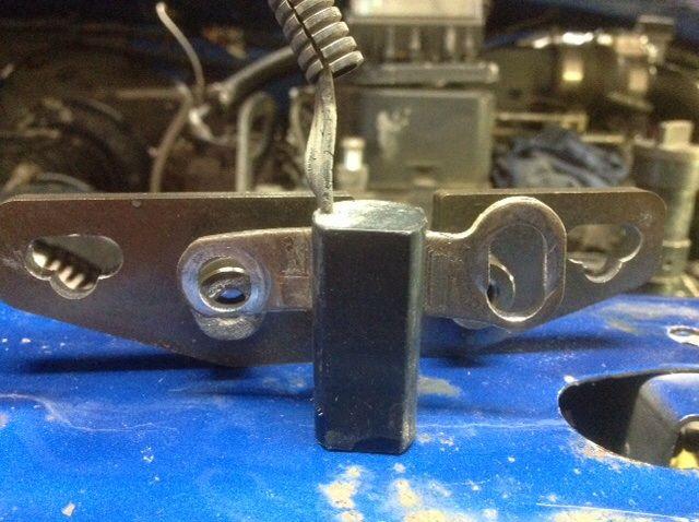

A pic of modified bracket
A pic of sensor installed

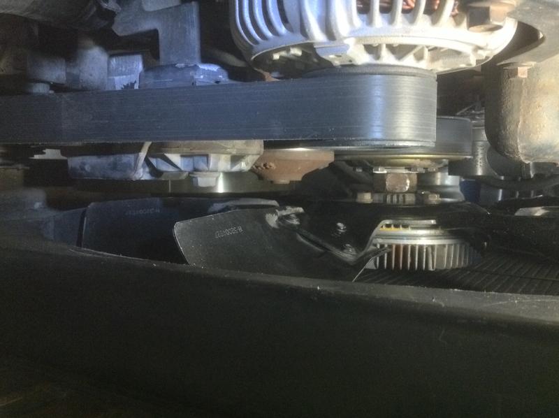

Pic of final fan clearance using washer spacer on hub
