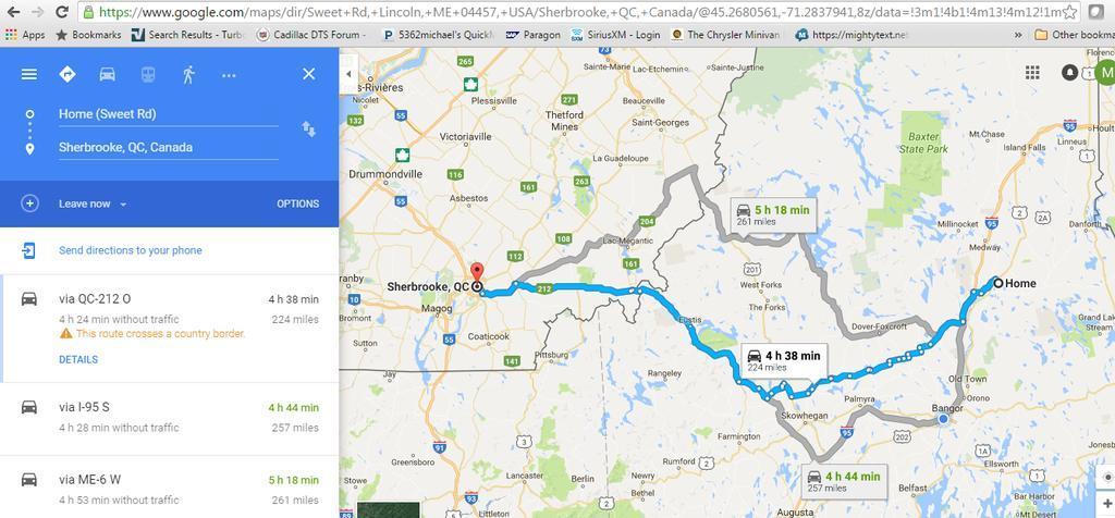

I am kinda' thinking about it, but not if it goes too high. There must be a reserve on it BUT it is a vehicle that only works for a very limited amount of buyers. I can work on it and have many resources, even have a tire department at my disposal.
I kind of like buses instead of motor homes, more truckish to me. And my father is one of the best 2-stroke techs in the state. He may not be strong enough to pull the wrenches anymore but he can sure tell me what to do if needed.
I don't know what the 4 speed would be. In that vintage it is quite possibly a Spicer which could lead to parts problems. Gonna' be a long jump between gears for sure.
The unit is old enough for an easy border crossing, there is an age exemption. I hauled used equipment out of Quebec years ago, that's why I know that.
Gotta' show it to the wife tonight, see if I get a "Cool" or a "Yuck, WTH is wrong with you?".........
