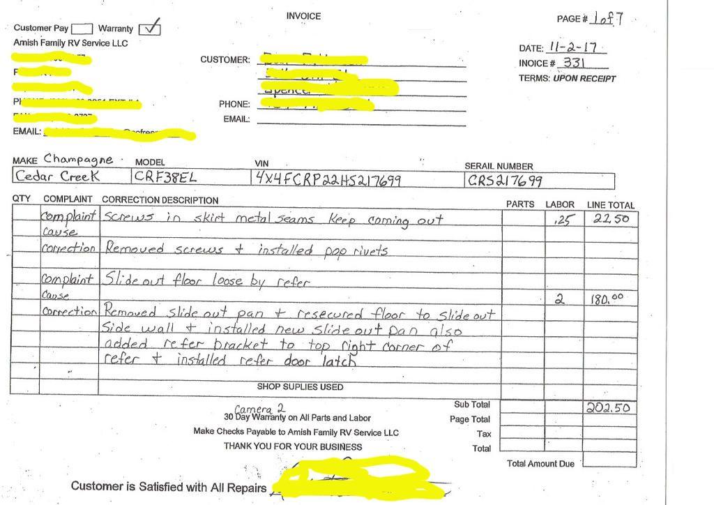

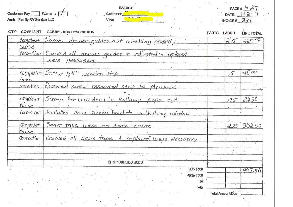

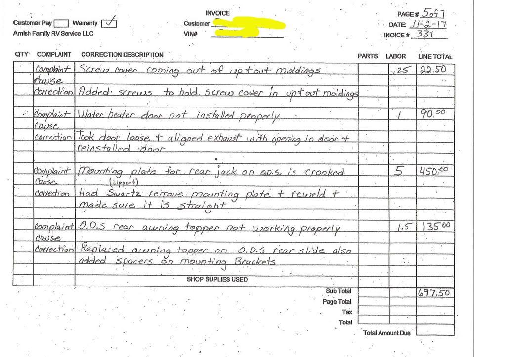

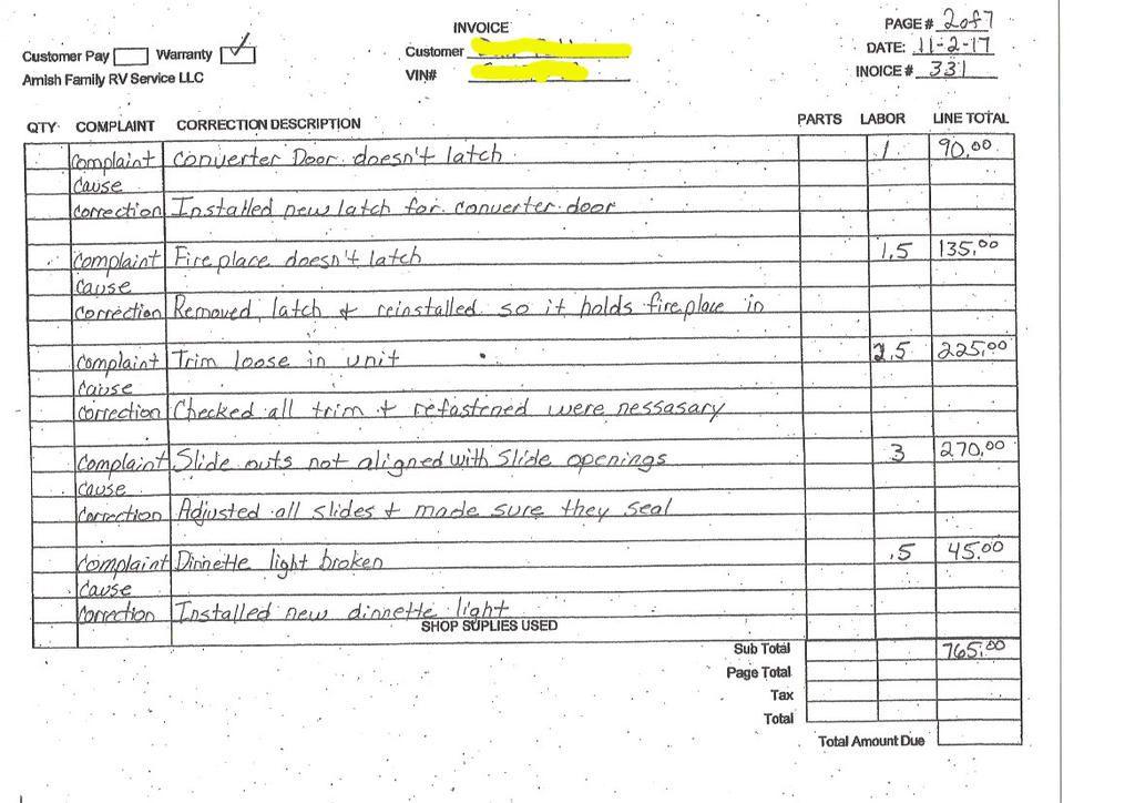

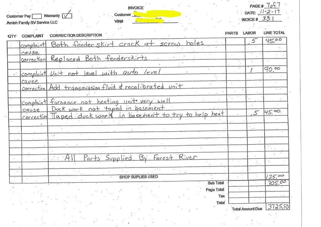

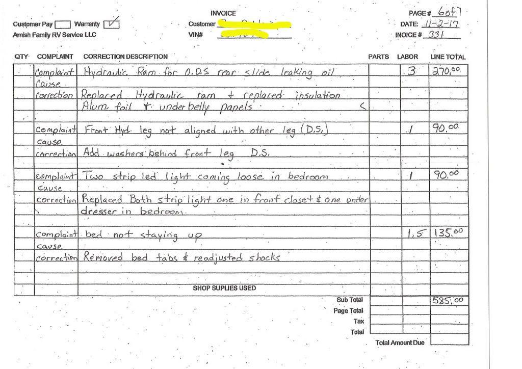

My wife and I purchased a new Forest River Cedar Creek Champagne in January 2017 from Tom Johnson, Camping World. From the first outing in February 2017 we noticed major failures in the level-up system and slides. To make a long story short and even after a personal visit to the factory in Topeka we have come to the conclusion that we will never purchase another FR product. After months of personal visits to Charlotte and calls and emails to the upper folks at FR our conclusion is they don't care. FR or Lippert refused warranty work to be done on the level-up system until I finally convinced them the coach had frame issues. A customer should never have to go through this. Several months ago I was an active member and poster on the "Forest River Forum". After posting info about FR and many other members contacting me privately and also making public posts the ADMIN team finally banned me from the site. Which they had the right to do. I brought attention to the real issues pertaining to FR and the ADMINs did not like it. I violated their policies. ANYWAY, I am attaching several photos of repairs that were finally made at Amish Family RV Repairs in Topeka. By the way I had to tow my coach 800 miles (both ways) to get it repaired and they did a great job. CW, Charlotte had refused to make the repairs. I am sure there are many of you with FR products and are satisfied with your coaches and that is great. Your time is coming. Look closely at the repairs sheet and see if you think these issues should exit on a brand new unit.

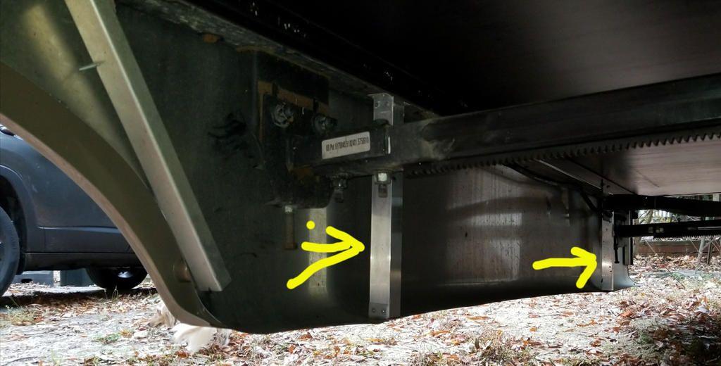

Also notice last photo of underside of rear fenders. They added an aluminum braces to reinforce the floppy fenders.
