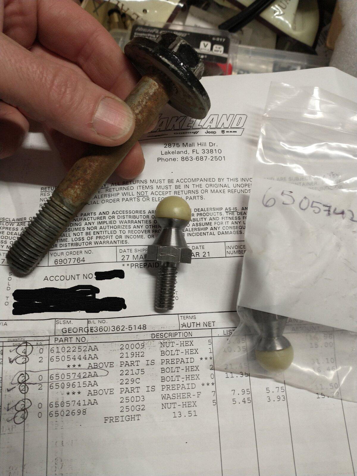

I would think easy to find, but I was wrong. First find was actually on EBay, and when those arrived they were grade 8.8 bolts, not the 10.9/12.9 per the item description.. so no, I won't be using a much lower strength bolt to hold my front axle to the vehicle! Then I found the OEM parts, except one bolt was inexplicably not listed on the Mopar site, so I ordered what I could and with the size, type, grade, went to bolt depot, and McMaster Carr to get the other one, and even found one on Amazon.. then another kit billed as grade 12.9, so decided to order that too.. at this point I just want to get this thing back on the road and not sure when I'll get all the proper parts I went parts shotgun mode!
Well turns out the OEM bolts arrived, and the one especially critical cam bolt was not in the box, but some odd other thing was, and the supplier was slow to respond, and finally after a week seems to have sent the proper bolts, and in the meantime another supplier has a pair I'm suppose to get tomorrow.. so at the end of all of this I will have a bunch of extra bolts.... but I digress.

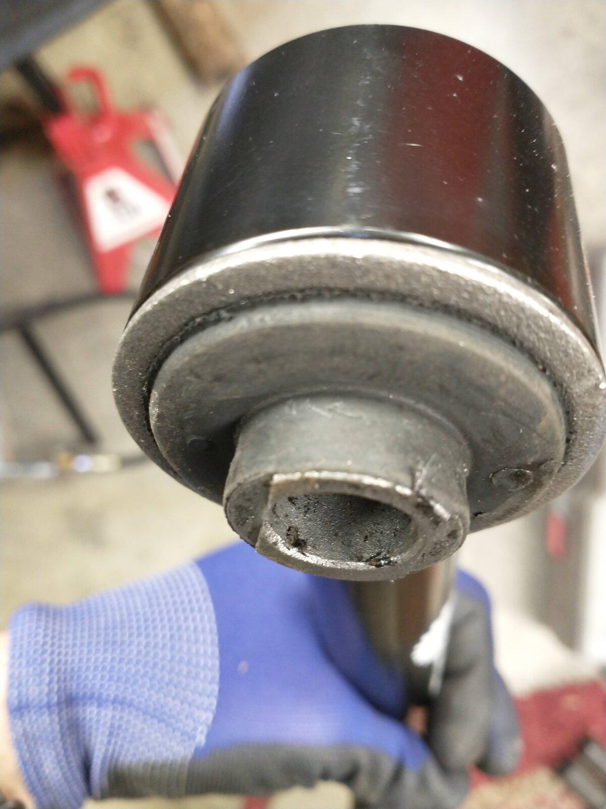

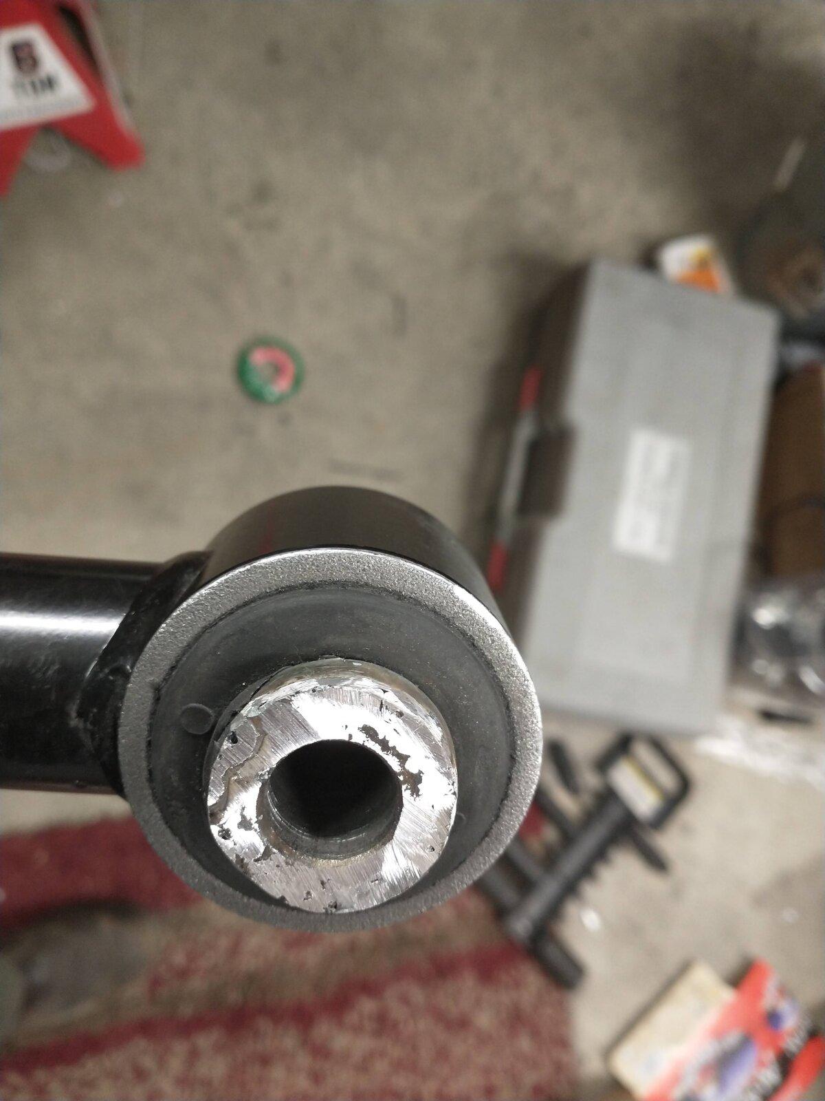

The main point of this is to point out an issue I found doing this job. I'm using aftermarket longer control arms, these are Freedom Offroad brand I found on Amazon, they appear to be good quality.

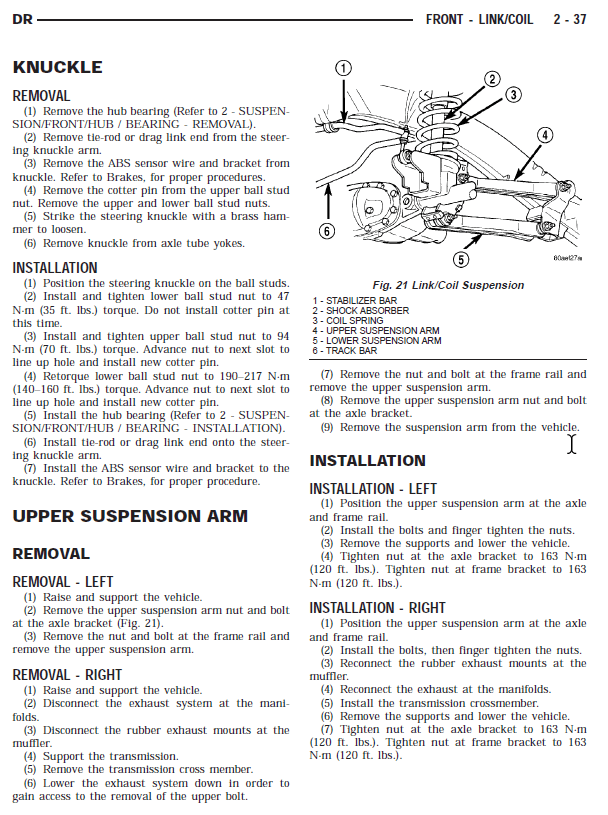

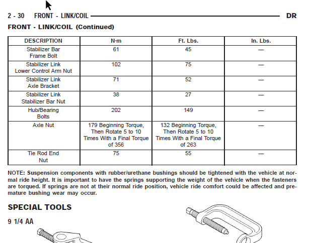

Well when I went to torque these, the service manual has some contradictory specifications. In the Torque specification table it has these torqued to 200 ft-lbs. On the page to re-install it has the rear/frame side at 170 ft-lbs, and the cam bolt at 140 ft-lbs. The uppers are all 120 ft-lbs. Uppers have 14mm bolts, the lowers are 16mm.

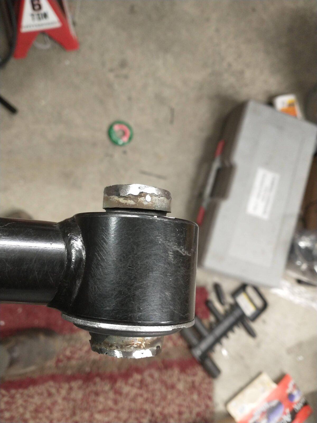

Anyhow, I was trying to split the difference so to speak an go with about 170 ft-lbs, but on the cam bolts (for now using original, while waiting for new to arrive). I could not get to 170 ft-lbs, I think I got to about 130 or so.. and it kept turning... finally I stopped thinking something is not right.. and instinct was correct.

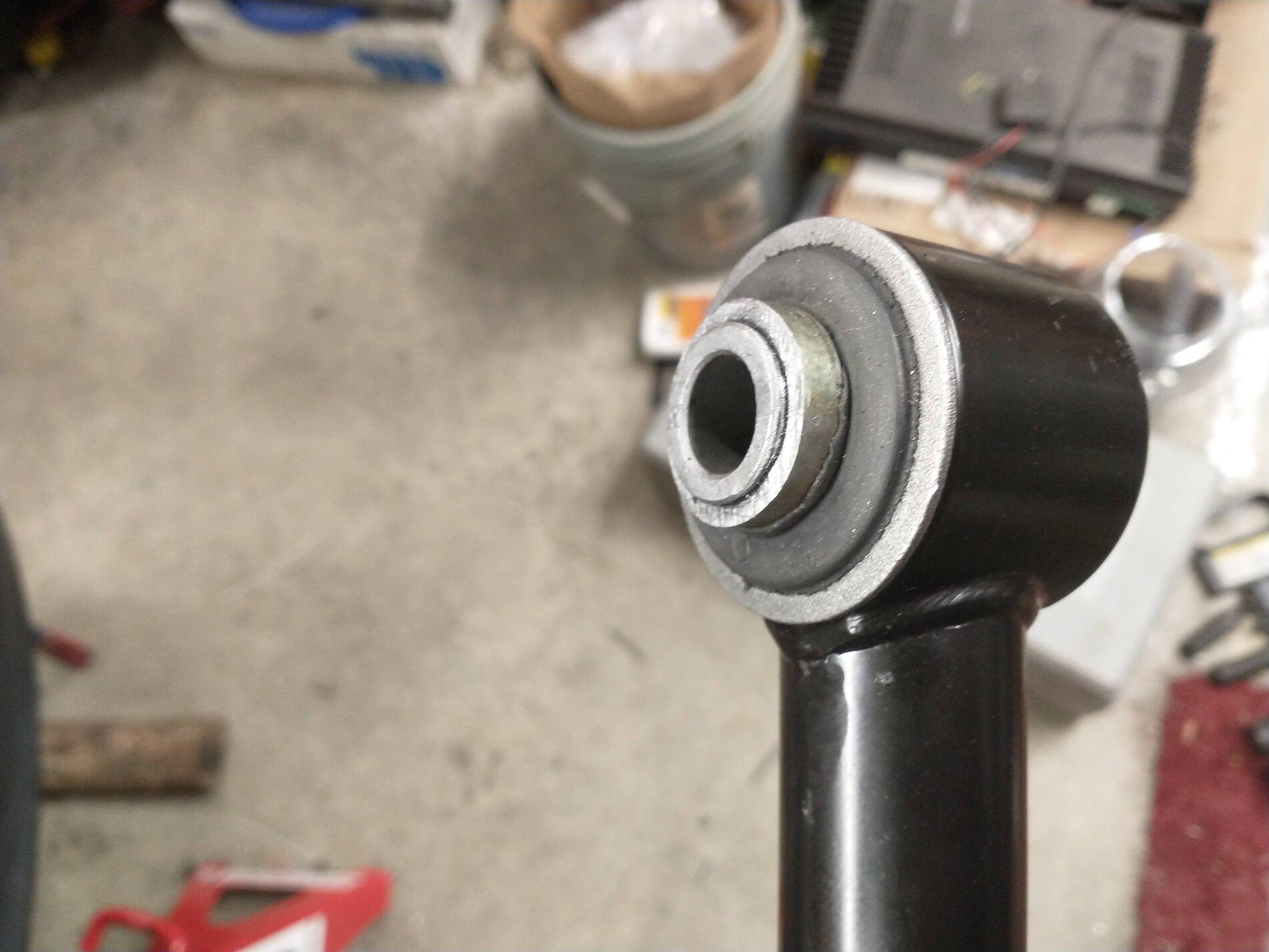

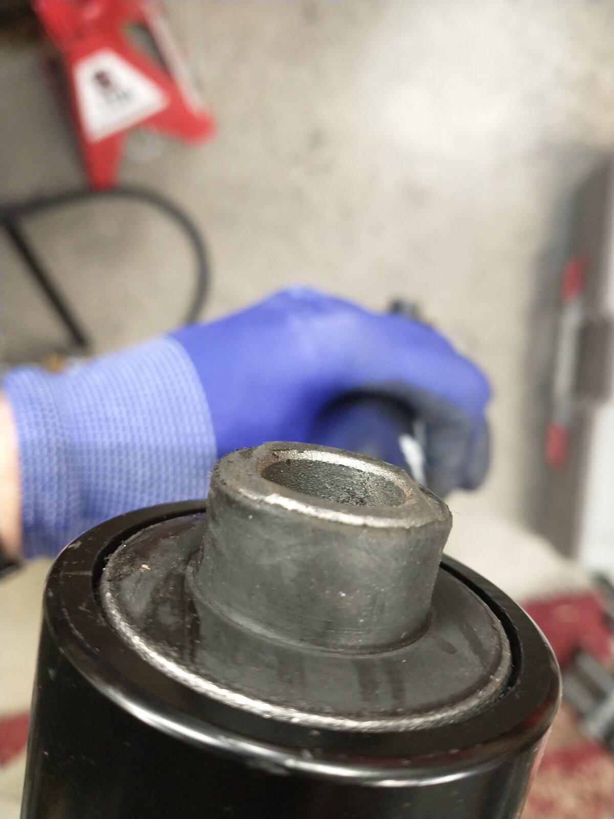

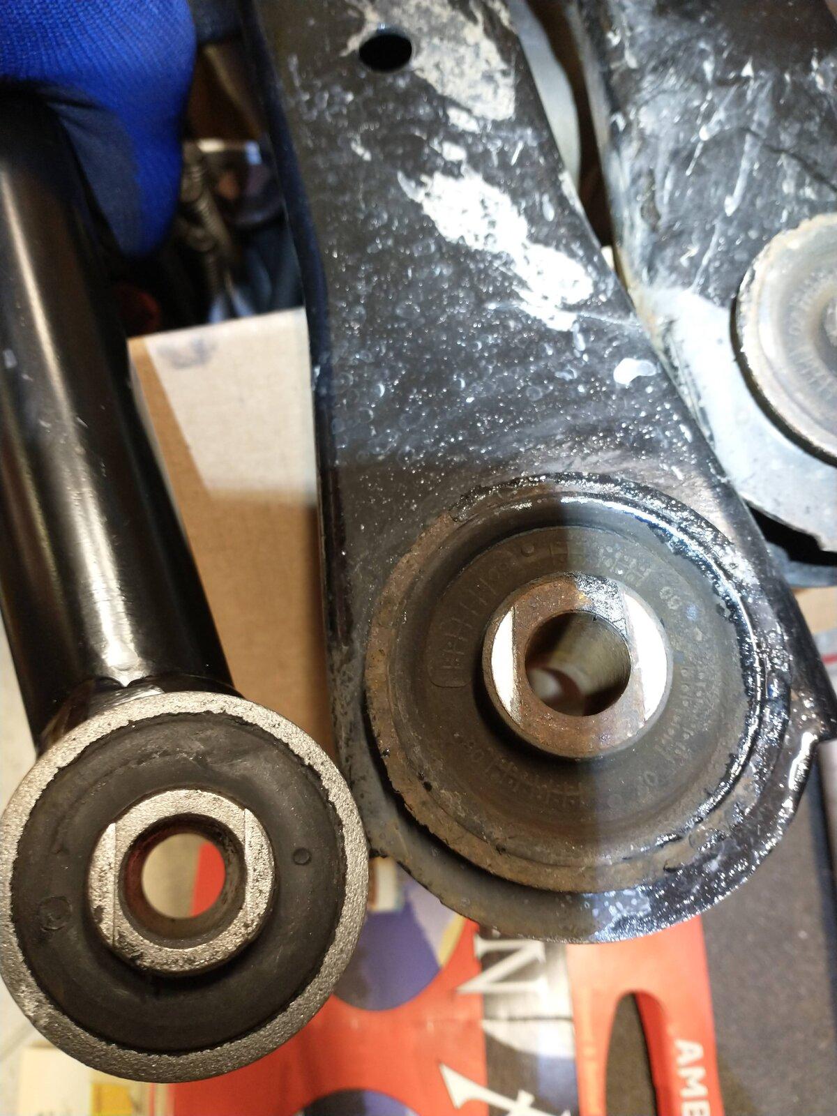

The new control arms have much smaller bushing in the rubber mount, and as a result, less metal contact area to the frame elongated hole where these mount. The torque was sufficient to deform the busing and thus unable to attain the proper torque specification (well assuming it's 200, but if it's 140, it will be close).
I'm attaching some pictures, for some laughs the wrong part recieved compared to the old cam bolt, then 3 of the control arms, one showing the original compared to the new, and the last 2 the deformation of the bushing from torque attempt.

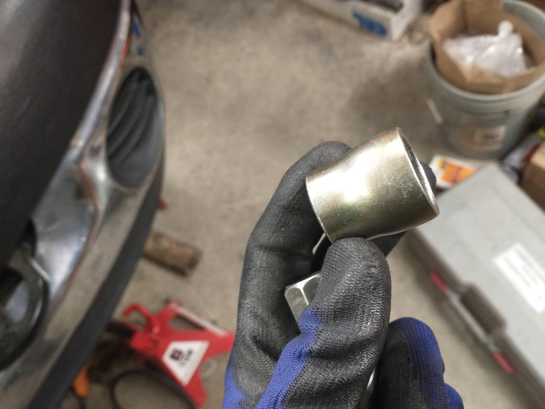

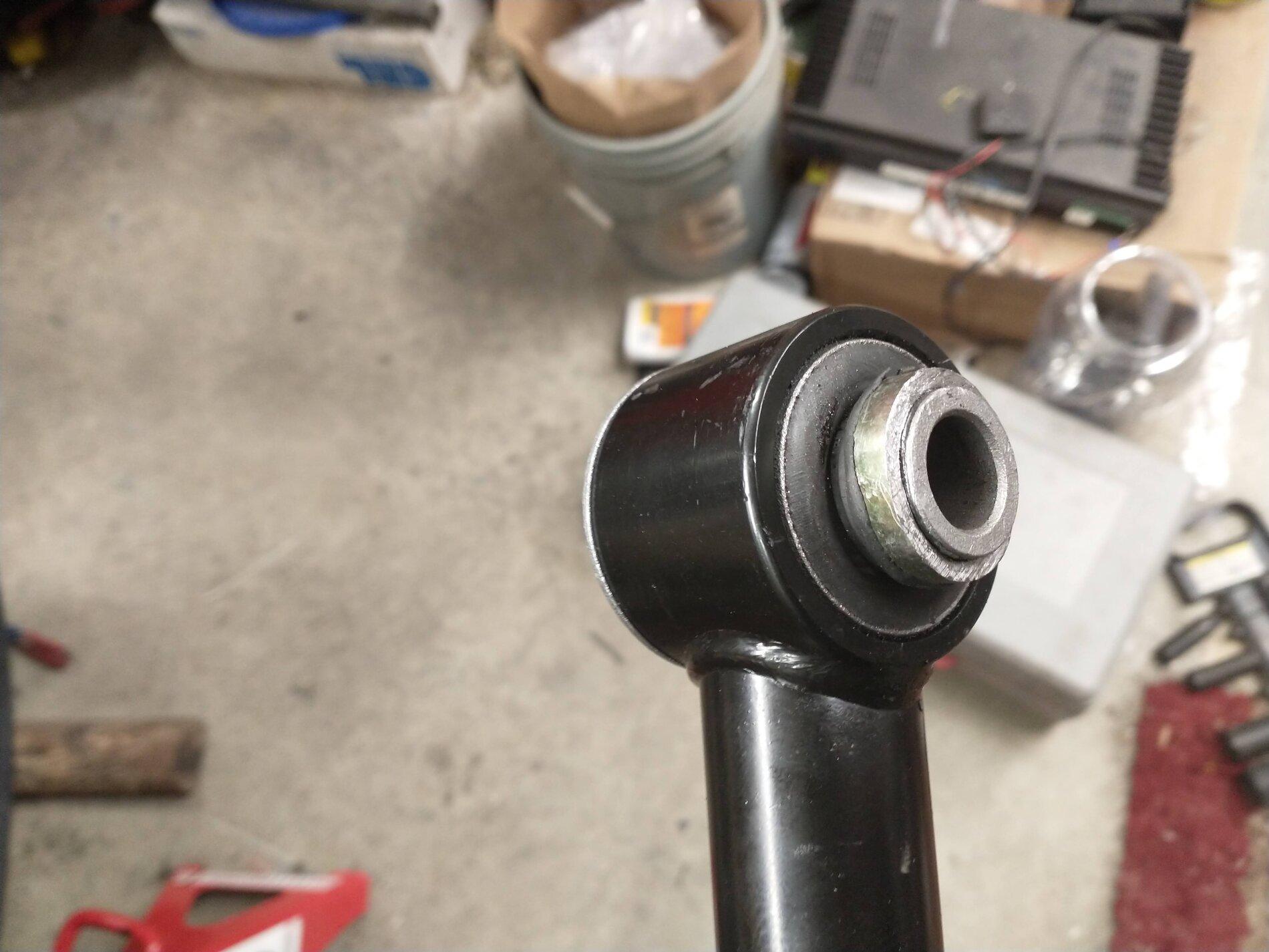

If I had time, I'd go for a refund on the control arms and seek a higher quality option.. but I'm out of time, so I did a fix that should make them OK to use. It's not something anyone should have to do.. Pictures in next post. Oh, and I did write an appropriate review on Amazon for the lower control arms, including pictures of the issue. I feel it's good to let people have such information when making a purchase decision, I know I often benefit from other people's reviews, so when I can I contribute to the pool of knowledge.
One side upgraded. I took a piece of tube and formed it in my press to the diameter of the bushing, then pressed a section of that tube on to the ends of the control arm bushing. Then did a slow weld build up (slow to not damage the rubber). Then a final grind to flush and now have a larger area to take the load when torqued, and it did take the 140 ft lbs without issue, but I don't think it will take 200 ft-lbs, I'm still not sure which part of the service manual is correct. Anyhow, pictures of my upgrade. I'll do the other side tonight, and I should have the proper OEM Cam bolts today.

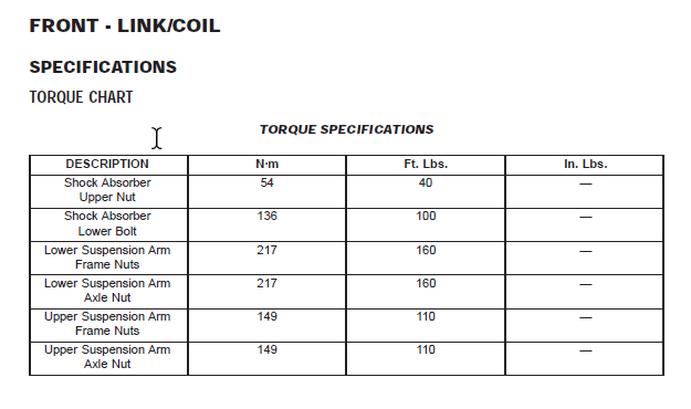

I would appreciate any insight on the torque specifications, if anyone has it, which is correct? Cam Bolt 140 ft-lbs, frame 170 ft-lbs, or both 200 ft-lbs?
From the 2004 DR manual... I think all 3rd gens were the same in this area...
Thanks! Apparently it's all over the place. The 2009 manual in the install procedure says the 170/140 for the lower control arms, the table says 200.. and your manual has all new numbers! Also, mine says 120 for the uppers, yours says 110. It's interesting the variance on values on the same basically same hardware items.. makes me wonder what caused them to change these numbers around.
M16x2 10.9 bolt has a maximum torque rating of either 202 or 247 lb ft dry and oiled, respectively. This is based on 85% of proof load according to my Engineering toolbox fastener torque sheet. So I would say you are well within your limits as far as fastener strength.

Thanks, but having it be 200, when the max for that bolt is 202, is definitely justification for bolt replacement, how accurate is the typical shop torque wrench? I know several of mine are not that consistent when checked against a digital, and I still have some deflection type because they are consistent, but none that go over 140 ft-lbs.
It's odd that there are so many different specifications out there, and the price arms linked above have in their instructions to torque the lowers, both sides, to 215 ft-lbs, which is more than the maximum..
Thanks, but having it be 200, when the max for that bolt is 202, is definitely justification for bolt replacement.
Not arguing or disagreeing with you, just pointing out the fastener itself is rated for all the torque specs you posted.
Keep in mind proof load is not the same as yield strength, proof load refers to the tension of a bolt in terms of clamping force, yield strength is the point of no return of a bolt so to speak where it stretches or permanently deforms or breaks. Torquing to a fasteners proof load is not the same as torquing right up to a fasteners limits (yield strength). I gave the proof load of an M16.

I wonder if the different torque specs across the years have anything to do with different thread pitches. M16 x 2, M16 x 1.75 or 1.5.....etc. etc.

It's all a good discussion... as to the specs, that was a standard M16-2.00 Grade 10.9 bolt, correct? Well as Ozy pointed out, that cam bolt has about 25% less thread contact in the nut, due to its design.. Seems like pushing the limits by stress on the threads might be a factor there at 200 ft-lbs, and I do wonder if that was driven by some other issue (or it's just an error in the manual).. seems something was driving the changes in the torque specs. I also noted the new OEM long/frame bolts for the upper control arms were not necked down like the 2009 original bolts were, I wonder what drove that update to that part. Generally there is an engineering reason for a change, though not always.
So I did 170 ft-lbs on the frame side, and it came up to spec and stayed. I did 140 ft-lbs on the cam bolts, initially and it was slow going to get there. A day later, when I got the new digital torque tool ( I don't trust click style torque wrenches). I verified, and the frame side was solid, did not move. The cam bolt.. yep it would not even take 140 ft-lbs before it started to rotate.. arrghh.. locked it down and re-torqued to 150 ft-lbs and got there.. and I don't want to check again, as I'm guessing it will go back down. It's quite bizzare actually. As a just in case I applied some green, penetrant type loctite to the cam bolt washers and enough is a enough.. it's out of the garage and seems to be doing fine. I guess my marks for the cam bolts was pretty good, steering is centered, and it's tracking perfectly, so looks like I won't need an alignment.
Then I realized I have a Chilton Manual. I thought.. hmmm wonder what it has for the lower control arm torque specifications.. and it has 200 ft-lbs for both sides. NO WAY can I get 200 on that cam bolt, 150 will have to do. It has been an interesting experience for sure. So far seems to be working fine, I've been sure to hit a few bumps in the road, just to make sure it wasn't going to shift.. so far, so good.
