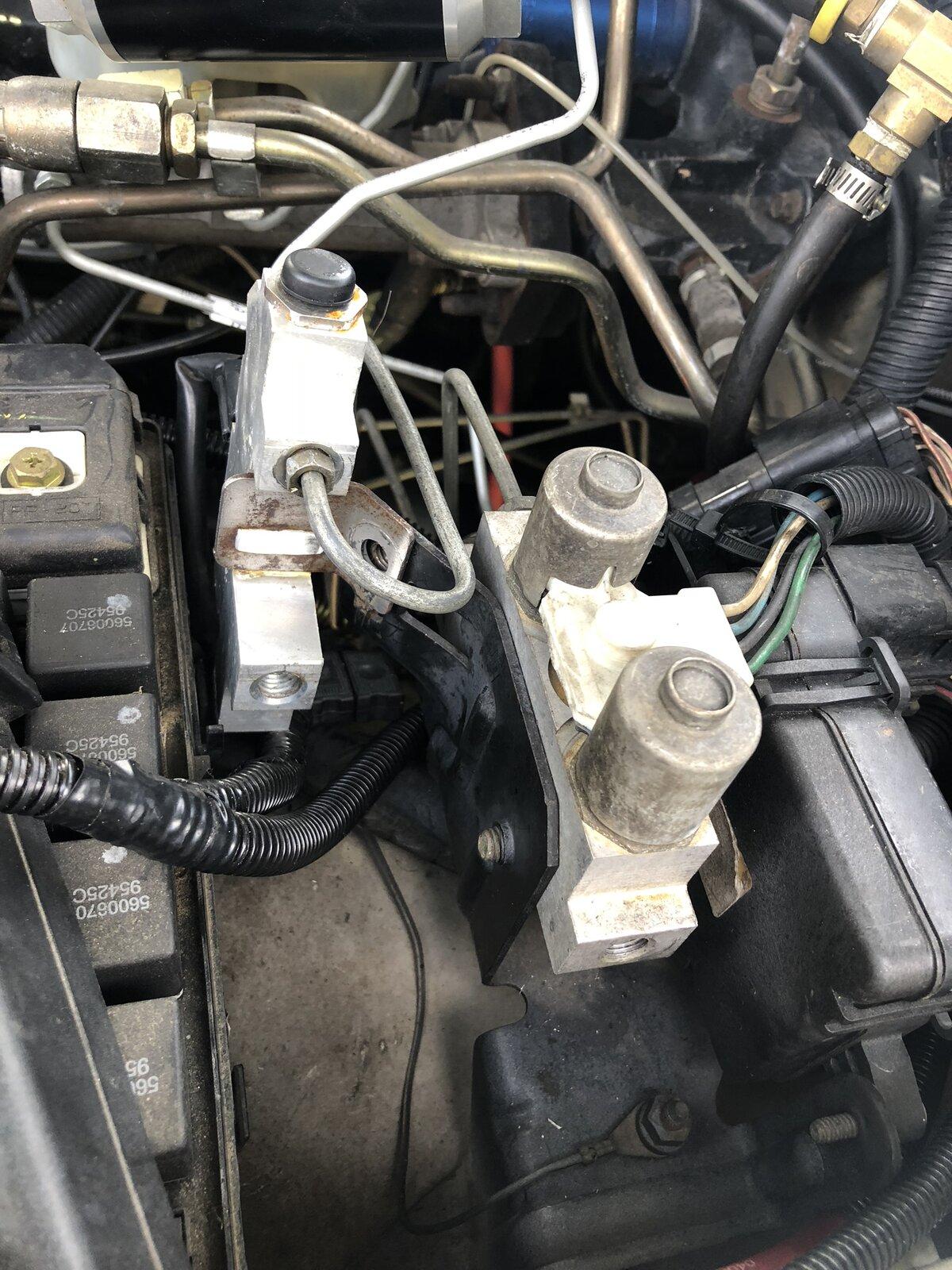

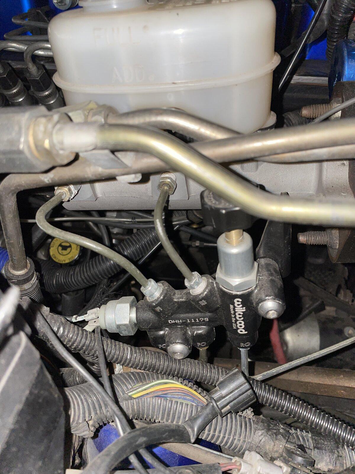

1- It appears that the front left caliper is doing all the work (at the front) Duh, right... Weird set up for the front lines. You replaced "all lines", I believe the line from the block in the left wheelhouse area runs 1-to the left and 2- to the right side along the firewall behind the engine (could be wrong and my truck is in the body shop now) if you replaced this line, or not, is it possible it is/got kinked?

Thoughts: Either the left front caliper isn't releasing all the way or the right front isn't applying. The dilemma is figuring out why? No fluid getting to right, too much to the left, stuck caliper (on one of the slides), kinked line, failed hose, restriction between left and right?
