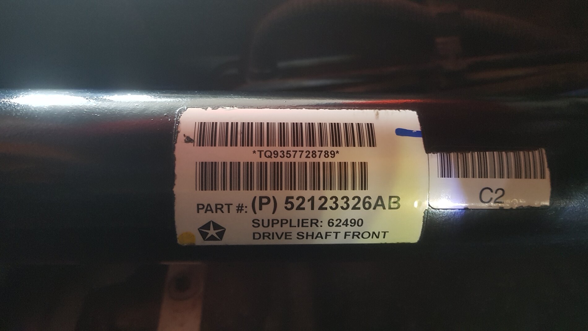

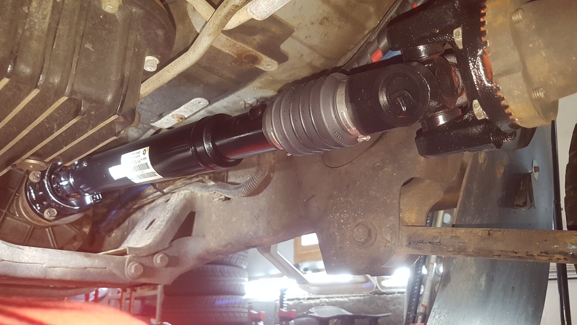

Let me find my partnumber, I got a brand new MOPAR...
This is the latest revision >>>52123326AD
I got this after wasting money for u-joints at the factory unit to no avail.
Then found out that the new one is much beefier then the old and the price is right.
It comes bare metal, I spray painted it black.
Of course direct fit, this partnumber is the one that fits your and my truck no matter how long it is.
Google around I've seen it today for shy above 500$ - the latest revision with D at the end.
I think I paid something about 450$ a couple years ago.
