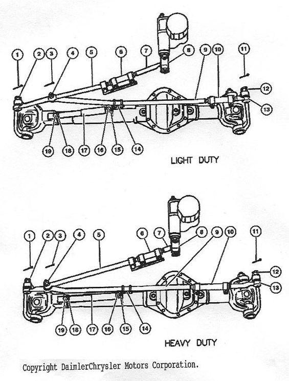

Years ago, like others, I've converted mine to the HD steering set up (wich you can find for 98-99 models, see diagram) with parts from NAPA.
The picture shows you the part numbers from NAPA. Mine is a 97. Don't know for sure if it fits on yours.

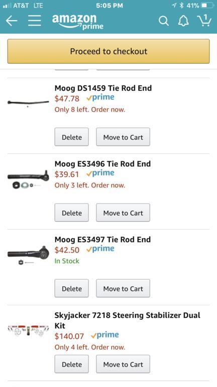

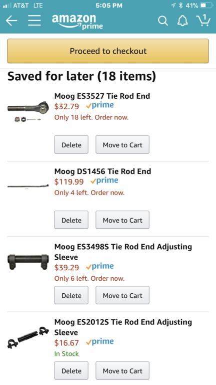

The track bar and steering stabilizer can be bought at Genos. Here’s my list on Amazon for the final HD steering upgrade I plan on doing. It’s a lot of money I know but you won’t be disappointed. I did mine in steps and the track bar seemed to work the best. The only thing I haven’t done is the steering shaft/steering gear upgrade. My truck is WAY less stressful to drive on twisty mountain roads.

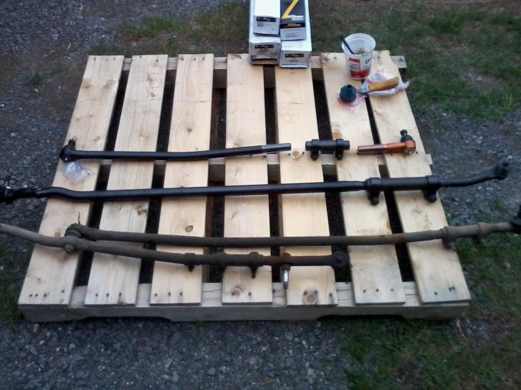

This is what you get with the HD set up. It's perhaps not so obvious on the pics but the parts seem much stronger than the original set up. There is no provision for the steering damper with my MY or you have to go custom or after market, but it's perhaps different for 2000 to 2002 MY. I did not go that course since I did not notice such a difference with or without the steering damper.
Like I said parts were coming from NAPA, they were not the cheapest but not the more expensive. I swapped in 2013 and they seem to hold well, but I grease them at each and between oil changes...
