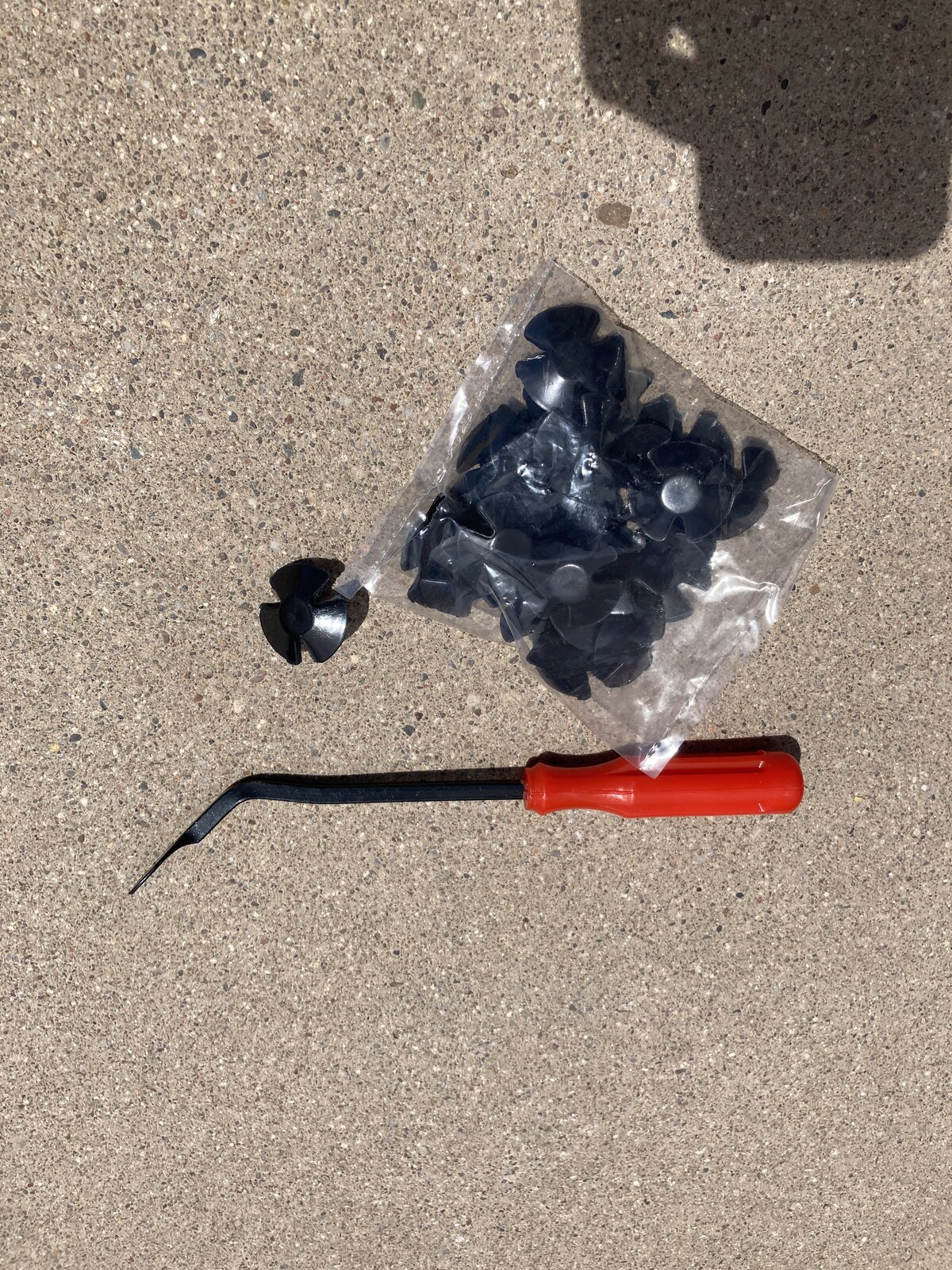

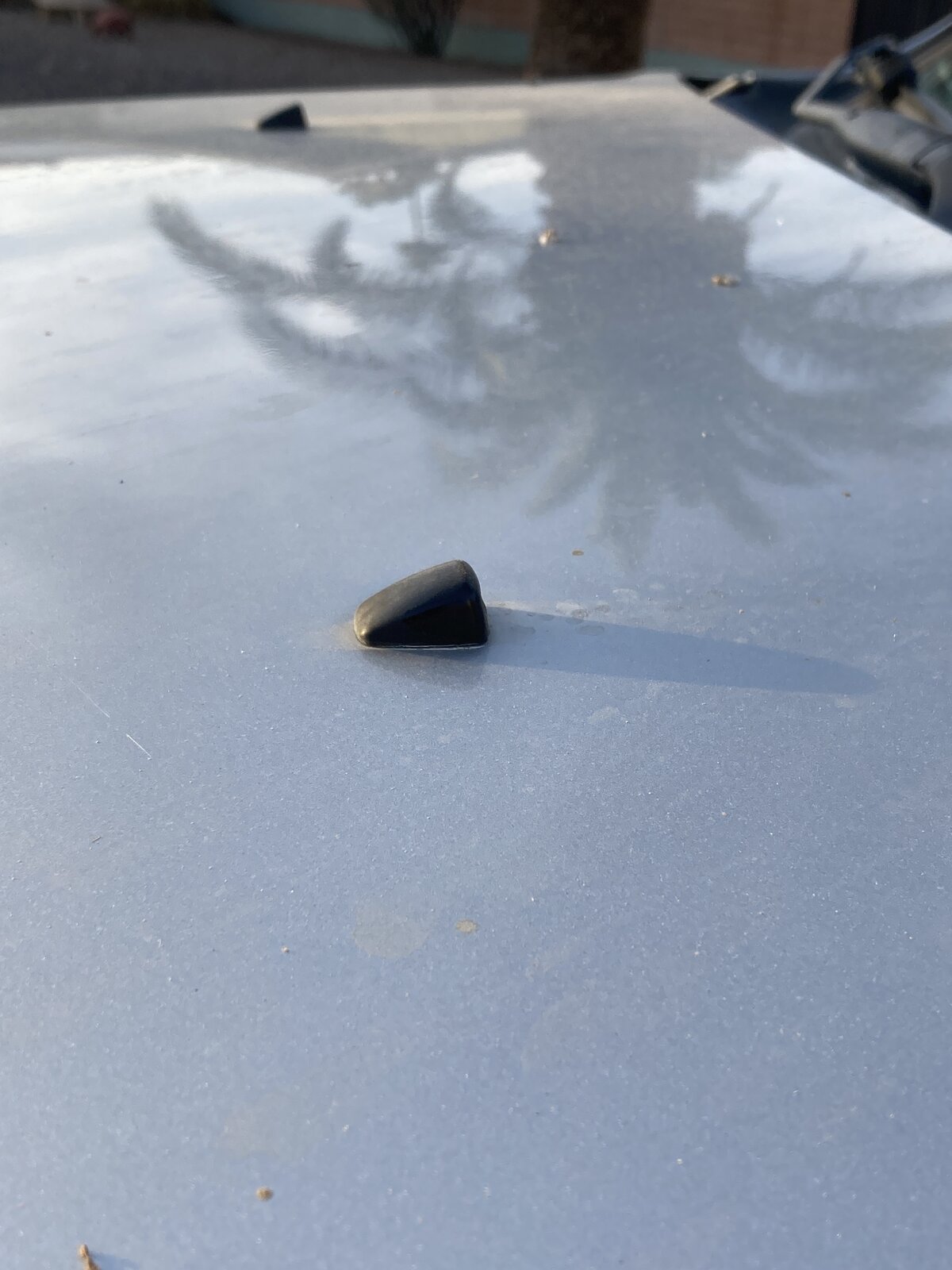

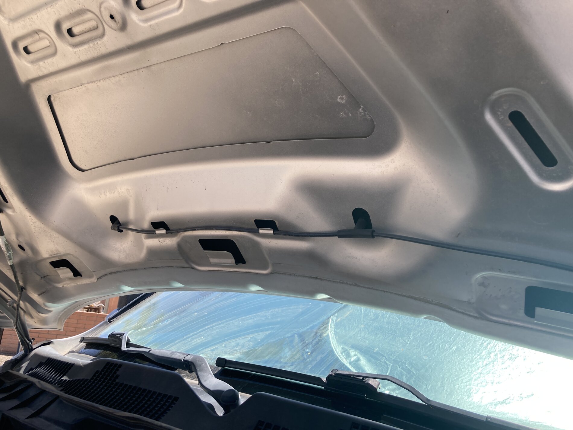

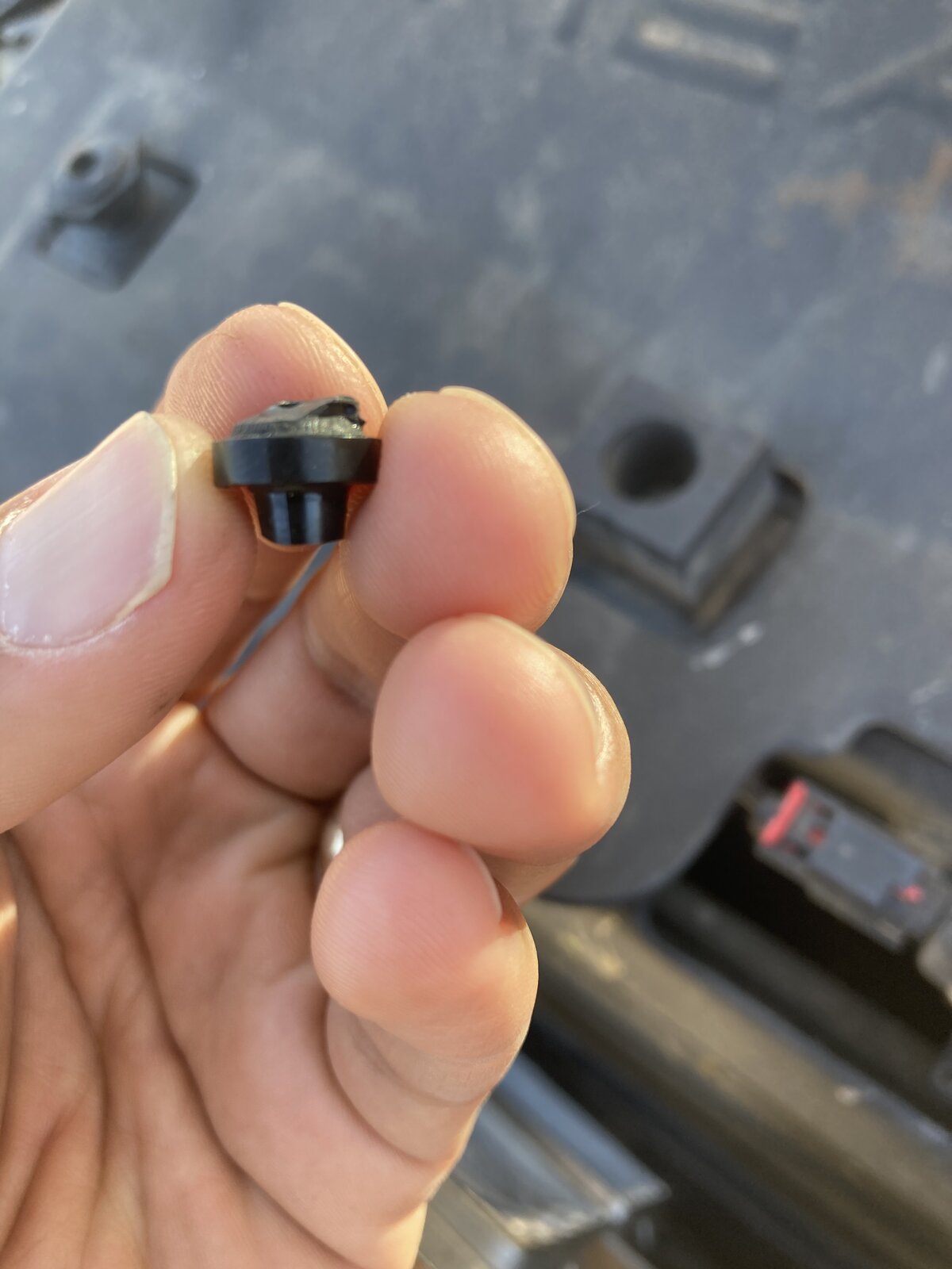

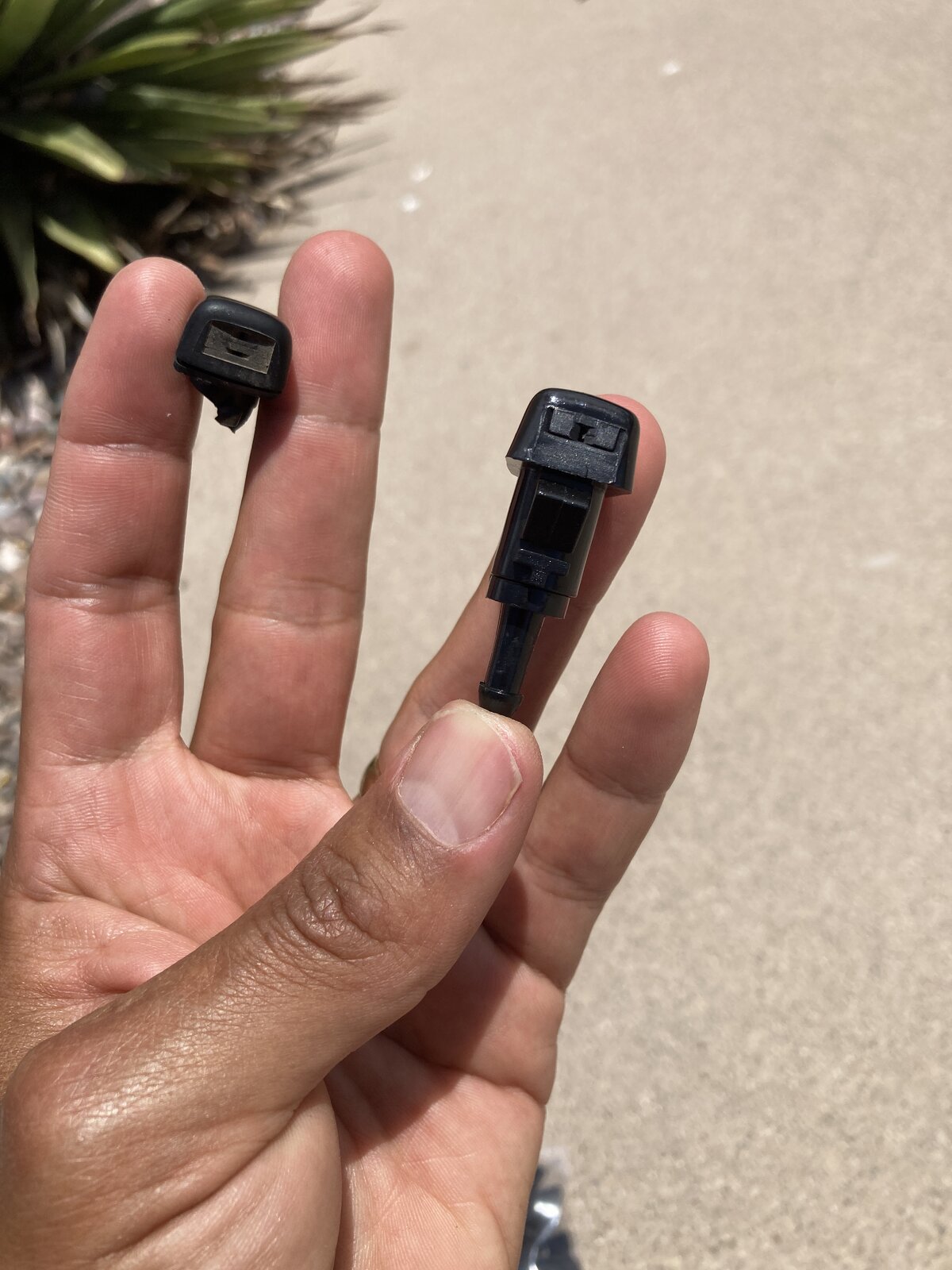

I got the hood insulation cover off. Used the special tool, but only 1 of the 6 clips are reusable. Plan on just replacing all of them if you decide pulling them out. Found my windshield washer tip problem, broken connection. part of the barb broke off in the connector. Using a screw I was able to get most of it out then ran some fluid to wash out plastic debris. Order replacement spray tips. Not sure how to get the hood tip out as it has good size clip. I will take a look at the replacement to see how it works. May need to break the plastic tip off.
I will give it a shot when the tips come in. The tabs are not easy to get to from under the hood. Need some long 90deg tipped needle nose pliers.

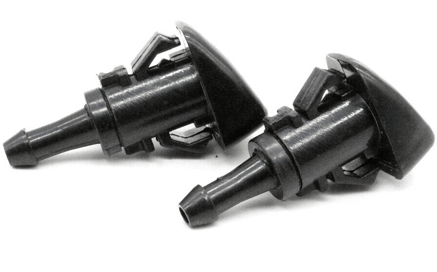

No luck salvaging the spray nozzle. Took a pair of pliers and crunched the bottom half then crunched the spray head and out it came. Replacement pops in easy. Connected the hose and back in business. Replacement head sprays better than the other original head. I was thinking of replacing both but since i would need to break the other off I decided to leave it for now. Below is a link to the parts I bought. The hood tab pack came in 30pack so now have plenty extra for next time. The tab quality aren’t as good as the original ones but connection feels solid.
