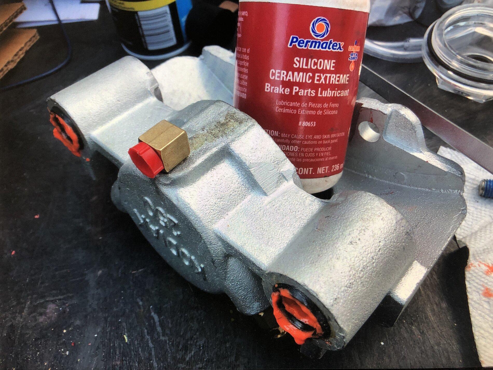

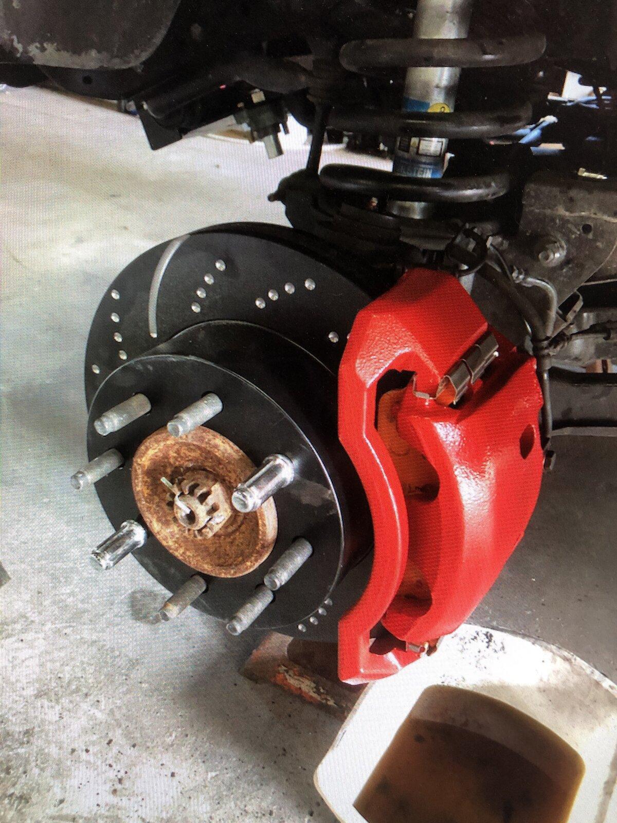

I am beyond happy with this setup. I really like the lube in the second pic. PowerStop Cradles and Calipers. EBC Pads and Rotors.
PetersonJ thanks for the help on the combination valve, and Cummins nice brakes and I'll check out that lube
