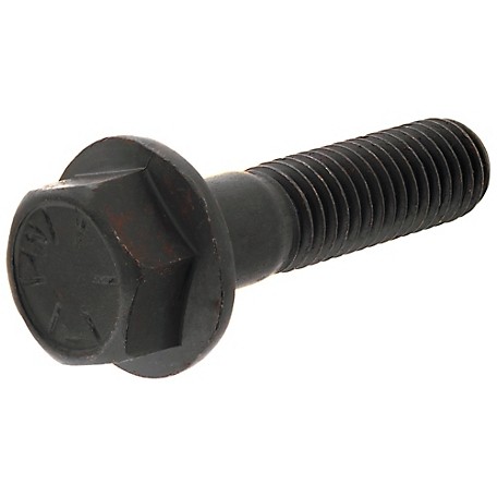

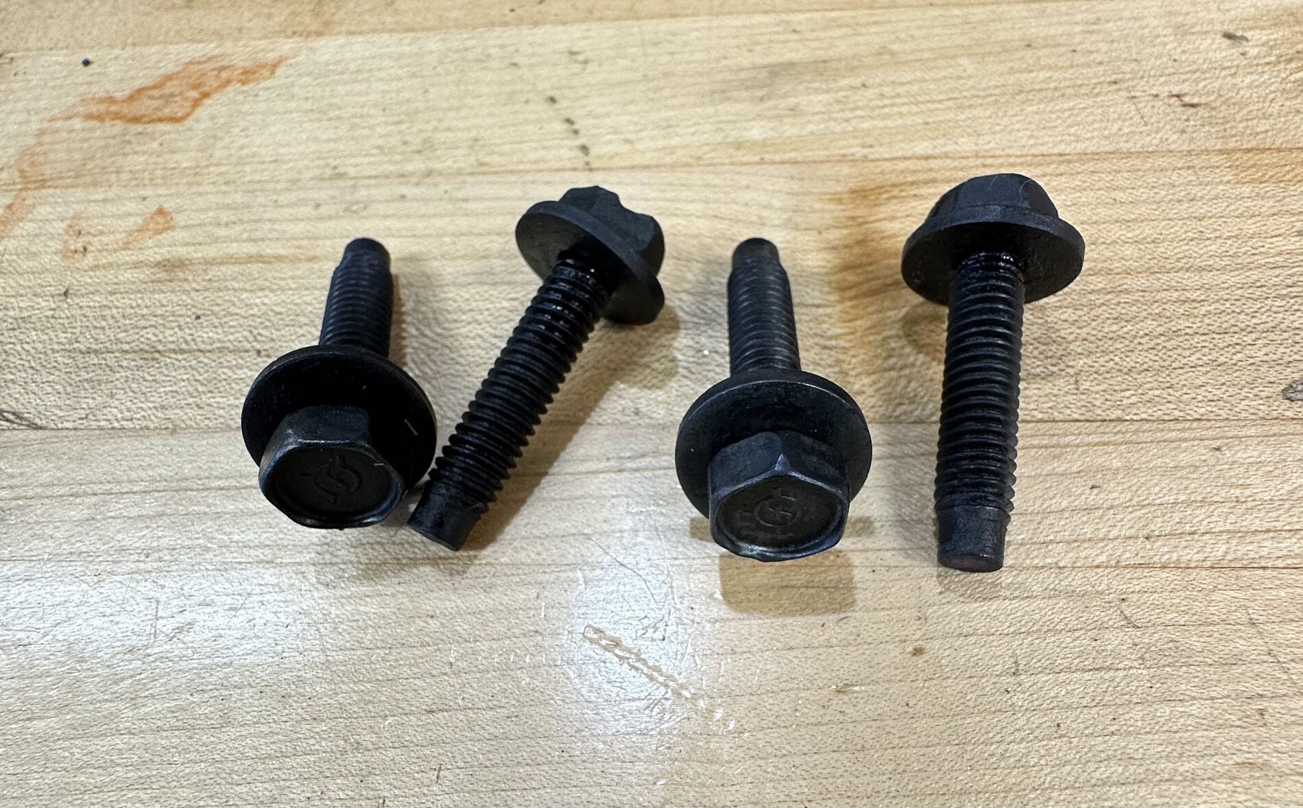

Thanks! Now that I know the right size this should be easier! For what it's worth I used an old trick of heating the original bolts (not too hot!) and dipping them in old motor oil. Puts a black oxide finish which isn't "forever" but at least they look better. lol

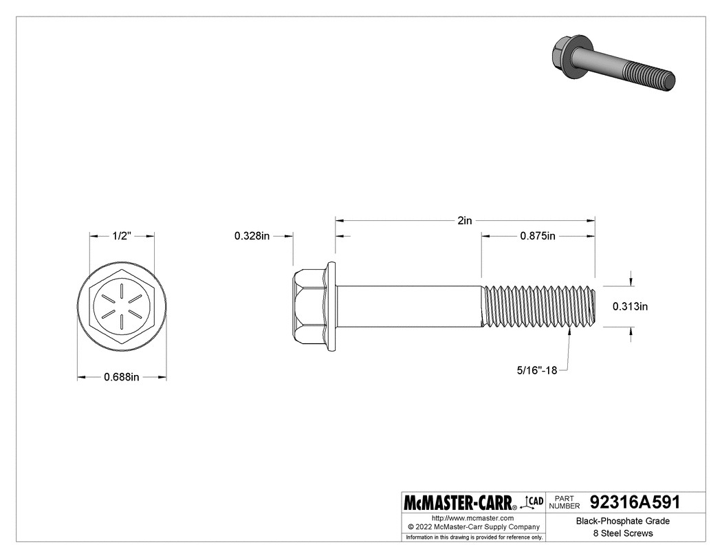

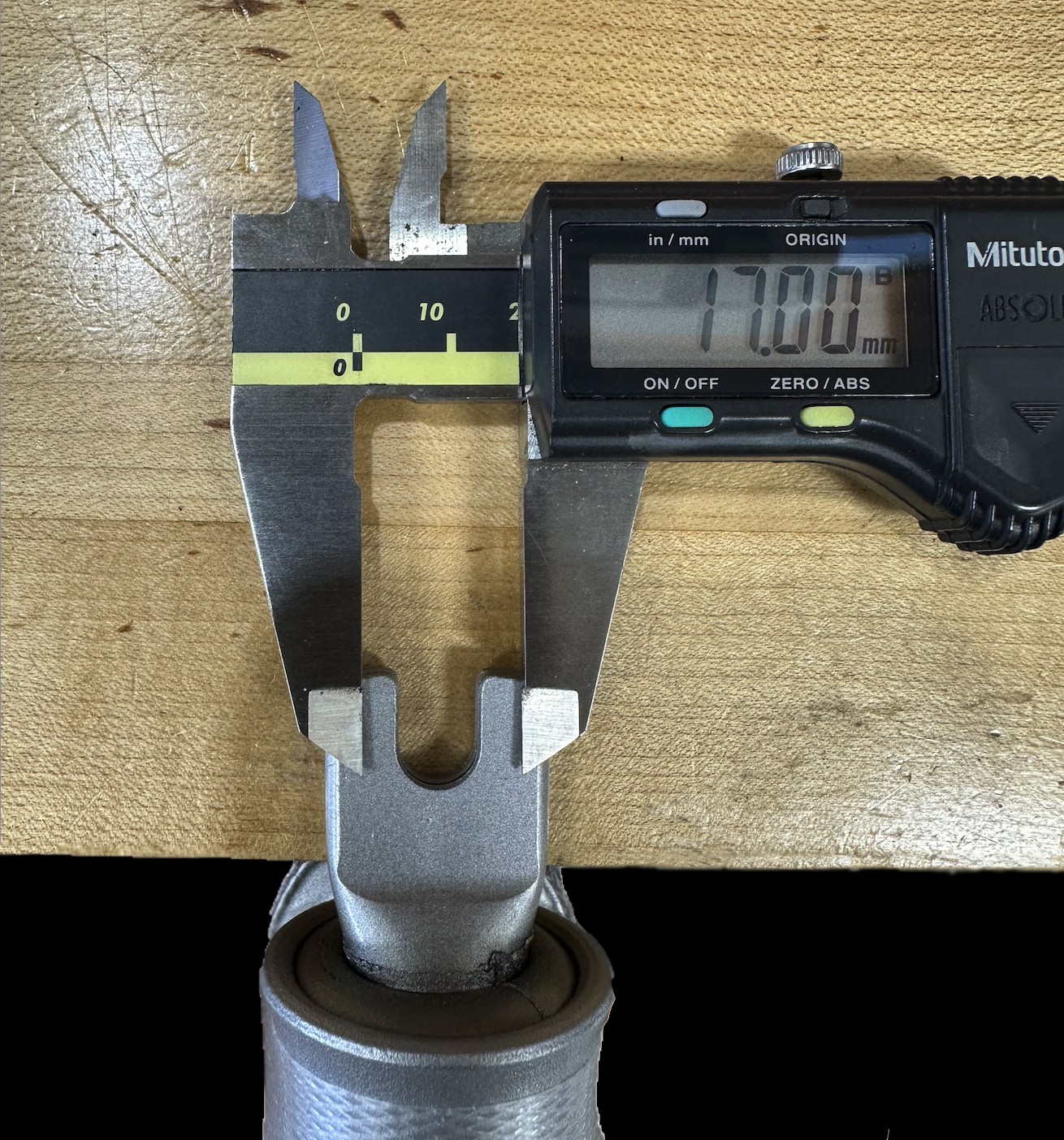

Did a partial thread allow enough purchase on the captive nut? I'm going to measure this because the McMaster-Carr 2" flange bolt is partially threaded and the flange is around 17mm. The original captive washer is about 19mm. The photo illustrates plenty over coverage.
That's absolutely good to go.

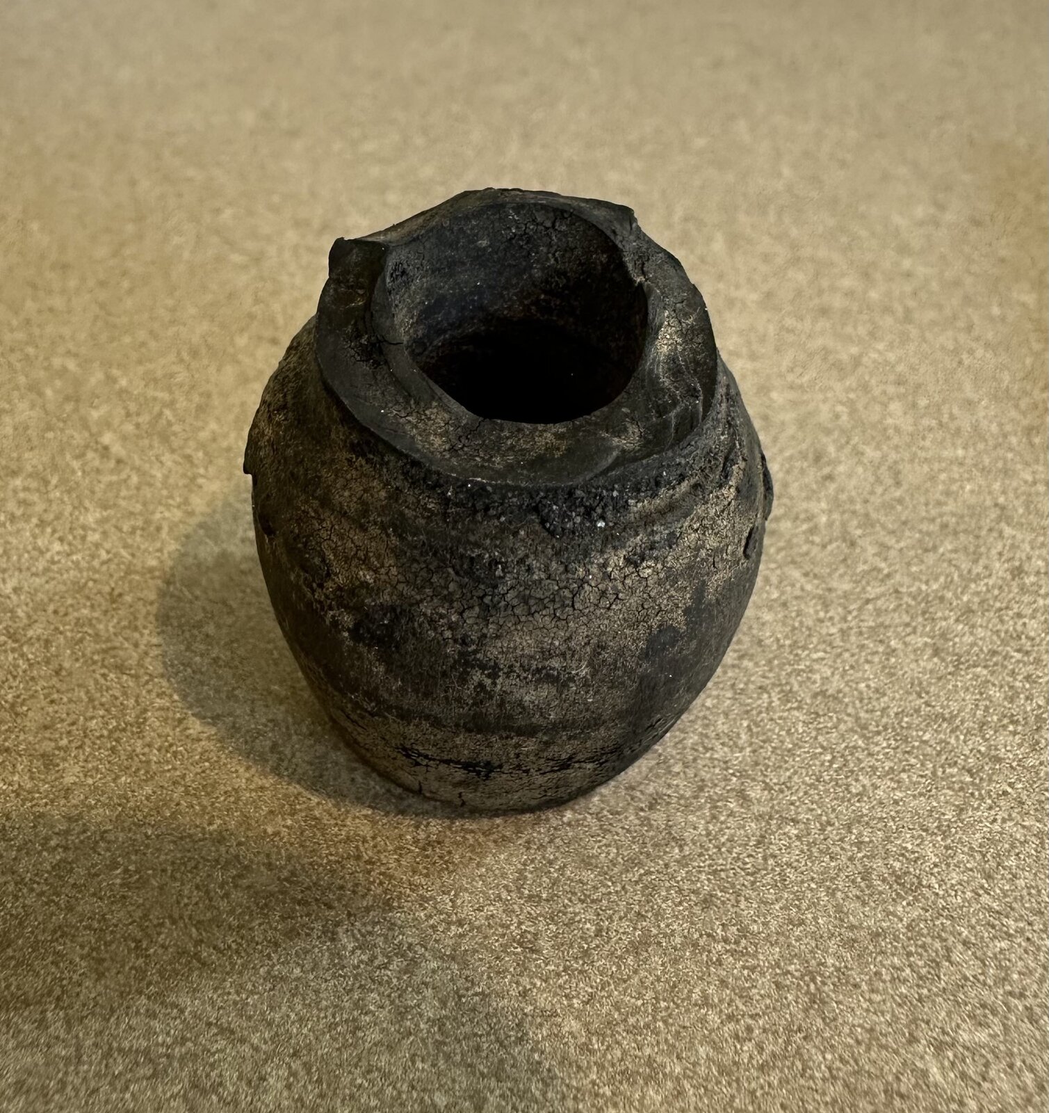

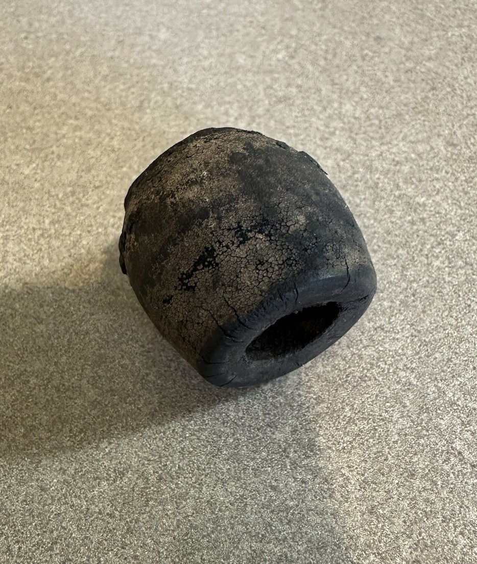

One more thing. Two of these dropped out of the spring perches when I removed the shocks. They are shot to pieces but I wondered where they may have come from. The old shock still had their washer and bushings. May these were part of that but no clues here.

About 1" at the widest point. Hole is 1/2". The Upper and Lower bump stops are intact and in remarkable condition.
These more or less fell out when the old shocks were removed. Found them on the floor after the fact.
