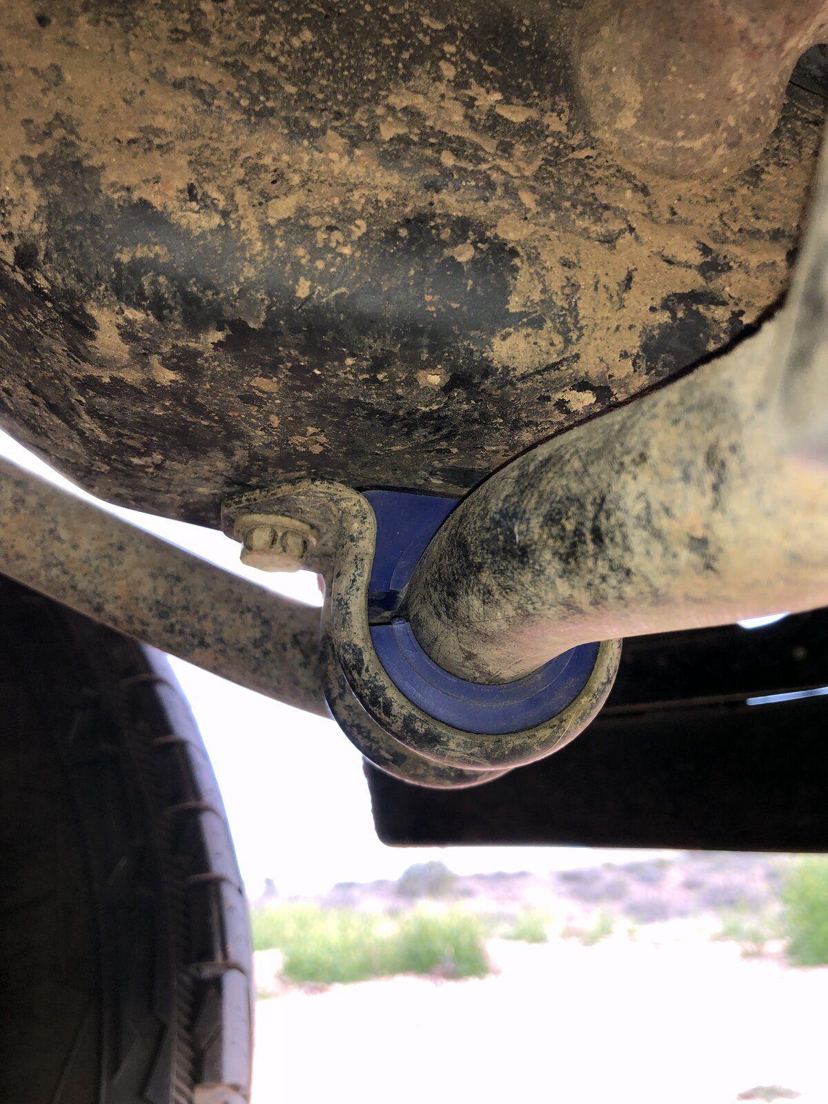

Went with whatever O’Reillys had. Measured in the parking lot with a digital caliper.
In the drive way now and there’s a gap. Is this correct? They’re obviously tight. No play unlike the originals that were on there, but should there be this gap?
Roughly 3/16”
It's not great but ok as it is on the side of the swaybar, the load goes up and down only.
I don't think you'll have a problem with that, but usually there isnt a gap.
Maybe it's because it's aftermarket stuff.
Word. The other side went on with a smaller gap. Maybe 1/16”.
