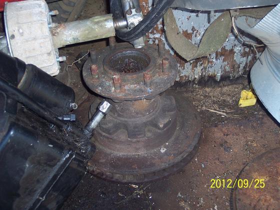

I have a Dana 60 front axle that was off a SRW W250 and I want to put it on my DRW D350, my truck has the 4000 lb. front end and i got a pair of 4000 lb. hubs for the Dana, but it has no splines in the hubs for a locker to go in only 8 large bolt holes around the where the locker should be. Dose any one know what kind of locker i need to get?
You are looking for a LOCKOUT HUB. The one you are describing is an external type used on the Dodge Dana 60's until 1990. Most use a Selectro brand hub, but I believe Superwinch makes one also.
Warn and MileMarker make them also, they are external mount. Make sure you get the right axle spline count.

If any one wants pics of my hub extentions let me know because i cant figure out how to post a pic on a post i didnt start

thats ok i got a pair of heavy ones so i have no need for another pair, I'll do some checking i might know some one who might want them, what are you looking to get out of them?
